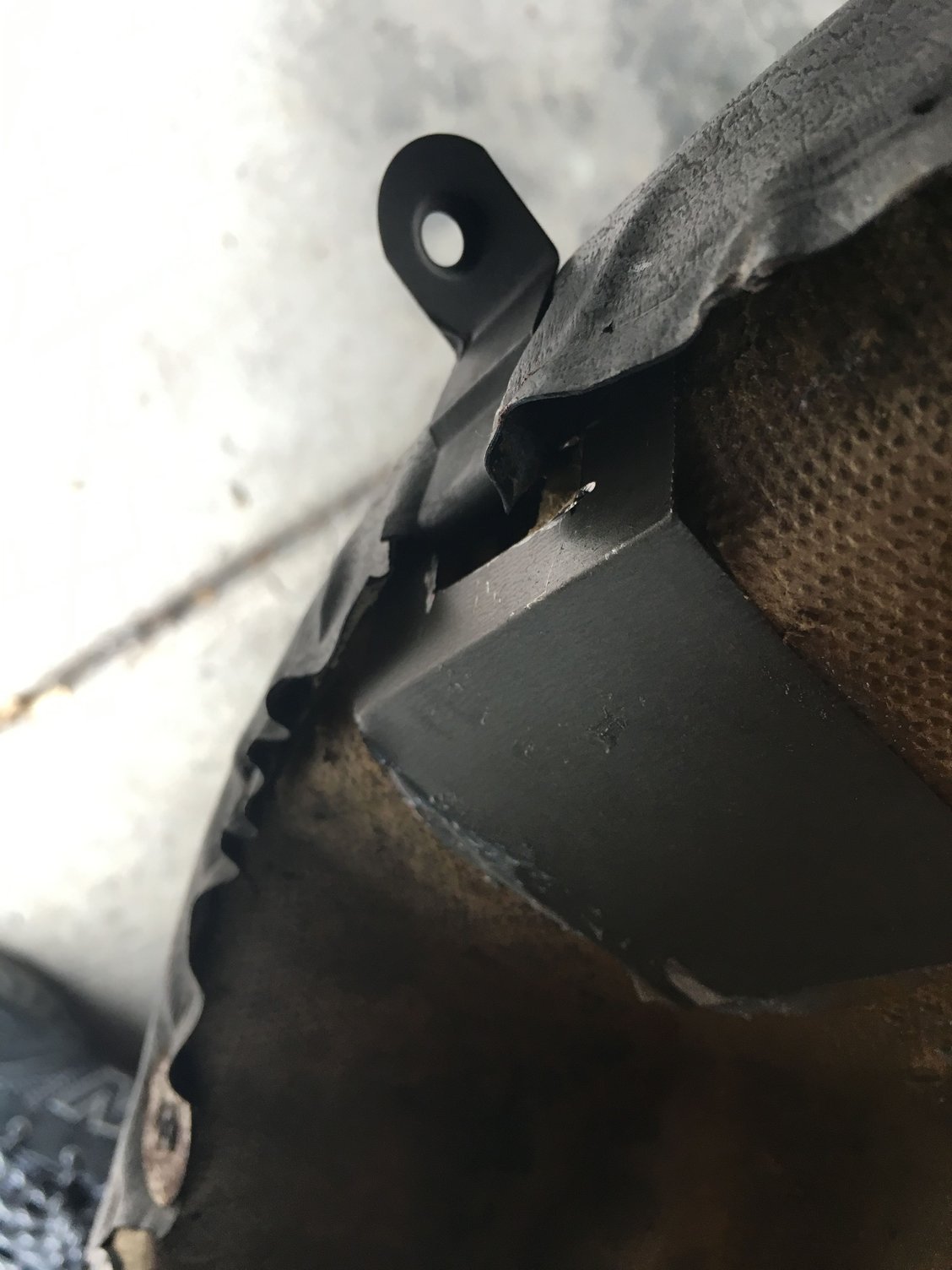

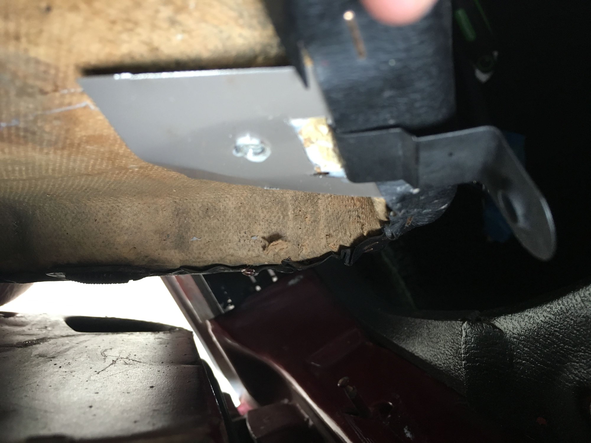

Not my finest work, but epoxy and aluminum seem to be holding. Here's an update:

Looks like it'll work great.
