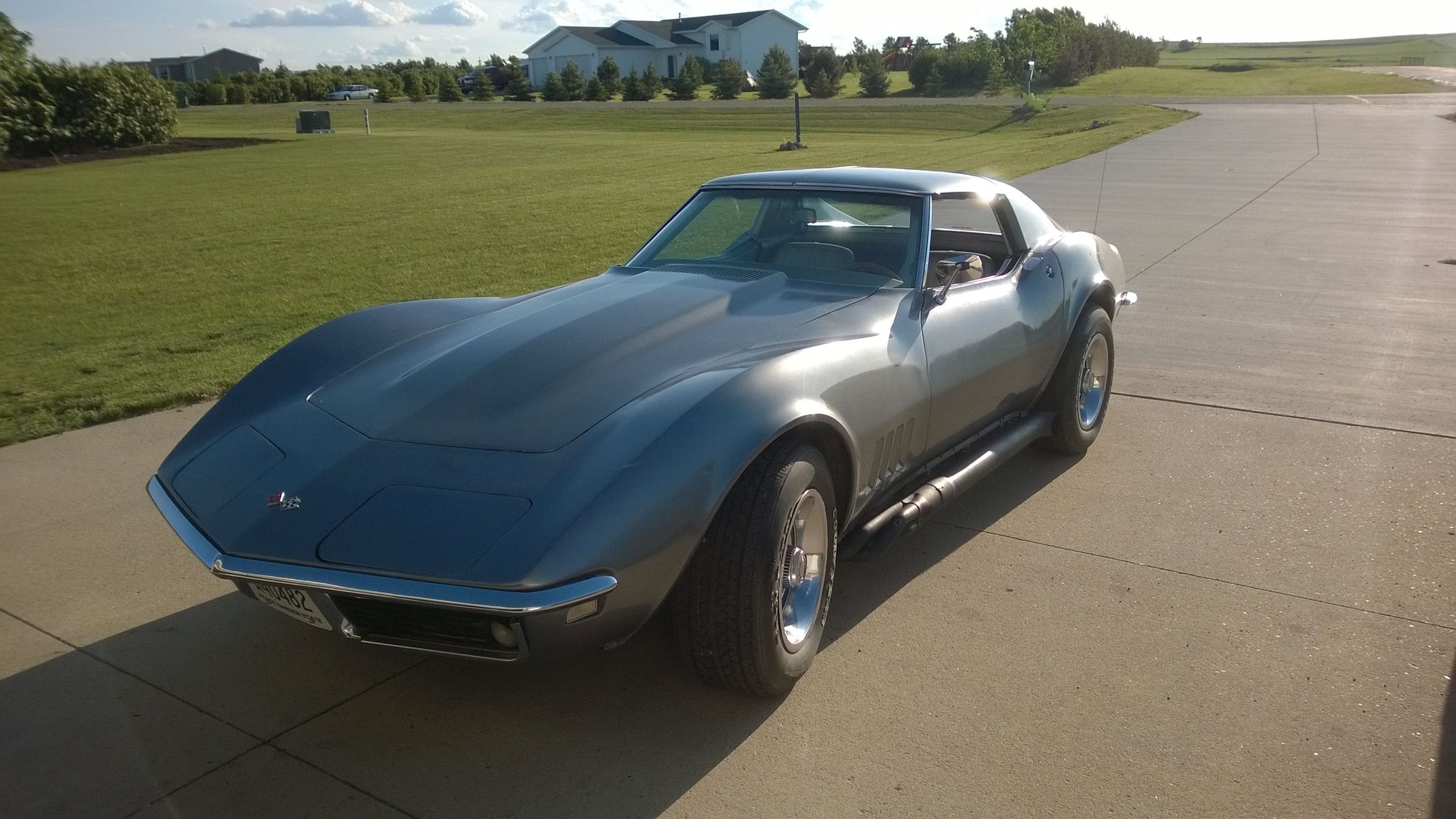

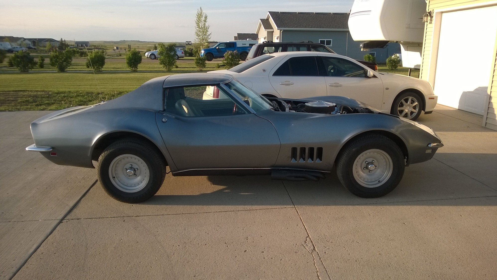

i have a long hood off a later model, not nearly as high of a rise as an l-88 hood but fits a 383 with a victor junior intake on it under the hood with about a quarter inch to spare.

its a factory hood off i believe a 73-75
actually i think that hood style was from 73-77. correct me somebody if im wrong
