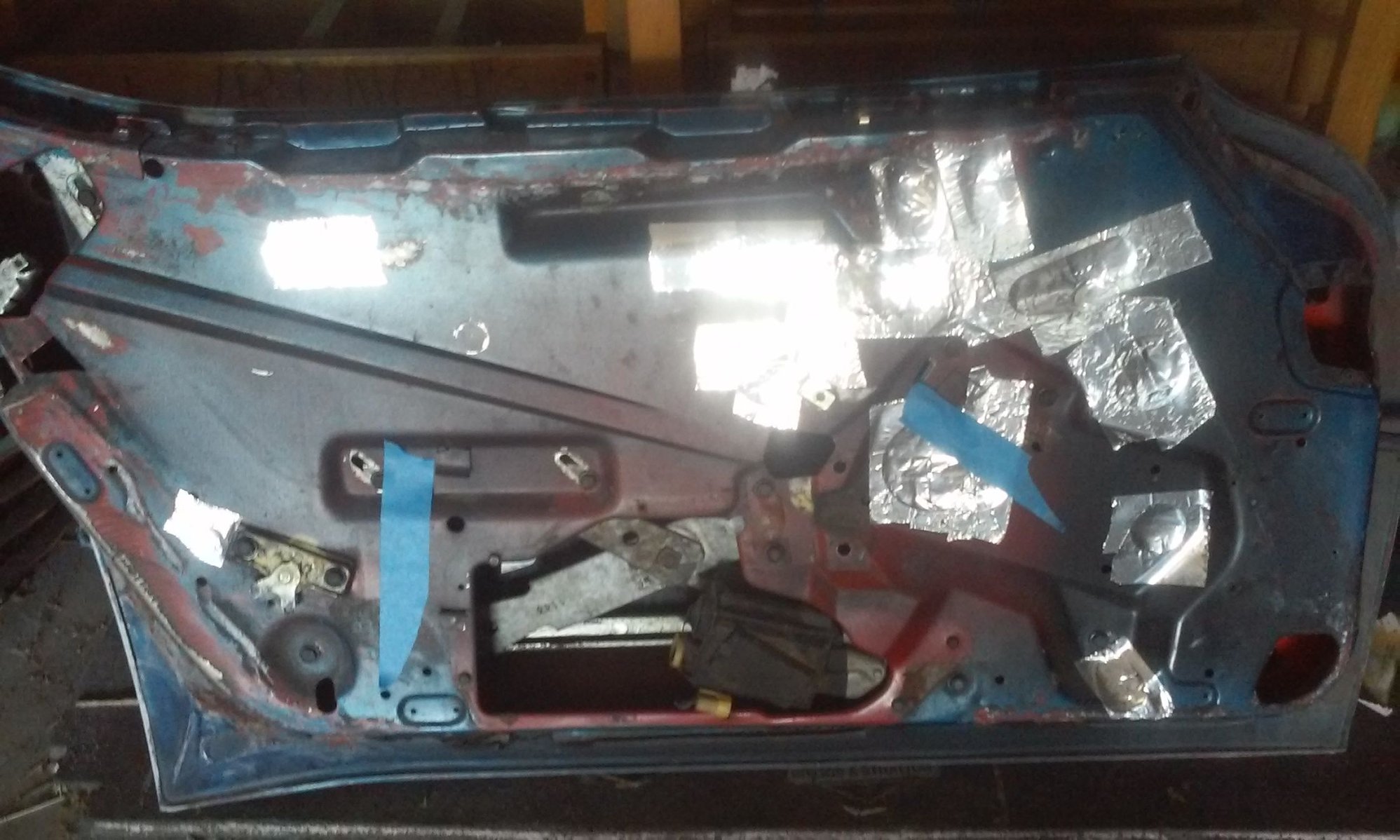

What did you do for door opening and lock function? Did you use your 76 door panel?
Every thing was transfered over from my 76.The blue tape shows where the brackets on the later door had to be removed for the 76 panel to fit
