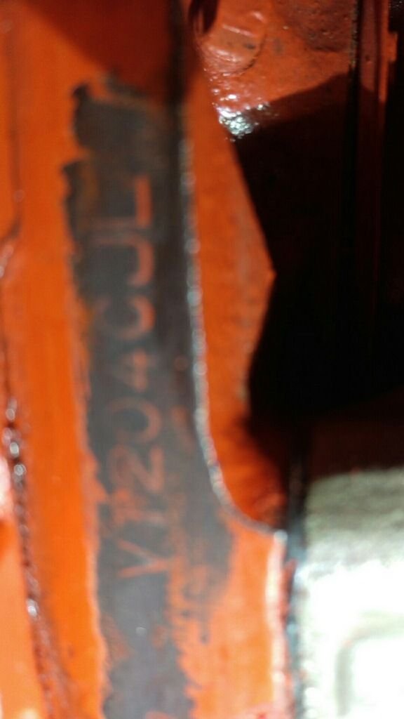

Need help on these vin from a 71 model, what ya'll think ?

negatives: blurry pic, paint on the pad
positives: old patina, broach marks on the pad, looks correct font and spacing, looks to be a good example of factory stamping. dates line up too. low probability of fraud on a base engine 71.

Both stamps look okay to me. Keep in mind the C11 in the VIN derivative is 71 only. Engine date and consecutive unit numbers are good for a December build car.
Thanks Mike, I learn something new everyday.

Hi VR,
To my eye looks quite similar to this mid-January pad.
Regards.
Alan
