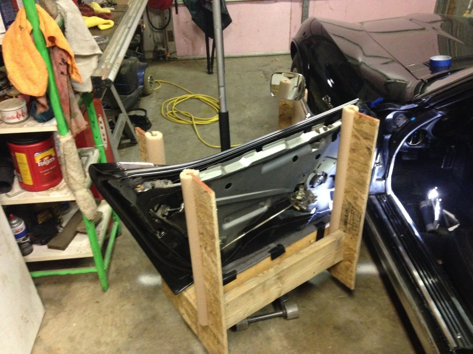

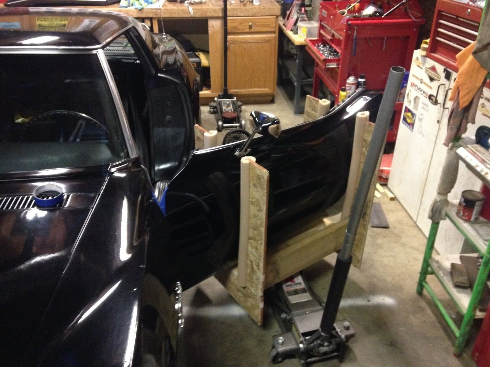

Spent the better part of Saturday building a door holder and then pulled the door off on July 4th....I did chip the paint even though I was very careful....Oh well after some touch up paint it will just blend in with the rest of the chips. The door lines up good and the glass doesn't hit anymore when shutting the door.

that's quite the door holder! I make my son hold it when I do things like that but he chips the paint too
did you replace the bushings in the hinge while you were at it?

Yep...Bushings too. I had to find a way to do it by myself.....The kid is in Florida for the next week. I didn't chip the paint taking the door off, I did it putting the new pin in....I had to grind the head down but I guess not quite enough.

Getting the retainer clip off the window crank handle was the most aggravating part for me....I enjoy carpentry work so building the door dolly was a breeze, it was also key to getting the door to re-align after the pins and bushings were replaced. Notice the 4X4 that the door is sitting on, don't pick the door up by the fiberglass skin. Let me know if you would like a drawing on the dolly....? Take some spray paint and paint the hinge/bolts head locations inside the door....Then just re-align them when putting the door back on. I had to grind one side of the head on the top hinge pin so it would slip by the fender and the same with the new one. Be careful with the pins, I clipped my paint.

An older thread but I just replaced my drivers side pins and bushings. I built a platform, nothing like the one above, I threw it away when I finished. I also used my Little Giant ladder to suspend the door from with ropes, just in case. The ladder worked perfectly, as it held the door upright and it rolled right back in with nearly zero adjustment at the hinge. What also helped was drilling the 1/8" hole through the hinge plate. I did not use the drill bits when replacing the door as pins. I could easily see the fresh hole in the hinge plate and it was very easy to align the hinge back to where it was using the drill hole.

As a second recommendation from above.....the Little Giant ladder was a game saver for suspending the door and not allowing it to tip over once moved away from the car.
