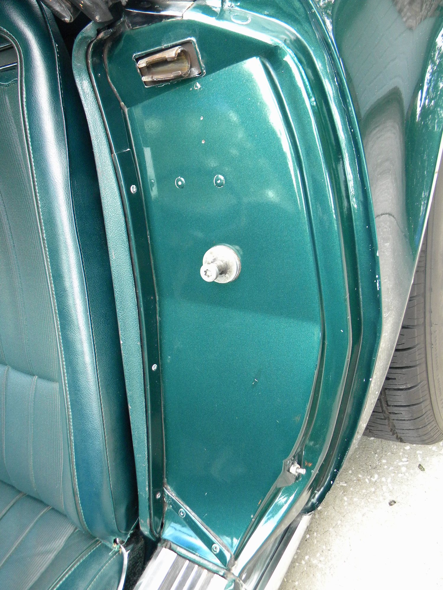

My '71 has original paint and I always keep the door jambs clean and waxed.
Here's a picture of mine for comparison:

The lock pillar as 71 Green shows was less 'ugly' than the hinge pillar.
Because of the fact that the hinge pillar is steel, fiberglass, and weatherstrip and was prone to leaking there is often lots of poorly applied sealer under the paint.
On some cars the area is pretty surprising!

Thanks Alan. This makes me feel better because the area where the trim tag is looks a lot like the one in the picture. The passenger side door jambs the paint looks "incomplete" for lack of a better word. The exterior paint is amazing though. I am now 90% sure the paint is (as the owner claims) original. I will post some pictures next week when I pick it up.
