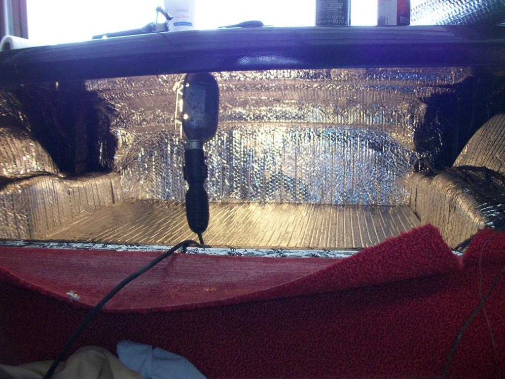

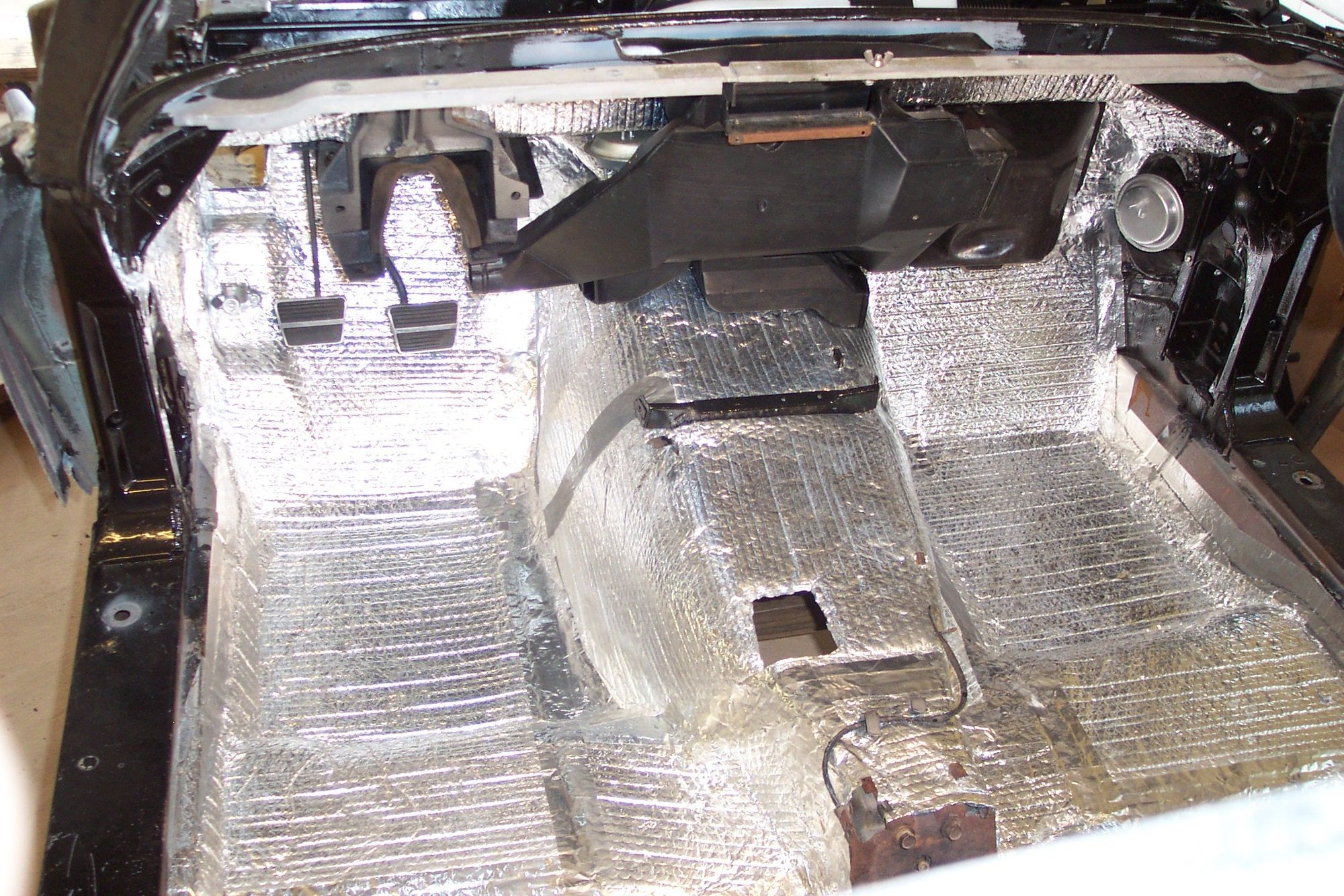

Thanks for your feedback guys. So over the weekend I decided to go ahead and purchase some Reflectix and began the process of installing it. Spent a few hours yesterday installing what I could before the wife gave me some honey-do's. Really wasn't so bad after all spraying the glue. The hardest part for (me at least) was trimming everything out. I did find out the hard way of spraying a big section at once and the Reflectix got stuck to it before I could get it in the correct position. What a bear to remove. Ended up having to cut out another piece for that spot. But learned my lesson on that. Might get an hour or two on it tonight if I'm lucky. Here's where I'm at so far...

Hi s29,
I don't know anything about dynamat but I must comment on the preparation you did on the underbody getting ready to install the sound deadening material!
NICE!
Regards,
Alan
Did you keep the old rubber/jute underlayment? What condition is it in?

Hi Alan! Good to hear from you. Thanks for the kind comments on the underbody prep. My OCD had me spending many, many hours scraping, scrubbing, and cleaning inside and out. Lots of work, but makes me feel better about it even though it will be all covered up by the Dynamat!
As for the old rubber/jute backing from the firewall, it was in pretty bad shape. Definitely something I wouldn't have re-used anyway. Its too bad, because the reproduction piece I ordered from one of the supporting vendors was very poorly made. Going to return it since the Reflectix will take its place...

Hey DG. Yes, plan on completing the floorboard and rear cargo area with the Dynamat followed by the Reflectix. Its a convertible, so shouldn't be too much trouble to get in there (unlike in a coupe) to install it all. Haven't given the doors much thought yet, but good call on insulating the door skins as well. Maybe the doors would be a good candidate to spray Lizard Skin inside them followed by Dynamat behind where the door panels would be?
