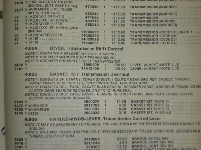

There ARE two different shifters in the GM parts manual. One for a WARNER transmission and one for a CHEVROLET transmission
GROUP 4.004 is what you are looking at.
DUB
