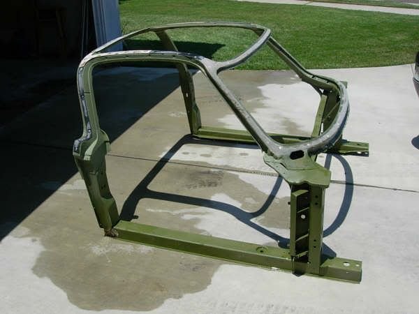

LOL.......I spent several hours looking up the meanings of slang Corvette terms so I would have an idea of what everyone was talking about (I knew a "horse-collar" should be at the front of the car....but WHERE ...LOL).....one birdcage example below (google pics of Vette birdcage).....

that's a c3 bird cage, it's the sub frame that makes up the cabin space. i'm a dodge ram owner so I know all about rust lol .they like to rust out around the windshield areas and bottom areas around the bottom rails. because these are unibody designs rust will collect in the most PITA ( pain in the a**) areas. I live in FL so there is salt along the beaches. to get a good look at the bird cage you can usually look through the windshield or look under the car around where the firewall sits.

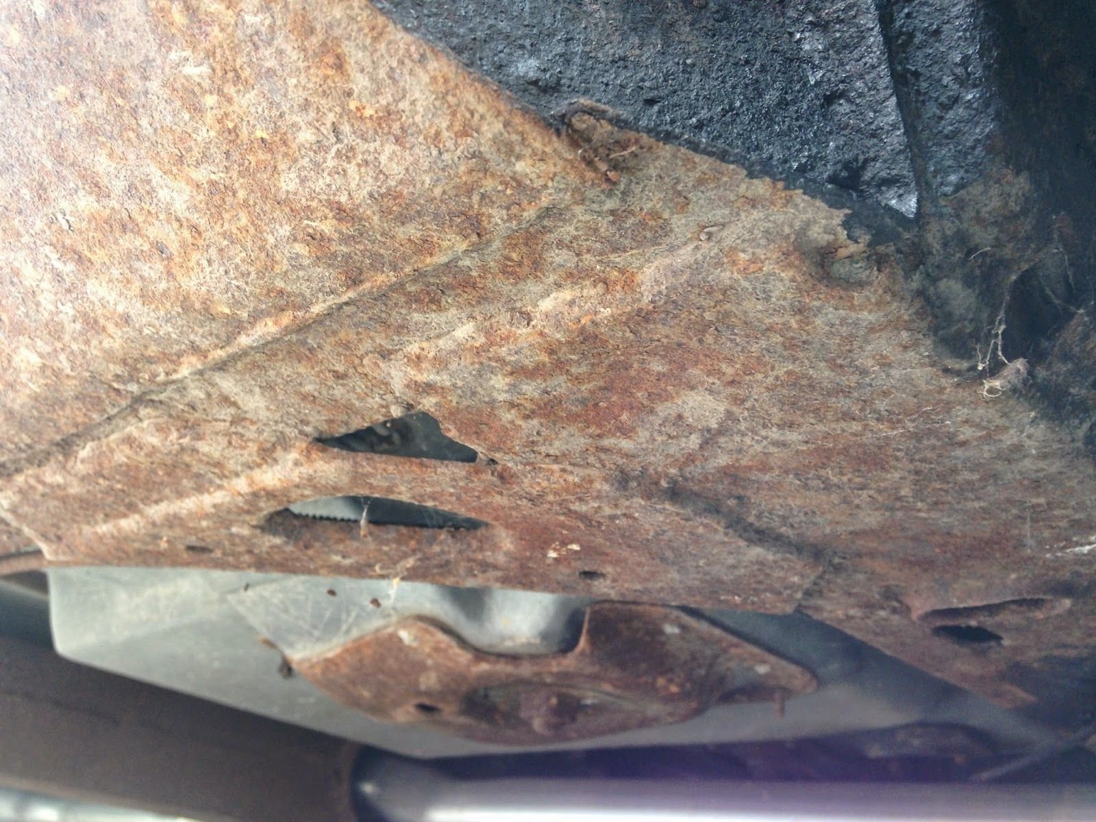

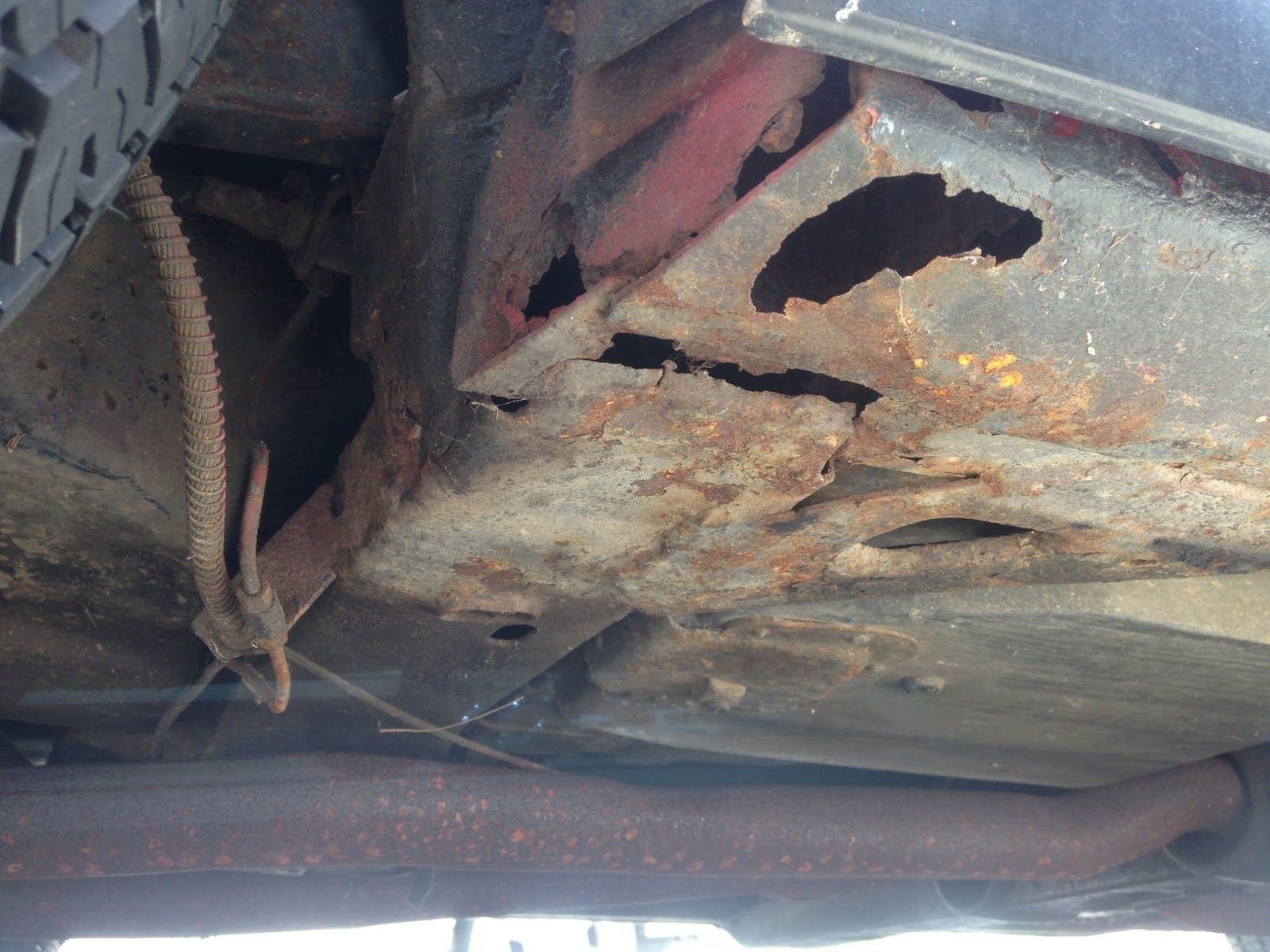

This pic is what you don't want to see.....Frame rusted all the way thru. The second photo (different car) shows what I considered too much surface rust, the entire frame and suspension looked like this.
Brian
