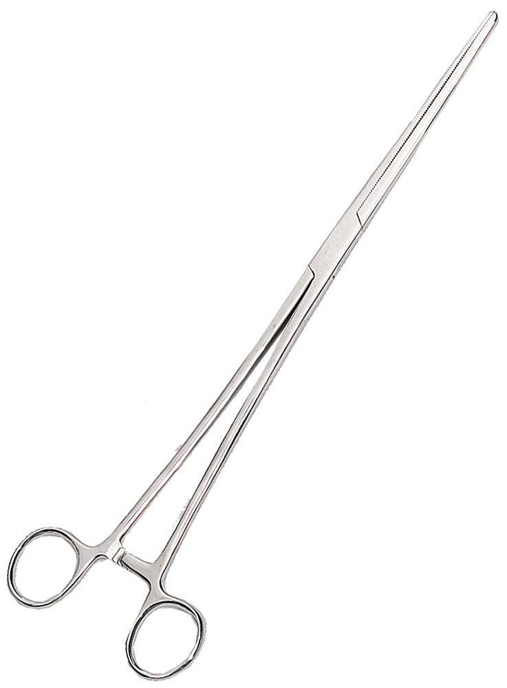

I love my C3. I drive it almost every day. But lately stuff has been breaking faster than I can keep up. First my power antenna stopped working. Then the rear window defroster stopped working. Not that I need it right now. And now my radio has stopped working. It seems that as soon as I fix something another problem arises.
Hopefully these are fuse/circuit breaker issues. It's not very easy to even get to the fuse box on my '81. I usually take the seat out to get under the dash. I've even invested in a 12" and 16" hemostat to reach the little devils. These are a great help in reaching into the fuse box. I highly recommend that you guys try them.
Anyway just needed to rant some. Thanks for listening.

Fuse/circuit breaker issues are generally just the reporters of bad news elsewhere in the system. The hemostat is a good solution for the tight confines we have to work in.

It's a really good idea to disconnect the battery before using a metal surgical clamp to remove fuses....
