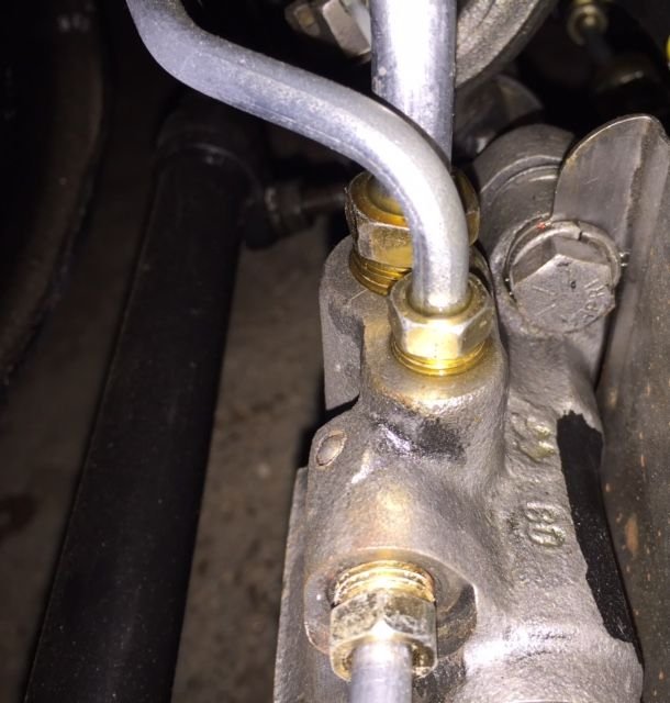

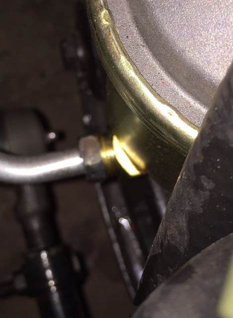

I was finally able to fire up the engine yesterday. I had to cobble up some plug wires and it looked a mess, but ran really well. More on that in another post....maybe.
Anyhow, I had two leaks. One at the fuel pump, and one on the power steering.
On the fuel pump, it was the supply line to the carb. If feels as if the threads are bottomed out. Any more force and it will wring the fitting. Is the any kind of thread sealer for fuel? The thread's are not crossed, as I backed it out and re- seated the line. Still had the seep.
And similar situation on the power steering. The larger fitting seeped pretty good.

Both of those components use flared fittings which seal at the joint of the seat(inside the fitting) and the tubing flare. Putting teflon tape/sealant on the threads will not do anything, if the fitting seals properly. If it doesn't seal properly, remove and check for small debris on the seating joint surfaces. These surfaces are supposed to slightly deform to create a sealed joint. Cleanliness is a MUST when these things go together.
Inspect the seating surfaces (both parts) BEFORE assembling them. Better to clean, blend, smooth whatever needs it before re-shaping them under torque loading.
