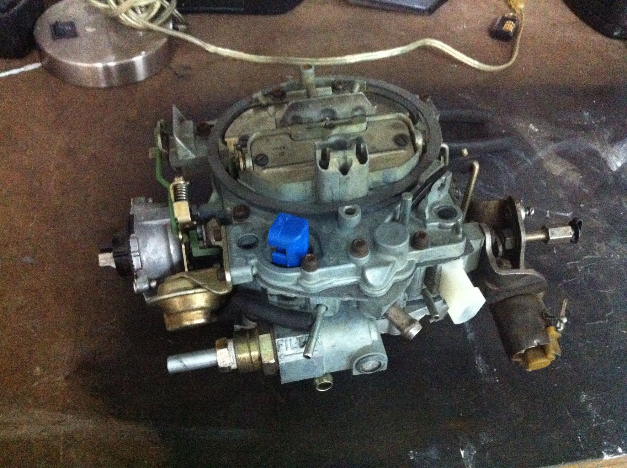

A pic of the carb with the air cleaner off would help, as would a pic of the distributor wire.

here is a picture of the carb off an L81 engine

Larry's carb pic shows the electrical connection points that I wanted to see on yours. There should be a wire attached to the choke, blue plastic (metering rods), white (TPS) and idle solenoid on the right.
Incidentally, don't feel bad if your carb doesn't look as nice as Larry's, none of them do. I think that one looks cleaner than they did coming from the factory
