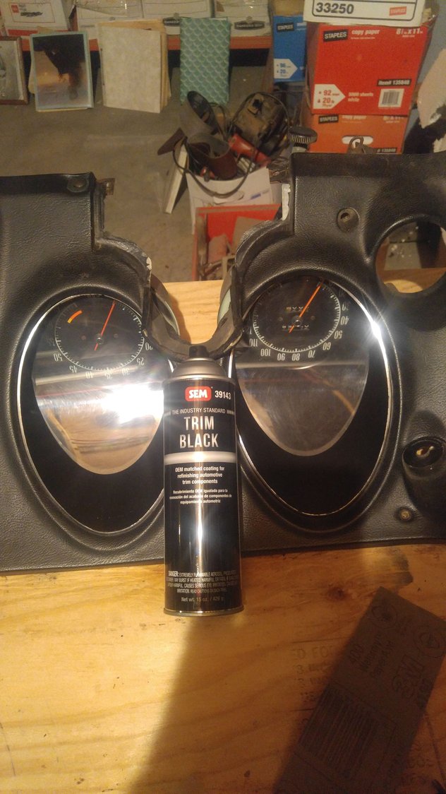

I found this to be the best for interior
Wes

If you are recoloring plastic interior parts that can flex, you do not want to use 'paint'. You want to use a 'dye' which is paint with an elastomer added so the paint can flex. SEM makes interior dye. SEM also makes Trim Paint...which is not dye. If you are recoloring 'hard' parts (metal/plastic which do not flex), Trim Paint is a good choice [as is Krylon semi-flat or John Deere 'Blitz' black (satin)]. You can also recolor hard parts with dye; but it won't be quite as durable as paint.
