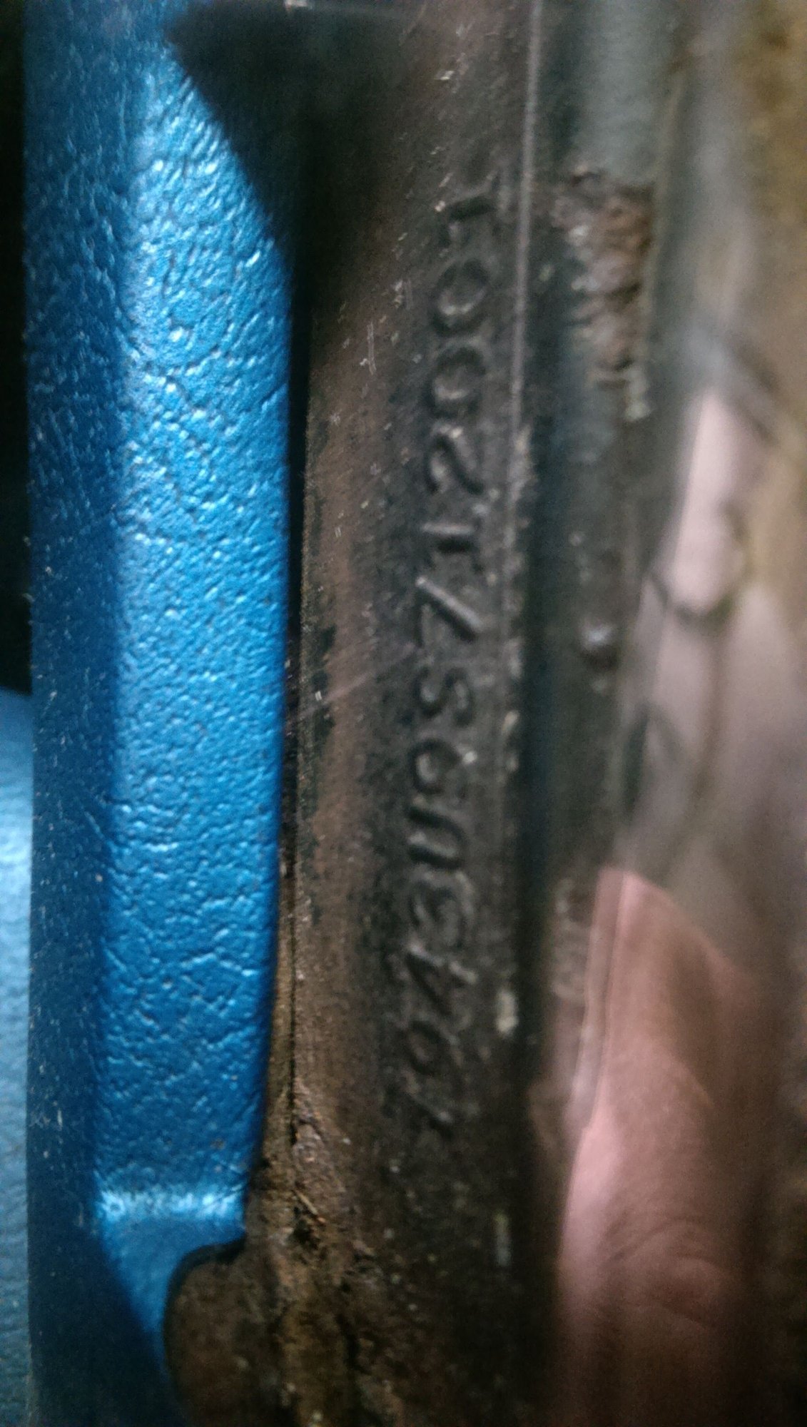

1943U9S712001
And anywhere I look on line it doesn't make sense.

Looks like the 5th digit U is supposed to be a 7.
Whats the actual vin tag on the car read ?

Take a clear picture of the vin tag for us.
That is the vin number that is what is weird .

Old Oct 12, 2016 | 07:51 PM

1st Digit is the Division: 1 = Chevrolet
2nd and 3rd digit is the Series: 94 = Corvette
4th and 5th Digit is the Body Style: 37 = 2 door Coupe -- 67 = 2 Door Convertible
6th Digit is the Model Year: 9 = 1969
7th Digit is Assembly Plant: S = St. Louis, MO
Last 6 Digits are Production numbers starting with 700001 to 738762
Looks like U to me which doesn't match.

The chassis number is only a partial and will not help him. Same with engine and trans numbers assuming they are even original.
I am afraid this car will be a problem to register with a proper 69 Corvette VIN. I have never seen anything like this where the VIN tag "looks" original but does not conform to the standard format.
That U should not be there. It should have been a 7.
Best of luck.
