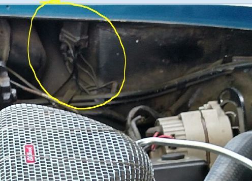

The module that I believe to be the external VR, could very well be something else. I don't recall that there are leads going directly from the Alt to this module, as the wires are all coming in/out of the surrounding wire harness bundles. I don't have a picture of it handy, but will look further over the weekend.
EDIT - I found a picture that captures the suspected VR module. What is this puppy?
Also - I plan on replacing the wires with HEI-friendly 8+mm Moroso's, but curious about the spark plugs, and what type I should be upgrading to, since I'm bringing the entire ignition system into the 1970s (at least!).

The item circled is the horn relay. '69 was the first year of the internal regulator alternator on the Corvette.
