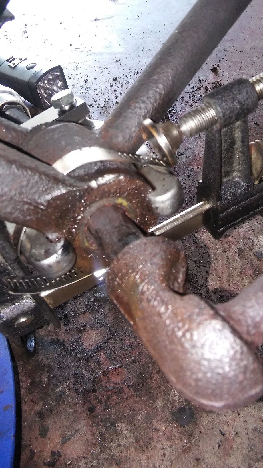

-----3. If you've never had to take off your halfshafts or drive shaft, you'll find a lovely suprise:
I'm sure there's a reason they used these to hold on the u-joints, but as far as I'm concerned that reason was to **** me the f*** off. Long story short, there are spline sockets and 12 point sockets... these need a 1/4” 12 point socket. Do not buy spline sockets; you'll just endup returning them.
Note the box says they work on 12 point... THEY F*** DON'T! Also can someone explain to me what a spline socket is used for then?

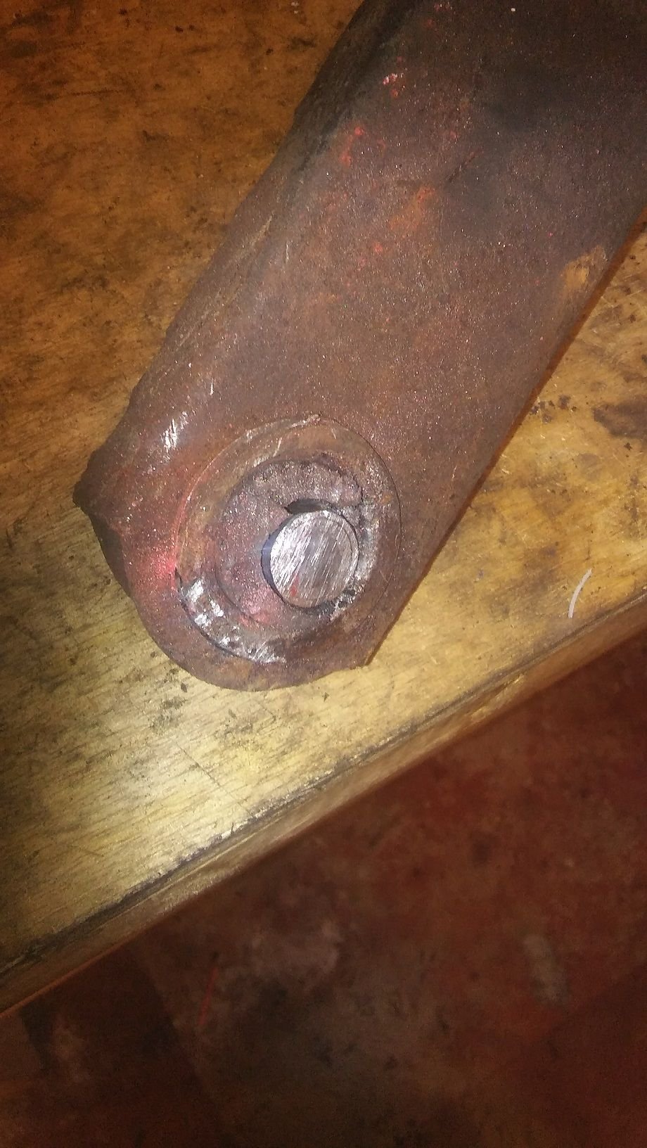

-----4. Depending on your approach, you'll probably need to remove the shocks and the mount. I was 50% lucky. Driver side shock mount came out easy. Passenger side... no way. Applied tons of heat and hammering and it did jack all. In the end this is what I had to do:
Unfortunently I didn't take a picture before it broke free nor did I take a pic of the other side. Here's the gist of it: you'll need a wheel puller, angle grinder, c clamp (or a shitty clamp used for wood work like I got), pb blaster, and clamp ring. Rig it up similarly to the pic. What you don't see on the other side is I put a divot in the other threaded side (take the nut off, grind it off if you have to) so that the wheel puller has something to seat into and doesn't slip off or work at an angle. The c clamp and clamp ring are both critical; those hooks will slip off after enough force is applied.
Now, I tried a couple times quick and dirty and it didn't work. So I said “F*** IT, I'LL BE A MONKEY'S *** IF I DON'T GET THIS THING THE F*** OFF!!” And I did something unusual for someone inexperienced like me... I applied less force, and more patience. Sunday I set it up like this and applied liberal amounts of pb blaster. Tightened the wheel puller until I couldn't anymore without the use of my handy-dandy table leg... and I walked away. Next day more pb blaster, a couple turns with the table leg and walked away. Same the following day and the next few days after that until Saturday. At this point it still wasn't out, but it had built up a lot of tension. A few more turns and sure enough she broke free.
-----5. The shock mount doesn't rotate. Kind of “no s***” but I applied ungodly amounts of torque to that thing before this coming to this obvious realization
