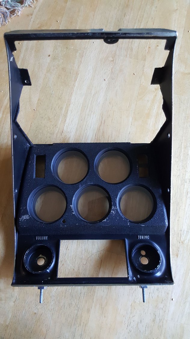

All - Making progress. Thank you Willcox, fuel gauge is now fixed. I have the console removed (see pic) and would like to touch up the pain. Any thoughts on how to do this and what paint to use? this is the original Metal Console.

Yes... strip the paint off of it, and the use an acid etching primer. Once it's dry then coat it with a color coat of semi-gloss black. I think the part number is 7777 krylon.
When it's dry take a razor blade and trim off the chrome edges including the letters at the radio.
Willcox

This may sound dumb....do I need strip and acid etch? Could I clean with mineral spirits or alcohol and paint?

I'd use paint stripper and some number 3 grade steel wool to get it clean, then wash with some good soap and water. Once dry put a coat of acid etching primer on it, then your color coat.
