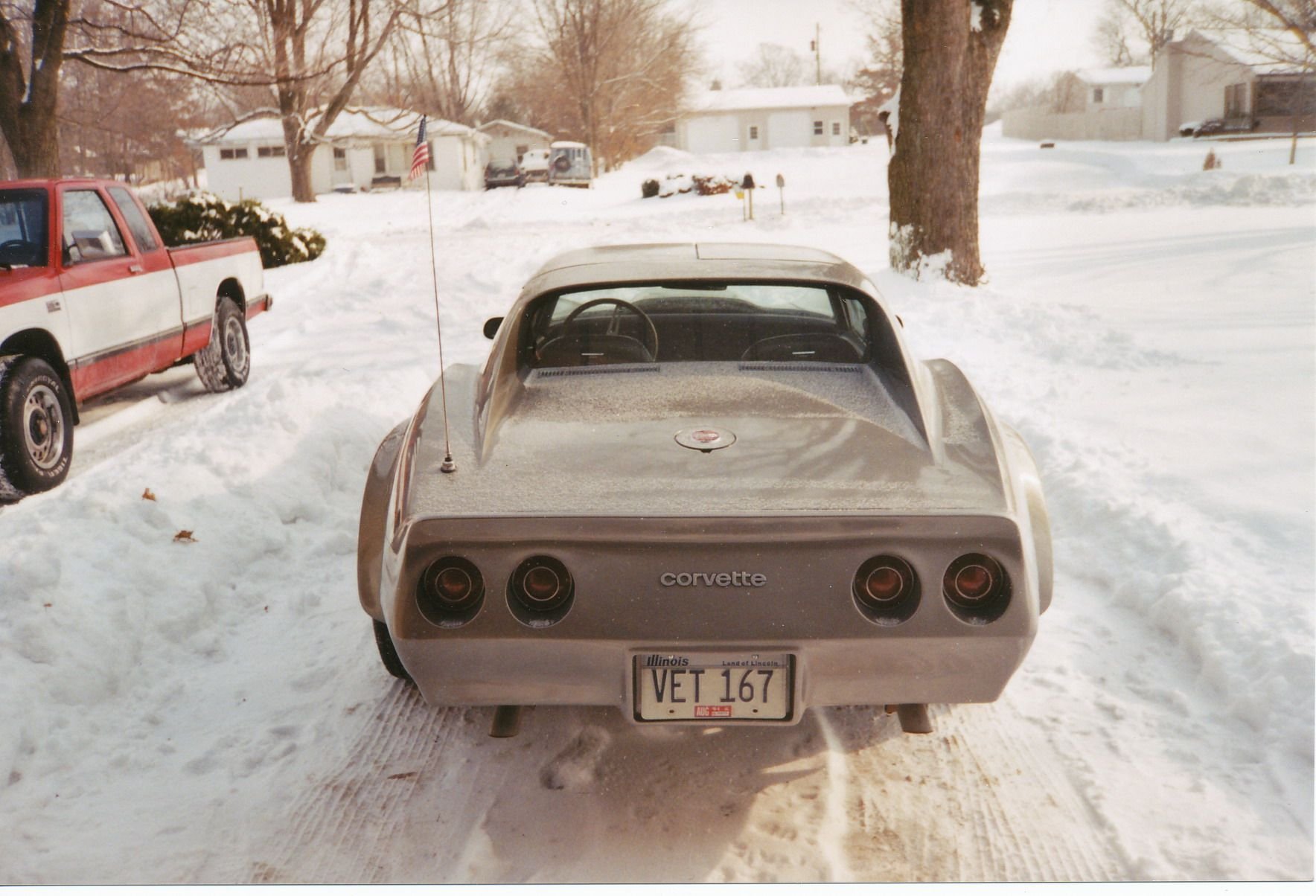

I drive my C3 in the winter quite often.
Back in the 70's the C3 I had then was my only car. I had 4 studded snow tires on it and drove it to work every day. The heater is pretty good and they actually have pretty decent traction unlike a C6 or C7..... They are really a lot of fun in the snow.

Great pics..nice car! the older ones do well..no having to deal with 500+ HP..No matter how good the brakes are..IF a car won't stay sunny side up..in rough weather.not good!Hope your winter up there is not too rough..Jim
