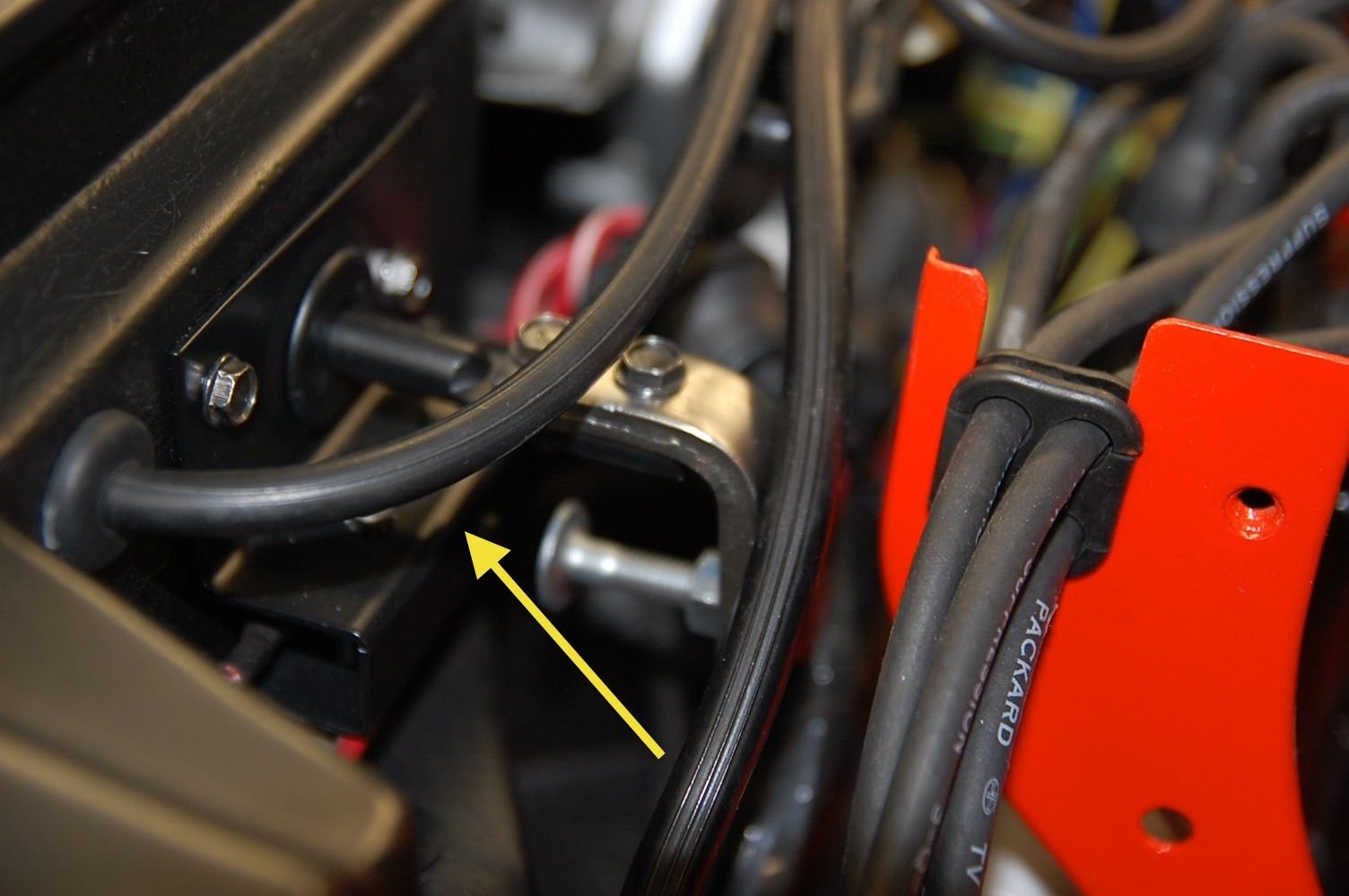

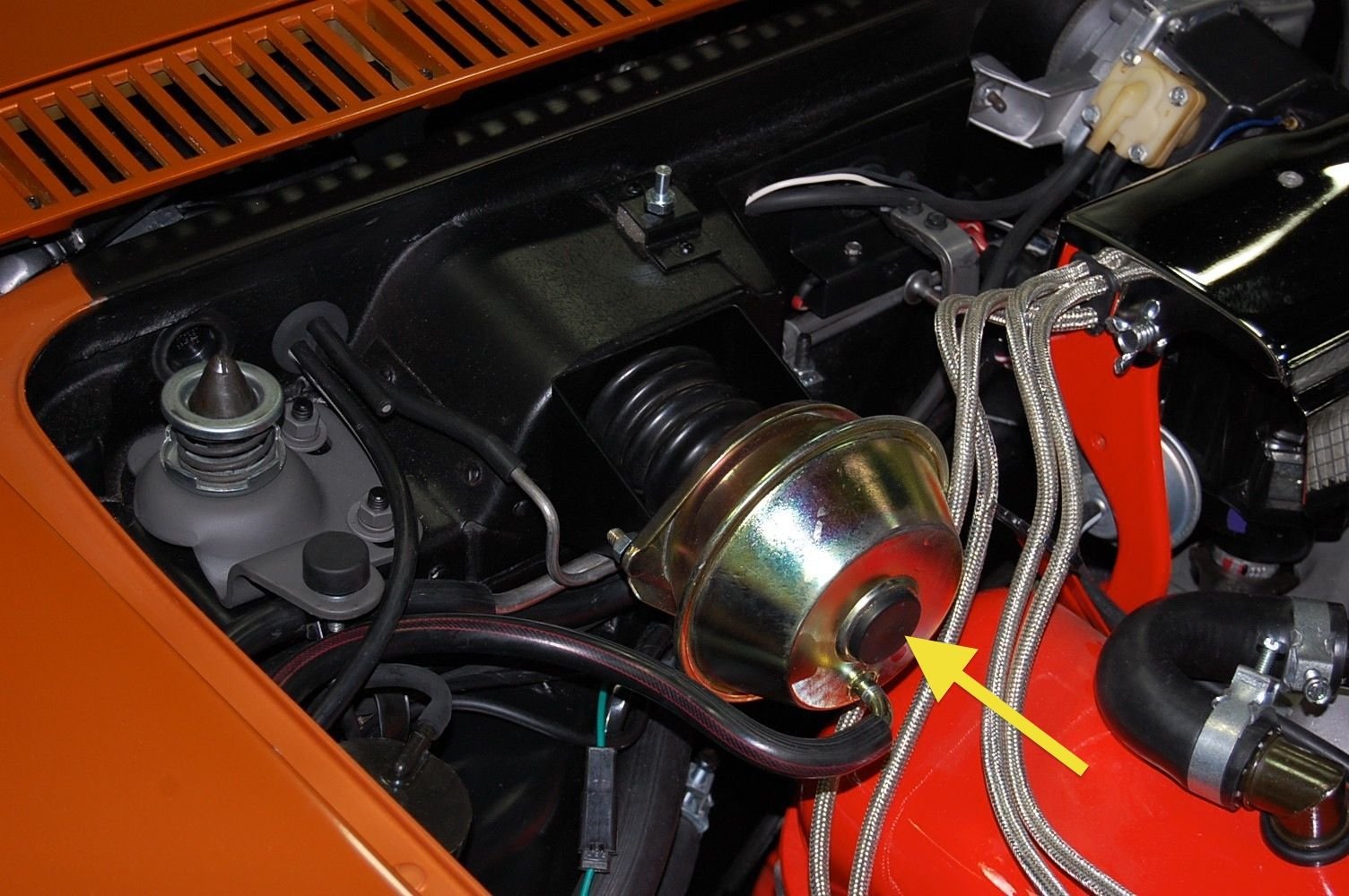

Hi Rich,
The 'coffee can' must have the rubber plug in it's end for the actuator to function properly. (I believe it can open the door but not close it with the plug missing.
When the wiper door opens fully the 'plunger' on the door linkage at the safety switch should depress the button switch and send power to the wiper motor.
Is that happening when you manually open the door?
Regards,
Alan
This is the later style actuator but has the plug I was referring to.

Originally Posted by Alan 71
Hi Rich,
Regards,
Alan
No it isn't, my door is not opening all the way and the linkage on the safty switch is no where near depressing the button.
