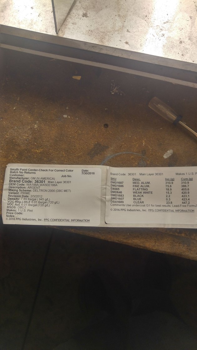

I came up with this formula with the help of PPG historians
Wes
Add a very small amount of this to get green tint
I used and original 68 spare tire and wheel to come up with correct match

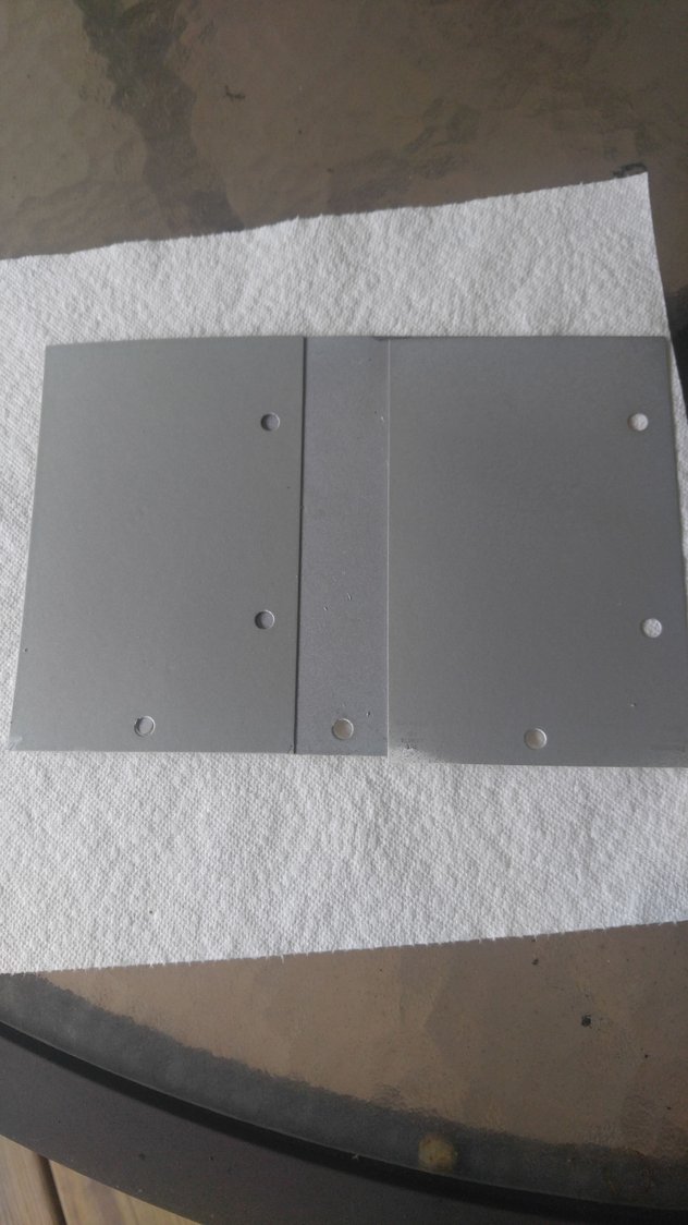

All are argent silver
As you see very little is visable when done and original wheels had some runs in paint
Wes
Wes
You're a legend Wes.
​​​​​​​Cheers
