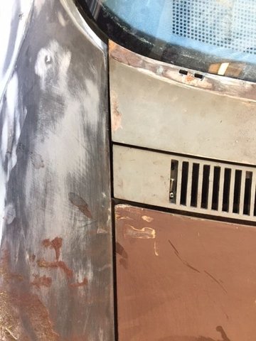

I'm about to decide going from a long hood to wiper door on my '68 is way more work than it's worth... Here's what I've got, now. There isn't room for it. I can get the gap good on one side, but then the other side is way off. If I center it up, then both sides are too tight to fit the trim and screws.
Driver's side:
Passenger's side:
It was worse than this when I started. I unbonded both rear corners of the front clip and used a big spreader to push them out a bit, then re-glued. I was hoping that would do the trick, but I still need more. Ideas?

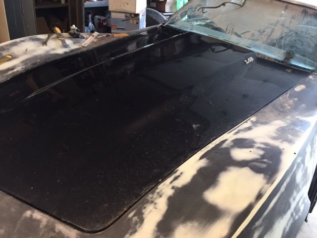

Alan,
As usual, thanks for the great pics. I should have put the hood on for the first pictures. I put it on and took new ones. To answer your questions:
1. the hood fit is decent. It's a little tight at the front, but nothing I can't fix.
2. Yes, I replaced the front clip with a used aftermarket one. I have a couple other fitment issues (the main one being that there is no way the front grill brackets are going to fit without cutting and re-welding).
3. No, the door isn't original to the car. It's a '69+ with the screws at the ends (though one hole is messed up).
I don't think I can spread it any farther than I already have. I cracked the place where the rear cross-piece meets the inside rail on both sides the first time by going as far as I dared. It also messed up my door gaps, which I have many hours in getting perfect. Now the clip's rear "points" stick out farther than the doors (which will be loads of fun to fix...). So, un-bonding the whole thing again isn't an attractive option.
I agree with oldgto that the wiper door portion is just too long. The gap is nice and even along the hood and grille, but the door part just looks too long. But I don't think there's enough meat to mill the edge down enough.
Crazy idea: what if I cut the fiberglass along the line in the last pic and angle it slightly to more closely match the door? Just spitballing...

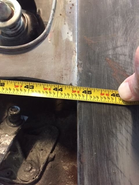

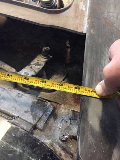

Here are some dimensions for you to consider.
What are your numbers like?
I'll be very interested in hearing what DUB'S thoughts on the situation are!!!!
Regards,
Alan
Forward.
As far back as I can measure because the tape begins to hit the center of windshield.

Alan,
Looks like mine is a little tight. Grrrr...
Also, a little dirty.

Hi EM,
It looks like the dimensions indicate the opening in the hood surround is too narrow and the gaps to the grill and door demonstrate that.
Since it seems DUB hasn't seen your thread I'd send him a PM and ask him to please take a look so he can offer you some suggestions!
The operating wiper door is worth the effort.

It's definitely worth it. I have a long hood, too, and put it on this weekend just to see what it looked like. Nope. Short is the way to go. I'm going to the effort to go back to the correct '68 back-up lights (not to mention the whole front clip) so it would be a shame to skimp out on the wiper door.
As a side note, the long hood's gap seemed ok, but that doesn't mean a whole lot since the only place I have a problem is the rearmost few inches, where the long hood was flared enough that the issue couldn't be seen.
