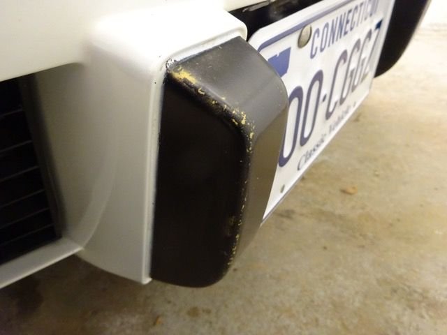

This is before, original paint:

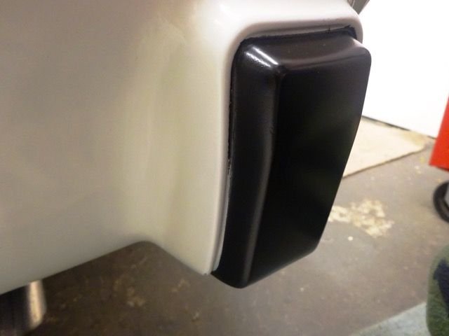

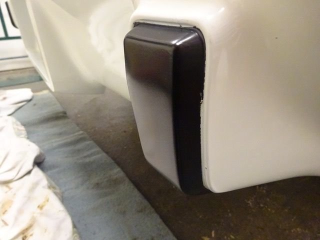

This is after, satin black. Pretty similar:
The uneven painted edges are as it came from the factory. I kept that look to maintain originality. That's my story and I'm sticking to it!

That looks really nice. I think you nailed the sheen.

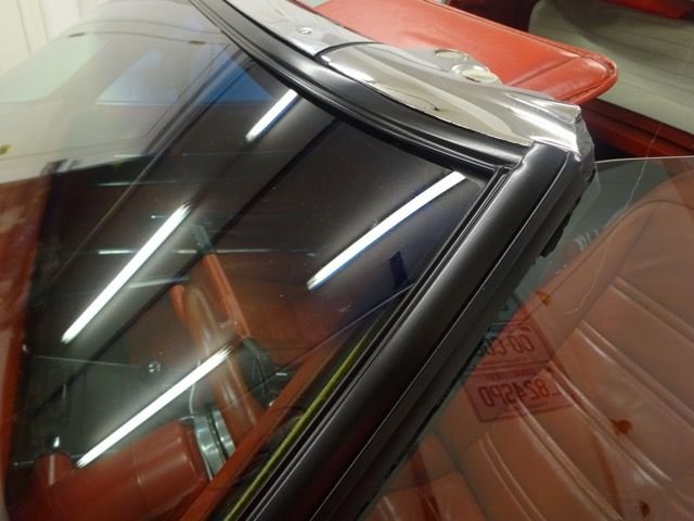

Got the windshield trim painted. Used the VHT satin Bumper and Trim paint. I'm happy with how it came out.

All looks good! Nice job on the window trim.
