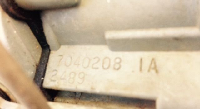

How do I tell if this carb is original?

Original to what? It appears to be a 1969 dated carb for a 1970 GM product with an automatic transmission if that helps.

My vette is a 1968, so can I assume this was not original? The engine matches the VIN, but did not know how to decipher the numbers on the carb.

Hi c1n,
It appears your 68 427/390 4-speed engine would of originally had a
Q-Jet with the part number 7028209 FG stamped on it.
I'd say the Julian date on the carburetor in your photo is the 248 day of 1969.

2489 is a Julian date.

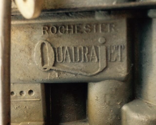

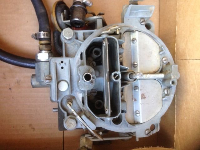

The carb shown in the photos is a commercially rebuilt carb pieced together from several other carbs. It is not an original carb in any way, other than having a 1970 350 truck float bowl. It has a 1969 airhorn and 1968 SB choke linkage. It's a mess. I can post photos of a real '68 BB carb if you'd like to see what it should look like - they are quite rare, which is why people put junk like this on Vettes. E-mail me for my "Commercially Rebuilt Carb Problems" paper to gain an understanding of what you have.

Notice the secondary airvalve rod correctly installed. The rod is missing on the OP's carb. The brass inlet fitting on this carb is not "correct": The correct fitting is steel:
