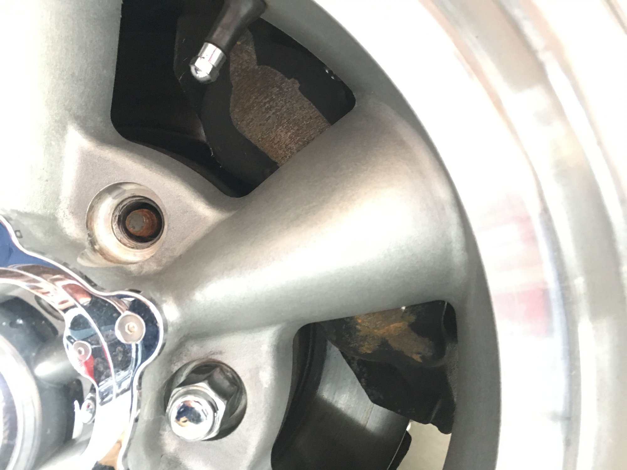

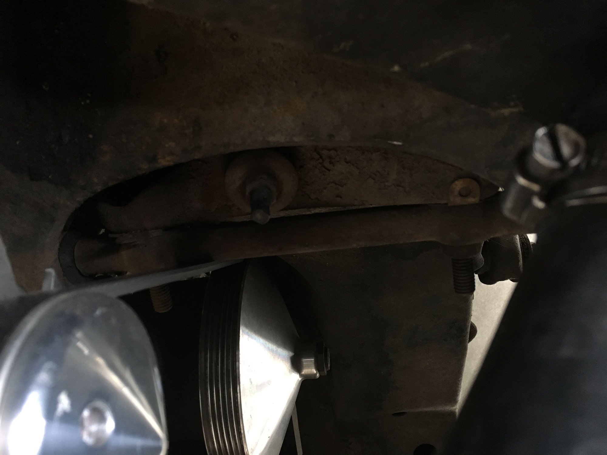

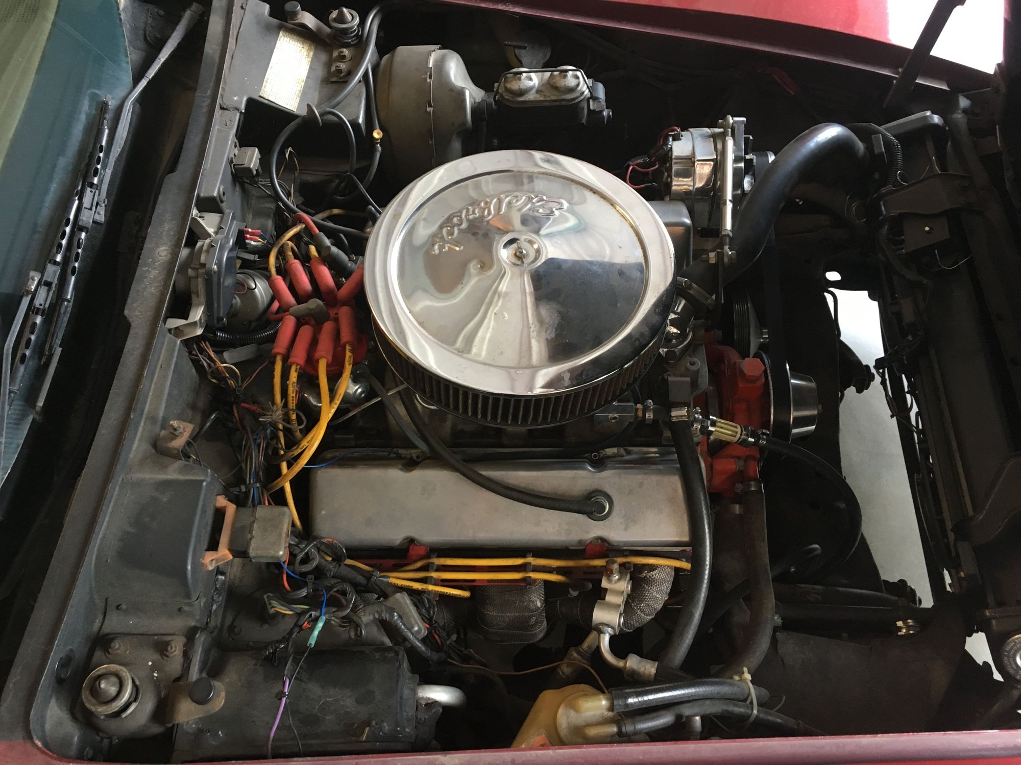

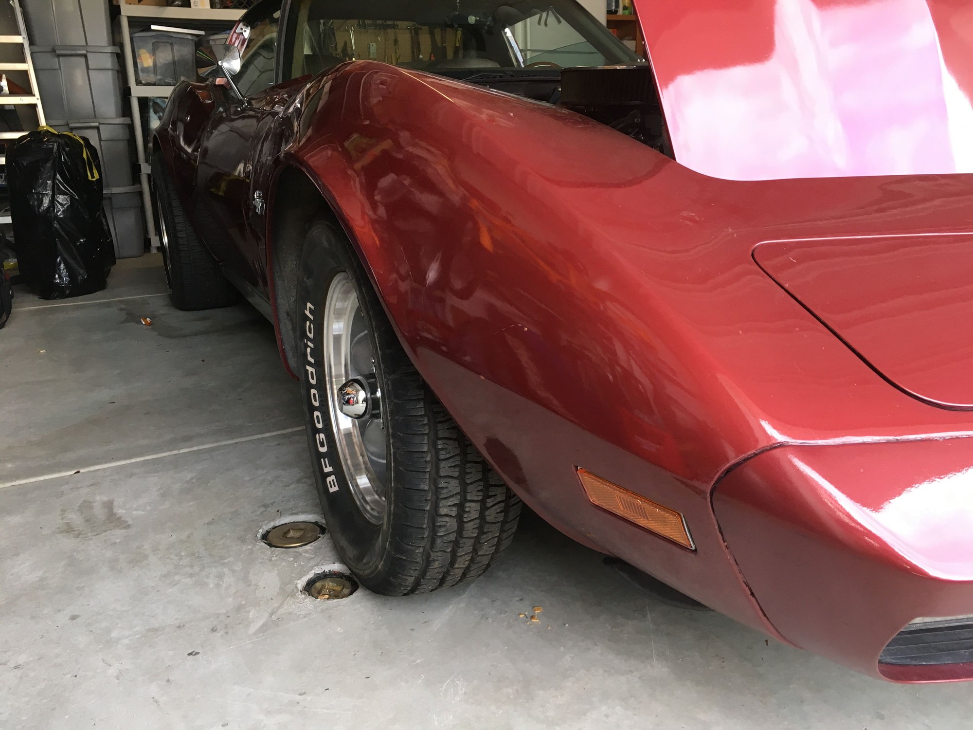

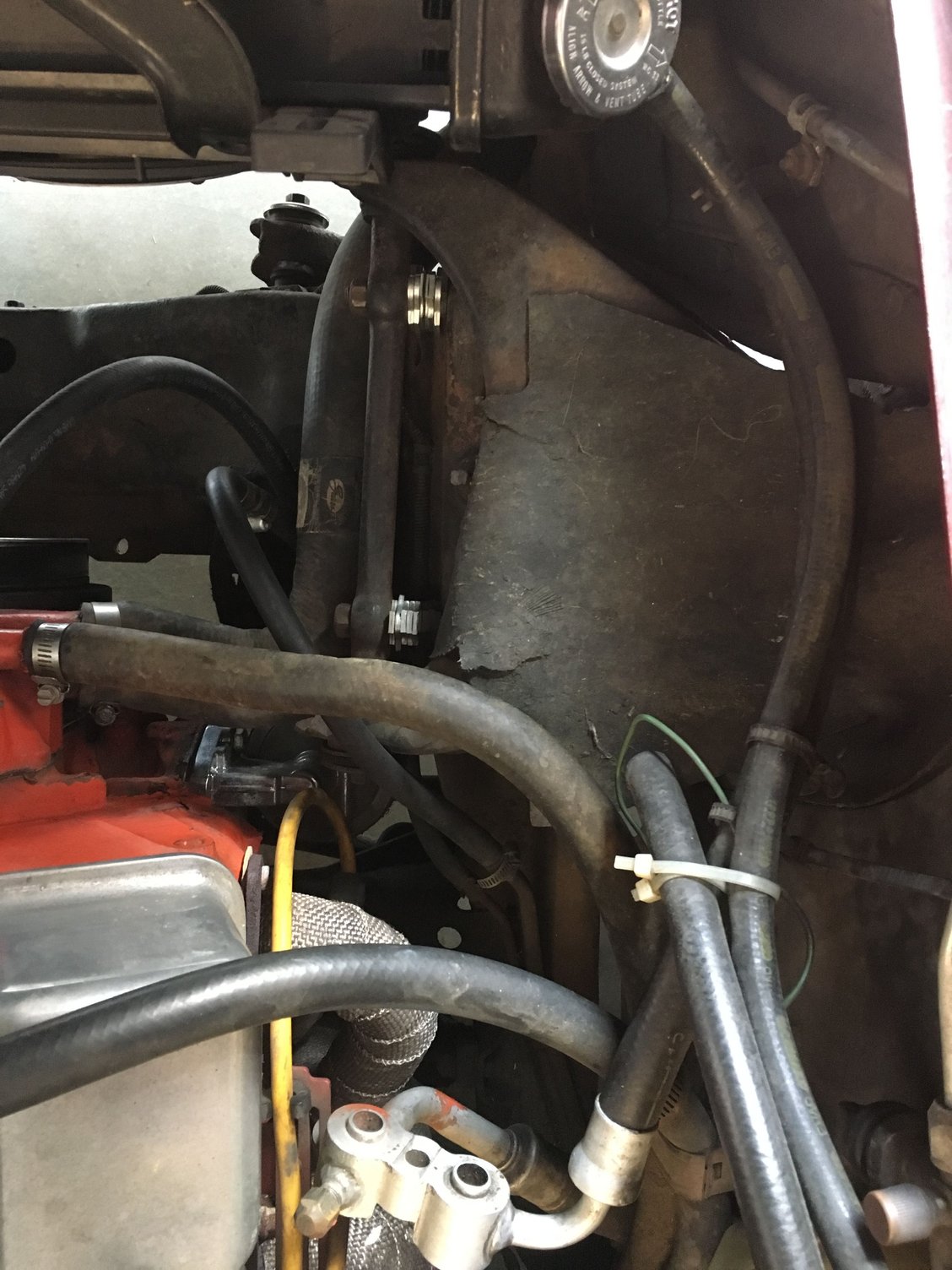

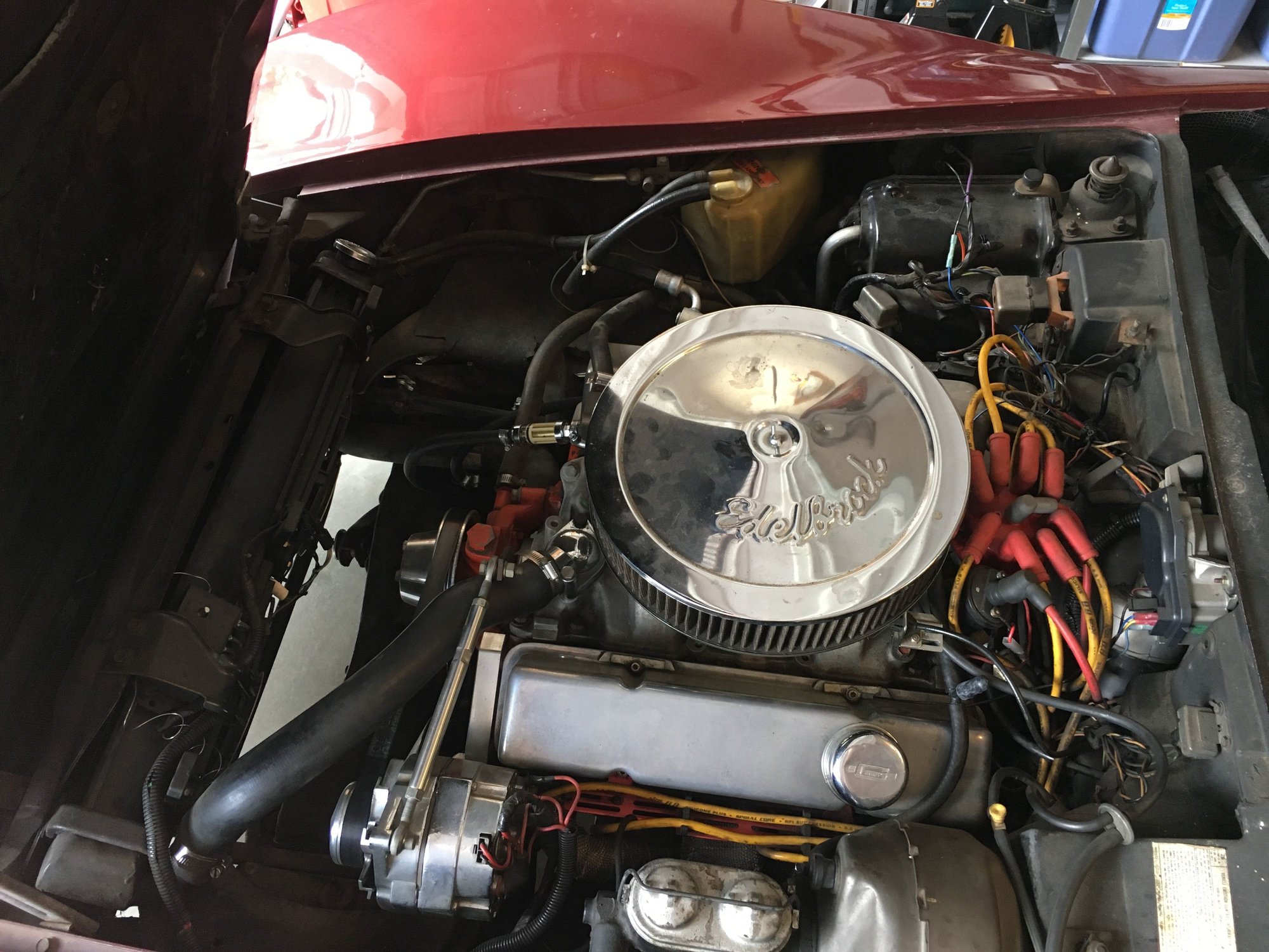

Got the car back from the shop. Snapped some pics. I hope they are clear enough. You can see the stack of shims on the passenger side. The ground down passenger caliper. How much more deepest the passenger wheel is (it is also a narrower wheel). In one image you can see a belt rubbing against a brace. Also, some pics of the interior.
shims...
Belt rubbing
caliper ground down even with washers and plates to give clearance
To Got Fleeced

Here's info from the mechanic. He didn't charge me for his time.
-Serpentine belt hitting cross bar for the L/F Upper A Frame
-R/S A-Frame has a lot of shims to try to get the caster and camber proper
-Measured wheel base & R/S is 1 1/2" shorter than L/S
-Engine is cocked & pushed over due to the car being hit really hard on R/F corner
-Crossmember has been re-welded
-R/F spring bucket is bent and shock hits coil spring
-R/F wheel has 2 spacers and washers stacked behind it & also the caliper is ground off because the wheel was hitting it & still does
-Master cylinder is no good
-car backfires pretty bad
- Base of fuel pump is pinched at more than 90 degrees due to the frame damage
