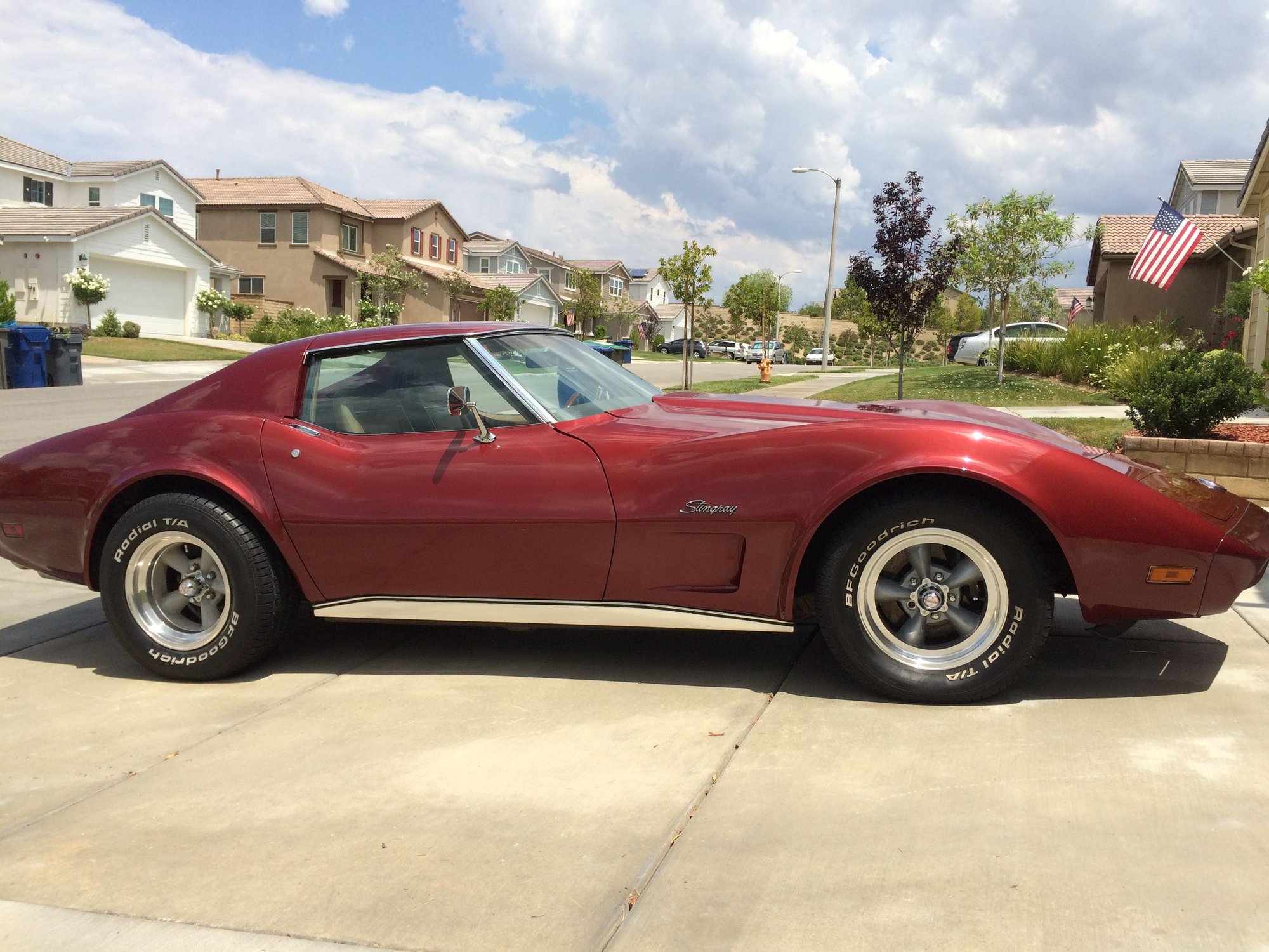

Thanks man. I'll try to upload some pics. The mechanic is a friend of a friend who I trust.
The frame needs to be straightened out. The motor is pushed towards the driver's side a bit, there are 10 or so shims on the passenger side to get the wheel straight enough to drive. Distance between wheels is 1 1/2" shorter on the passenger side. A couple of spacers and washers allow the passenger side wheel to rotate. Many more complications that just don't make sense to make the expense...

It is a good looking car, so I wouldn't be to quick to dump it.
The pictures aren't real helpful, though I can tell that the fit of the hood to the right front fender is way off. Granted, the 73-82 hoods are often lower in relation to the fender, but that seems to be a little more than normal.
It might just be the lighting, but the right front tire looks like it is to far inside the wheel opening? Is this an optical illusion, or is the right front tire deeper inside the right fender, than the left is? A 3/4 right front view, just like the 3/4 left you posted above, would help in determining if the tire is positioned correctly.
I would take the car to another shop, for a second opinion. Even better, you should take it to a body shop, a frame shop, an experienced alignment shop, or a Corvette restoration shop, some shop that's familiar with older full frame cars. Very few cars have full frames anymore, and even some trucks are going to unibodies, so there are fewer shops that have experience straightening them.
I won't say that it can't get expensive, but you'd be amazed at what an experienced frame shop can do. I've got a real good alignment shop near me, that has been in business for 40-50 years. People come to them from all over NJ, and most of the Corvette shops in the area use them for frame and alignment work. They just straightened a 70 El Camino frame for a customer of mine, that the insurance company had totaled. It took a couple days, and multiple pulls, by it's straight now.
Where are you located? There may be someone on the Forum that can recommend a good alignment/frame shop or Corvette shop, for you to take the car to.

body and paint look pretty good in the pictures. You say the interior is good and the engine is solid. So you've got a frame/suspension problem. I wouldn't dump that car. Take the body off the car, strip off all of the suspension, and send the frame out for repair.

Oops, couldn't see the pics that you posted this morning. Freaking iPad. Look like a base coupe with at least decent paint. The base coupe greatly reduces the threashold at which you'll be underwater. If it doesn't need paint, it greatly improves your prospects.

Looks like a nice car otherwise...very sad.

Pretty car in the pics....hate to see it sit still. Love the wheels (have the same for my project)
