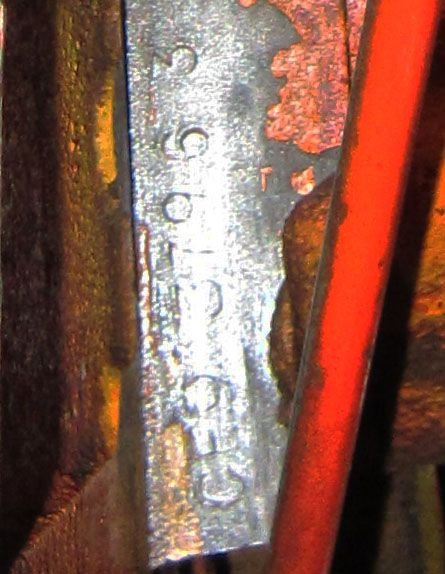

Did dealers install higher performance 454 engines in 1973. I am looking at one that is a 454 car but with the higher performance engine. The block is "dealer stamped" with the correct number.

Who says it's "dealer stamped", the current seller of the car? Anybody can buy an engine block and stamp anything they want on it. Without real paper work you have no way of knowing what the history of that engine is. Post a picture of the engine pad if you can.

CE engines were supposed to be stamped with the partial VIN on the stamp pad by the installing dealer but very few were.
Agree that unless you have paperwork its just another non-original engine
Even with paperwork it is not a "born with" engine so value accordingly. My '69 ZQ3 350 is a CE engine that is a correct late 1969 serial and I have the dealer paperwork that shows the warranty replacement done in Dec 1969 at 10k miles. Still doesn't count as "numbers matching" to most.

Its very unlikely in 1973 they were swapping engines. That happened in the late 60s into maybe 1971 but after that the EPA got involved and put an end to it as everything had to pass emissions. That along with insurance company problems brought the end to the high performance of that time and started the disco era of cars......

why would a dealer stamp a non warranted replacement block? sounds like someone is trying to sell you a tall fish tail

Thanks. Yes the seller is claiming a factory warranty replacement engine as an LS6 454. I will see about paperwork to document. This a person thinning his collection. He has this and a 1974 L82 convertible documented with 51000 miles either for 17K.

In 73 the best and only BB was the LS-4. GM will only warranty the exact same engine that came in the car so it is not an official warranty job.
Even is the owner at the time paid the difference to upgrade to a LS-6 CE engine or had his LS-4 CE engine upgraded to LS-6 specs using counter parts, it is not a numbers matching engine. The best he could claim is a "LS-4 period CE engine upgraded to LS-6 specs", otherwise it just a non-original engine.

Think about it...why would Chevrolet, under warranty (meaning their $$$), replace a LS4 engine in a 73 car with a LS6 engine?
It seems someone is pulling your leg!
Do you know what to look for to see if what this engine even APPEARS to be an LS6 engine?
