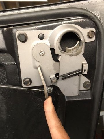

To plastic firewall plugs
Old Feb 18, 2017 | 12:19 AM
jyounane's Avatar
jyounane
Joined: Feb 2002
Posts: 752
Likes: 31
From: Melbourne Australia
OK, On my 69, operating the RH latch will not release the LH. See photos...
I imagine the Chevrolet tool is needed in the event the hood cross cable breaks, so the RH latch can be released. If the underdash cable breaks then you would need to release the LH (and RH) latch from underneath or through the gills.
Joe

Hi j,
Honest!! I just tried it again.
On my 71 the sheathed cable is stiff enough so that moving the right side latch lever also cycles the left side latch.
That's with the hood open.
Hood Closed? I can see that it wouldn't cycle the latch closed because of the tension on the latch.
The tool's use instructions show a photo for 68-69 and one for 70-71…. different latch?
Regards,
Alan
