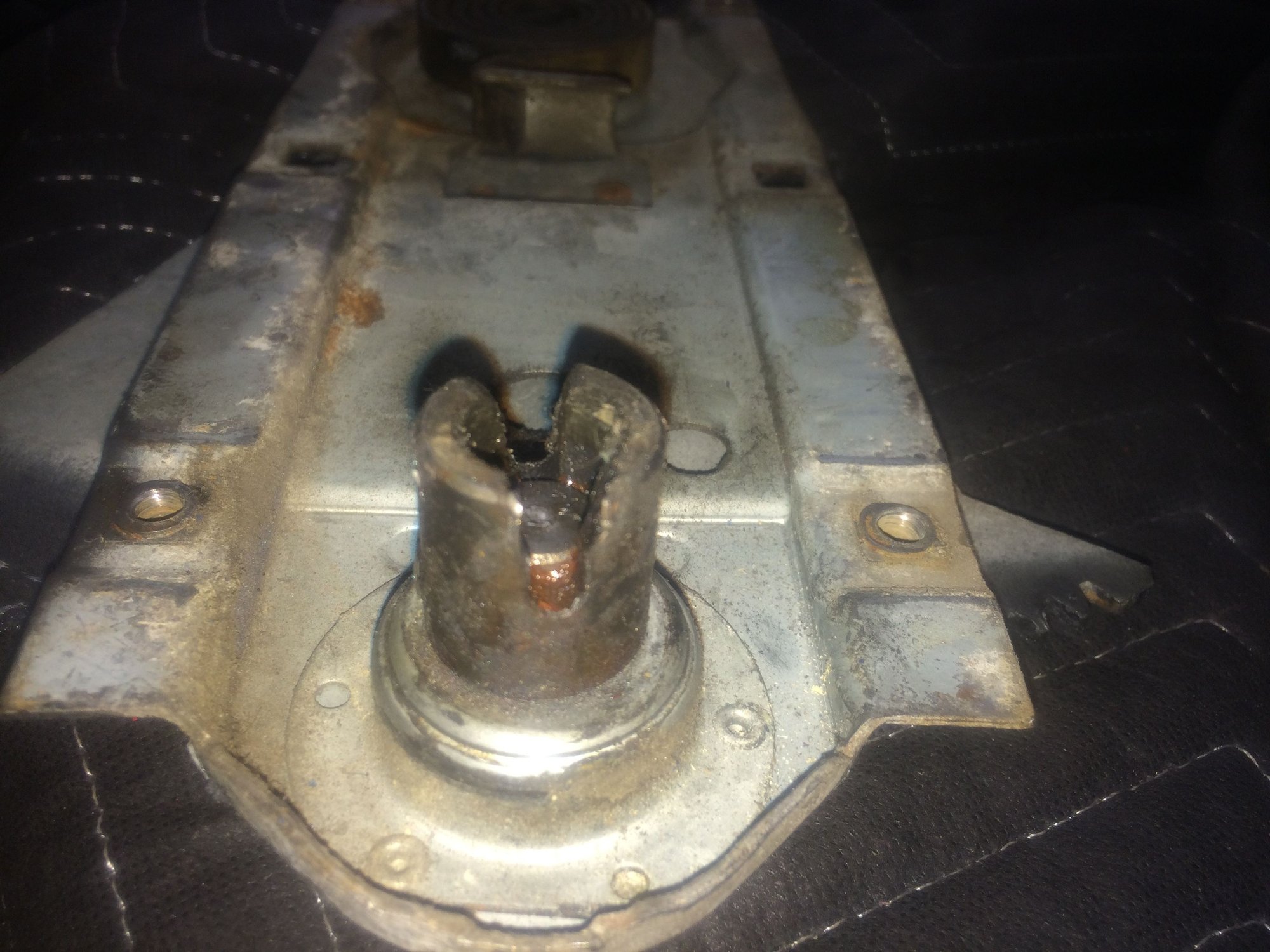

Hi Ken,
The problem might also be caused by the connection of the handle to the shaft.
The shaft on the winder is splined at it's end. The winder handle base is grooved to receive the splines. The spines may have been worn down or the grooves in the handle may have been worn.
You'll need to check the condition of each to see where the problem may be.
Good Luck!
Regards,
Alan
Left arrow points to the pin that fit's in the groove in the part in F's photos.
Right arrow points to the splines on the shaft that fit in the winder handle.
