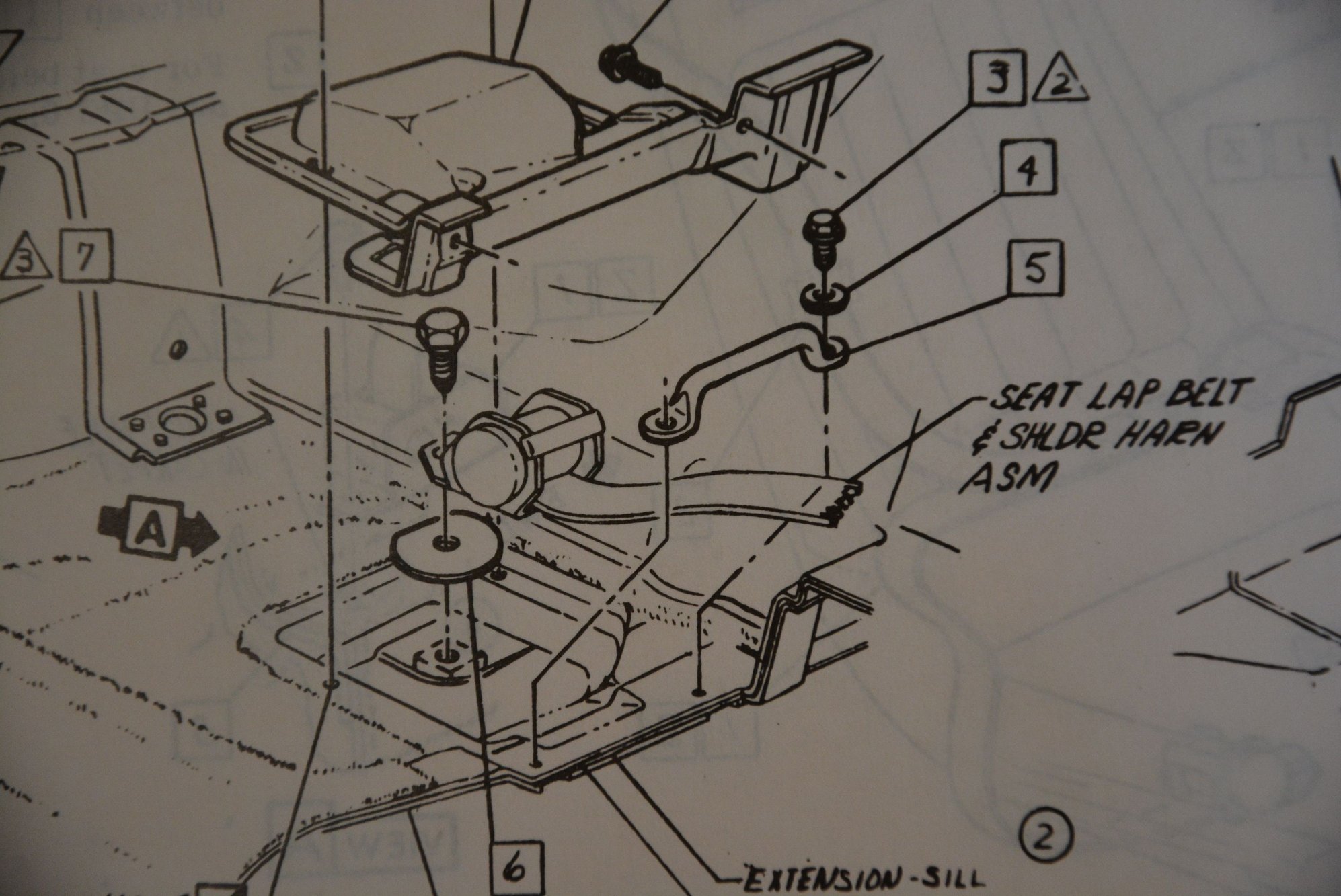

Even though I think the covers were mainly there to protect the retractors, you may still want to use them. The covers may also protect the belt webbing from premature wear and damage, do to rubbing on the seat tracks and/or seat frame.
At minimum, I would reuse the metal belt guides, that bolted to the sills, as a safety measure to keep the belts clear of the tracks and seat frame.
The image below shows the covers and guides (#5). This image is from the 74 Assembly Manual, but 73's use the same covers and guides.
I'm using the guide bars, you almost have to in order to keep the belt positioned correctly and as you said to keep it from wearing on the seat track/bottom.
