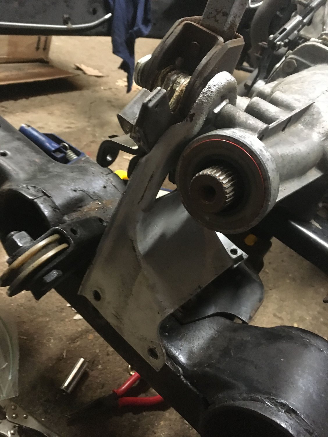

Need some info on how to get this shifter support bracket in...
This is where it's at rn

Looks like it needs to be installed on the frame before being attached to the transmission.
Just my guess

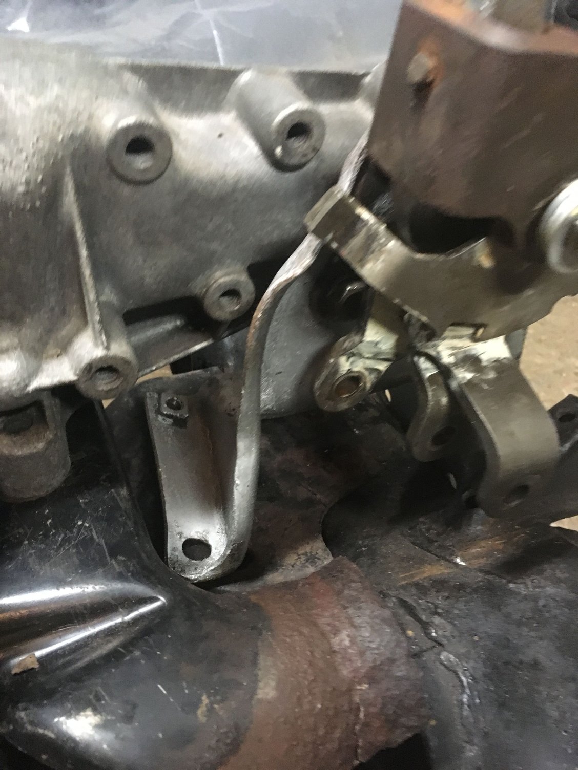

Hi Y,
The shifter bracket in your photo is damaged. It's twisted and one of the mounting nuts is missing.
Is the crossmember for a manual transmission car?
The shifter bracket mounts with 2 bolts into the crossmember and 2 bolts up from below through the transmission mount bracket.
This is a 71, 68 should be similar.

It appears to me the bracket that has the 2 half cut outs for exhaust hangers is up too high and needs to be lowered. Phil

Everything in your pictures look pretty beat up . The shifter arms look like they were welded and I can't imagine how someone could damage the bracket that much. I know you don't like to spend money but I would look for some good used parts . It's not fun to install those parts when the body is on so why have problems and have to do it again .
not welded that's grease
it's jacked up so the weight is off the shifter

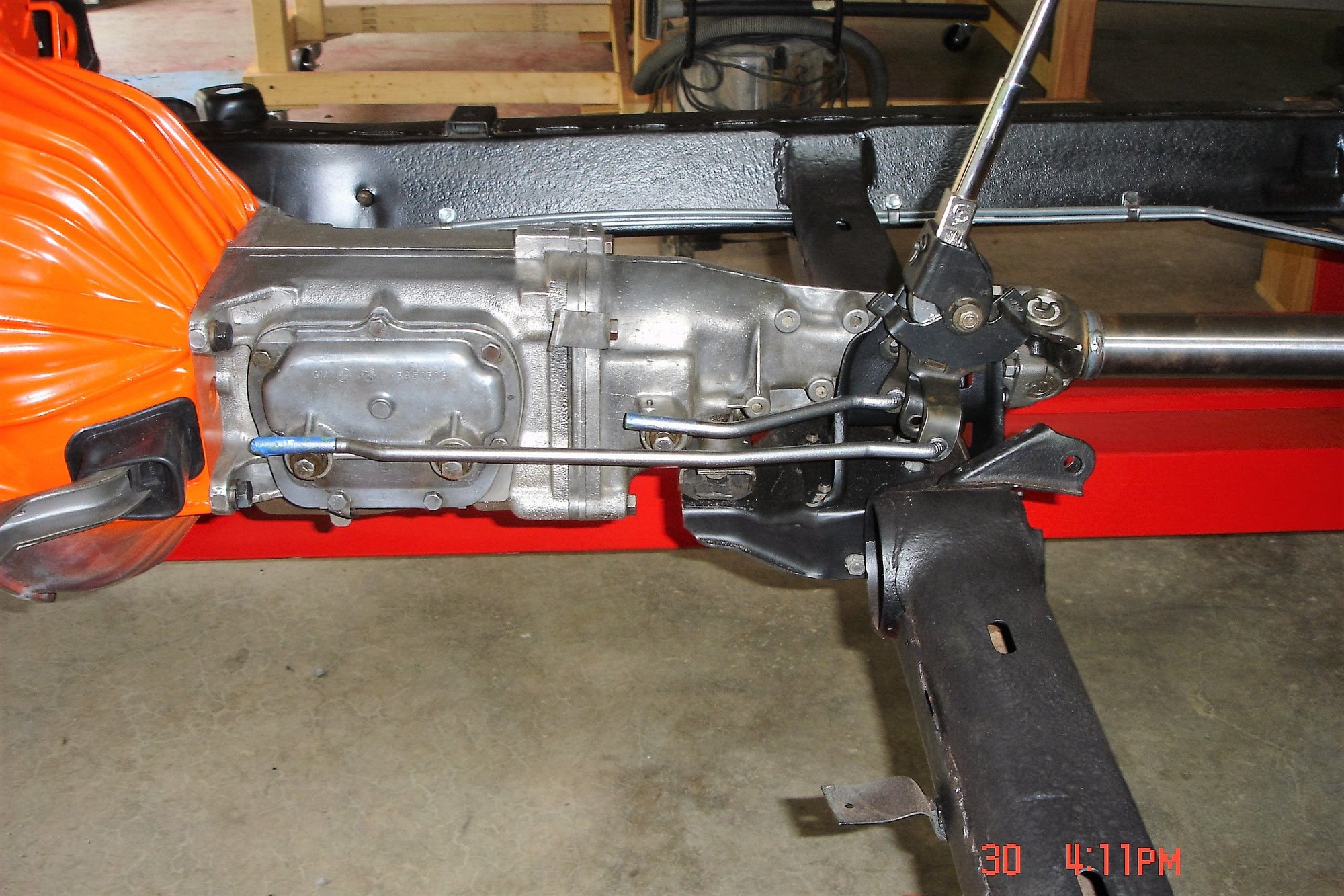

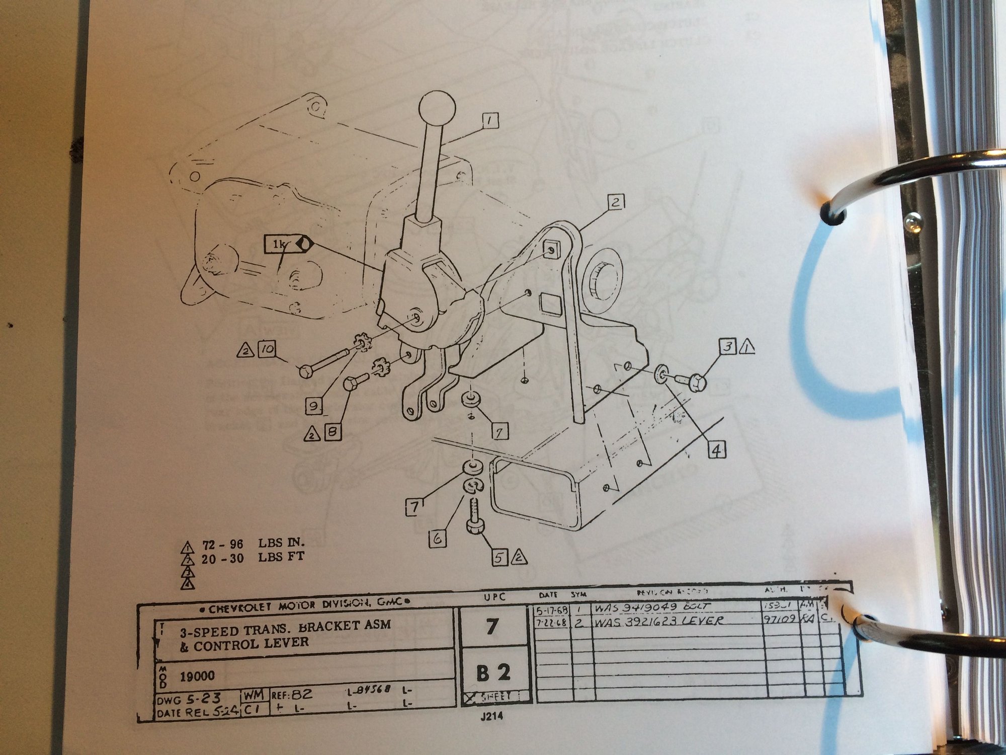

This is from the 69 AIM and clearly shows how the bracket attaches to the crossmember and the transmission bracket. It doesn't mount directly to the transmission.
Old Mar 13, 2017 | 12:24 PM
Easy Mike's Avatar
Easy Mike
Joined: Jun 2000
Posts: 38,923
Likes: 1,482
From: Southbound
Cruise-In II Veteran
Originally Posted by sullyman56
...This is from the 69 AIM and clearly shows how the bracket attaches to the crossmember and the transmission bracket...
AIMs are wonderful things to have.

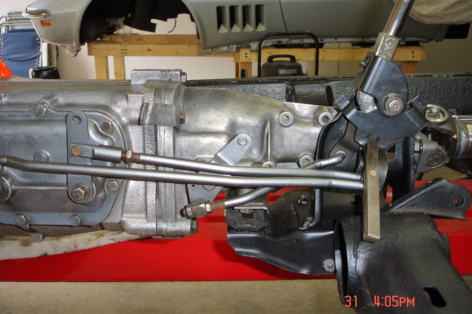

Feeler gauge works great for aligning the shifter. Oh! linkage goes in the top holes on the side cover.

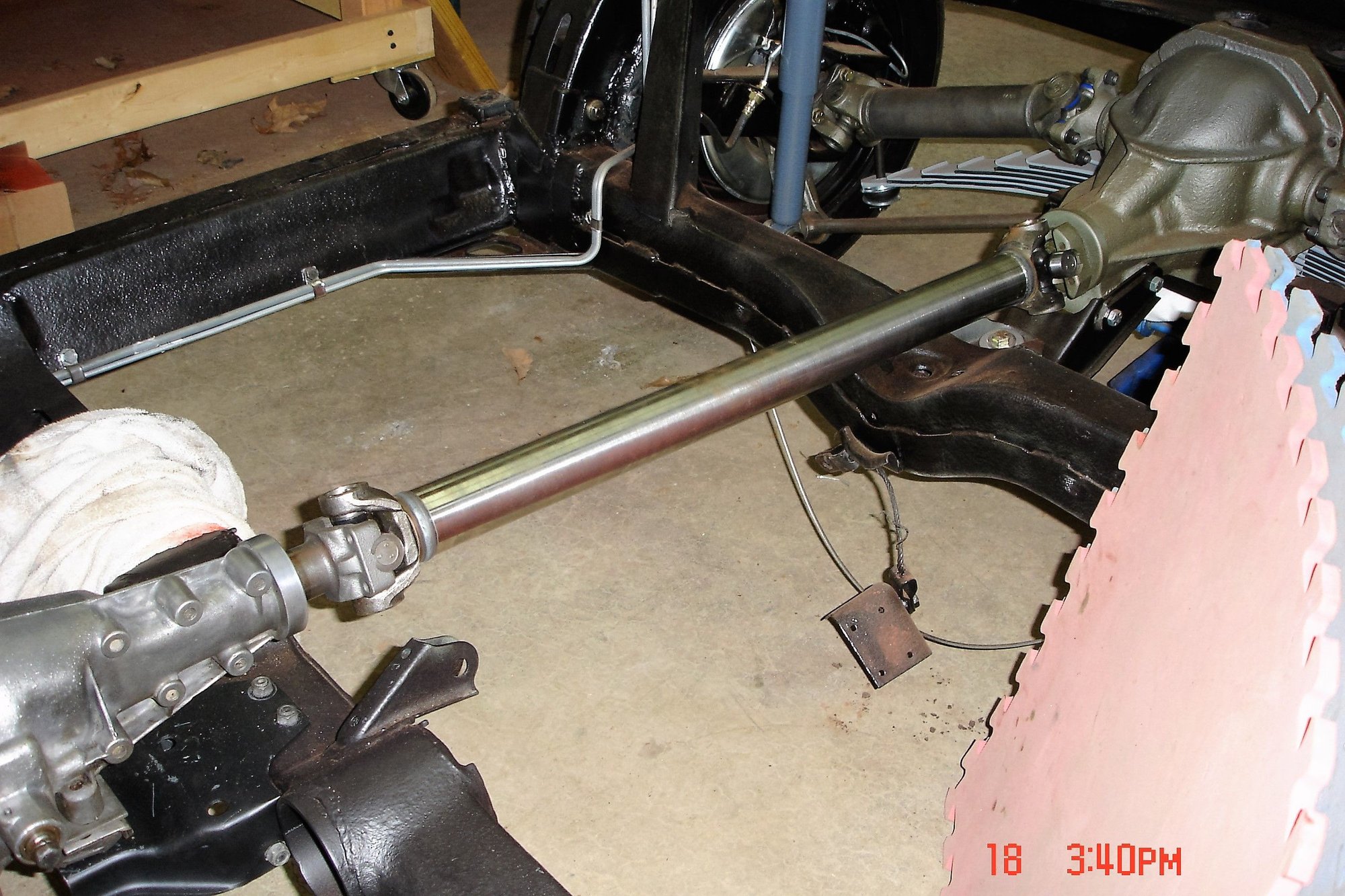

Here's a couple of photos with the drive shaft in place so you can see the position of the yoke.
Since the yoke at the differential is fixed in length the yoke at the transmission needs to be able to slide in and out.
