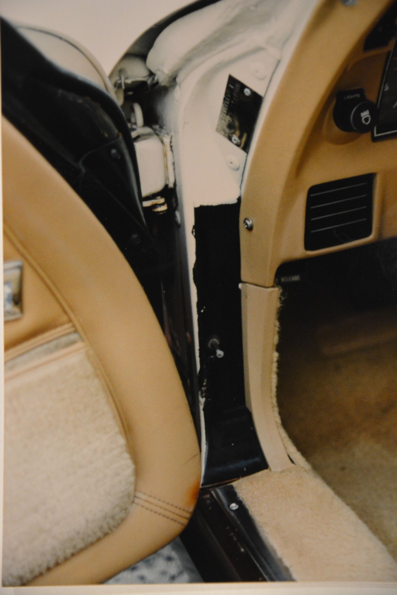

The area of the door, between the weatherstrip and the door panel, is blacked out in semi gloss black, all the way to the bottom of the door. This was done on all 68-82 Corvettes (except maybe black ones?). The hinge bolts are body color and I think the shims are too.
On 78-82's, painted in lighter colors such as white, silver, beige etc, it's possible that there was blackout applied to the body, in the area of the hinges and courtesy light switches. It doesn't appear that this blackout was applied to all light color cars. It may just have been used on ones where the fit of the door and kick panels, allowed the exterior color to be seen inside the car. I've never seen it applied to any cars earlier than 1980, but I've been told that it's possible that it was done in 78 and 79?
Below is an 81, that has both the door and body blackout applied.

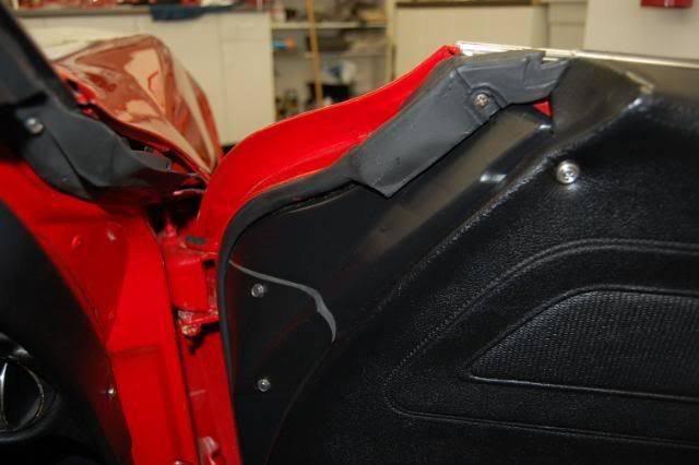

Hi,
The black paint applied to the front of the door was very crudely done.
It varies from car to car as to just how far down the black extended… but typically at least about half way.
The doors were on the car when it was painted so the hinges and any shims used were painted. I guess a shim might have been added later, but that wouldn't be typical.
Regards,
Alan
Here you can see the part of the hinge that was in the door wasn't painted but the part on the hinge pillar was.
Also note that some black sealer was added after the car was painted.
