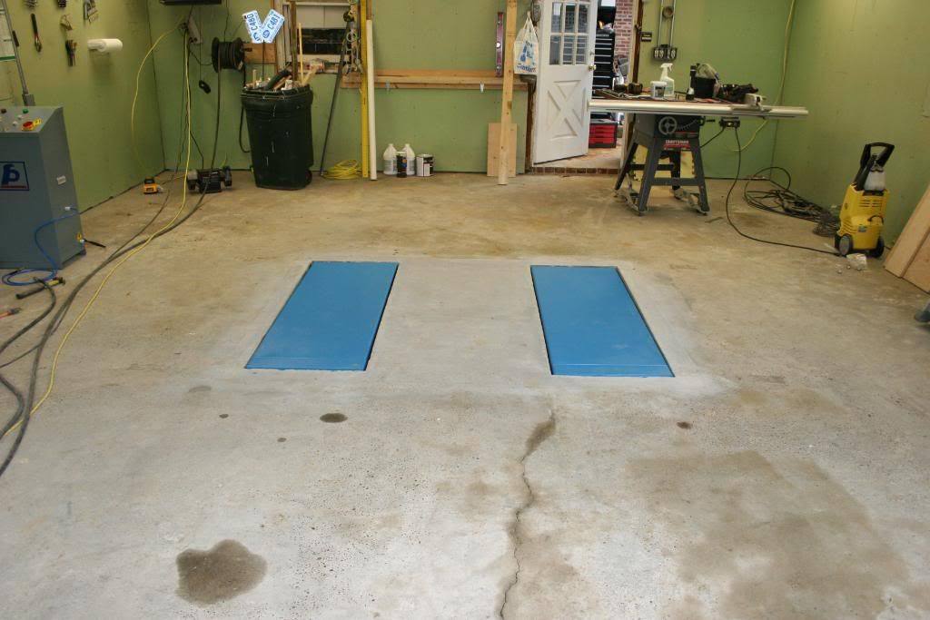

Here's some pics of the flush mount:

I love my in ground scissor. Only downsides in my opinion are that you can't use it with an engine crane, and it doesn't allow storing an extra vehicle underneath if that's what you want (I don't). Upsides are plentiful - easy to use, best option with low cars, out of the way (part of the floor!) when not in use, also makes a useful adjustable height workbench/platform, can use it as a motorcycle lift, etc... I think it is the best option for a home garage hands down.

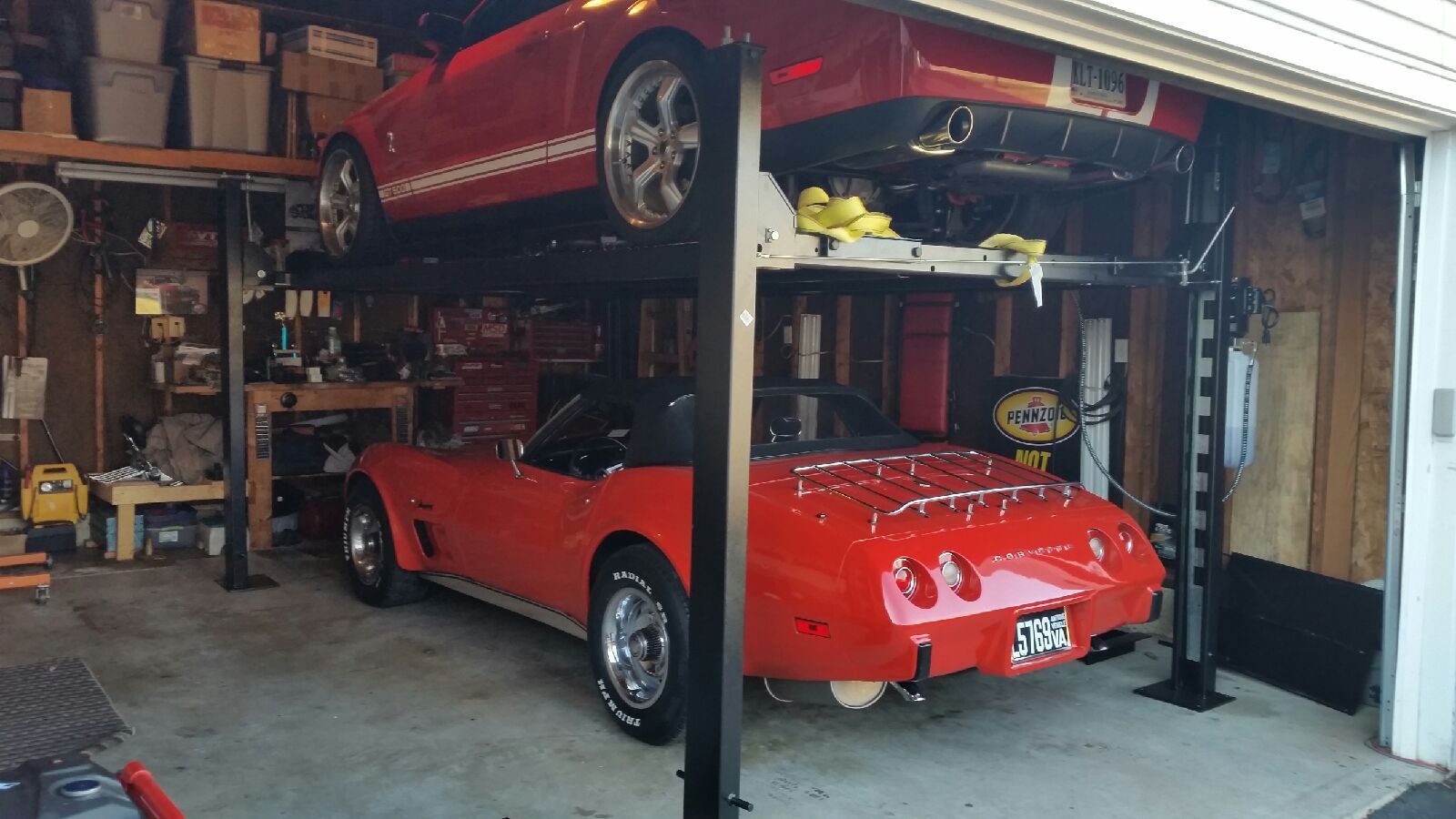

That in ground scissor lift does look nice, but I went with a 4 post, and a rolling jack. I was looking to get all of my toys in the garage plus my wifes car. I picked up the rolling jack that rides on the inner rails to install my new suspension parts. Working on the car has never been easier! No more crawling on my knees or slithering under a car!! When I use it for storage, the corvette is on the lift, I store 2 motorcycles under the lift, my DD behind the lift and my wifes car resides next to my DD. Its a nice setup

When I was young, my uncle's shop had several different lifts, 2poster, and a 3 different styles of inground lifts, including a scissors lift like the one you showed. The only drawback I remember was having things get in the way, like airhoses and light cords, or parts/tools/debris falling in the channels and causing problems.
