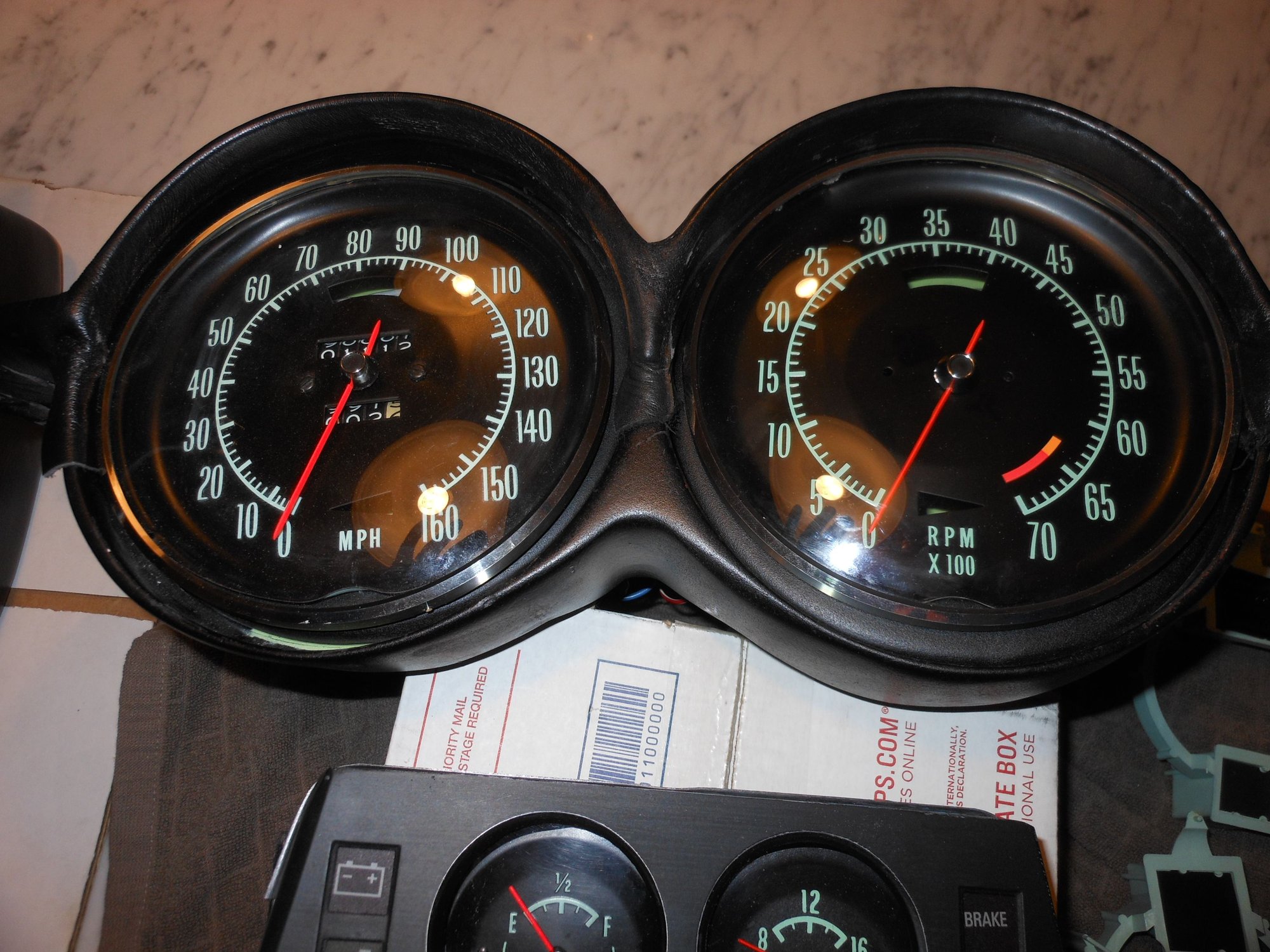

For those of you that have had to work on the drivers side dashes of the early C3's , you know that it will try your religious faith. I had to pull the dash again to install two new dash speakers and wasn't looking forward to it. It lived up to what I remembered and expected. I realize that to get the beautiful styling of these dashes GM had to cram everything into a very tight space but I hope mine never has to come apart again . I have a lot of experience restoring cars and have never seen any other car that is this difficult to work on the dashes so someone doing it for the first time will surely pull their hair out trying to do this job , especially when they try to put the drivers side panel back into place . The most important thing is to make sure the wiring harnesses are in their proper place held in with their clips or they will interfere with the dash going back into place . I didn't pull the dash all of the way out just enough to get to the drivers side speaker but I had to disconnect the steering column under the dash and at the rag joint so I could lower the steering column to give me enough room. It's not a fun job but now I can hear the radio when I am driving down the road. All I had before was the footwell speakers and with loud exhaust couldn't hear much. I never had to work on the dashes of the later C3's so I don't know if they have the same problems . Can anyone comment ?

Originally Posted by bj1k
Your idea for the lighting circuit behind the drivers side dash sounds like a good idea too . How many times do you finally get the dash back in with the stock light plugs and find out after night that some of the light sockets fell out when trying to get the dash back in place ? Now it has to come back out . I always liked the metal light sockets that they used in other early GM cars . These plastic sockets want to fall out when you bump them. Do you have any pictures of your setup ?
Now this is a custom dash- however I did keep the OEM gauges-so the wires are the same.
A multi-pinned connector and then a 3 pin connector so I can pull the tach board if needed
For the center console-
