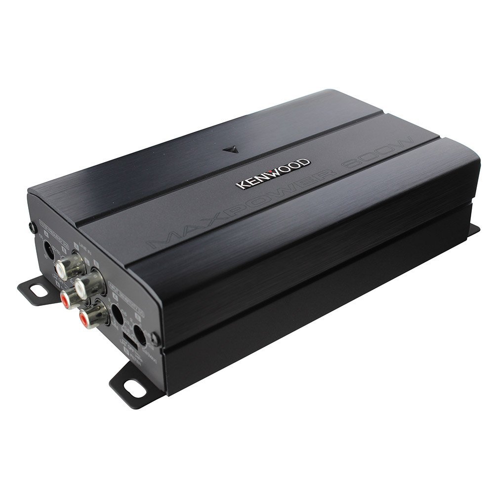

Ok, I have searched some of the threads on here but they tend to go way overboard for what I am looking for. Ill start off by saying I do not want a sub nor am I trying to rattle the bolts out of my car. My question is, would a 4 channel amp to power my dash speakers and rear speakers improve quality at all? If so, where would I pull from for a remote wire for the amp? I am no audio guy so sorry if this sounds stupid.
Here is the amp I was interested in...
Amazon Amazon
Also what gauge wire would I run for the speakers and amp power and ground?

Hey Shaun-
The amp would help out-However:
I'd look for one that has a "variable high-pass filter on front channels." That will keep the low bass from the front speakers. Smaller speakers really can't handle the bass- taking it away from them electronically is the best way to do it- and they'll sound so much better.
The larger 6 x 9 in the rear will handle what the small fronts can't - and since bass is non-directional - you won't miss it from the fronts. A win-win.
Incorporating this simple feature on the amp will be the best bang for the buck.
You can just use the output for the power antenna to turn on the amp- If you don't have that- one of these $15 devices will sense speaker output from the radio and turn on the amp.
Amazon Amazon
16 gu wire is fine for the speakers- if it's really copper wire. There's a lot of junk out there that's copper coated aluminum (CCA)- stay away from that stuff- brittle and breaks way to easily and doesn't conduct near as good as the real copper wire.
Since the power from the battery will be a short length- and you're going with a relatively small amp- 10gu will be fine - Again make sure it's real copper wire.
Hope that helps-

Would you recommend grounding the amp directly to the battery and power wire with in line fuse to batt?
Old Mar 28, 2017 | 09:07 PM
Richard454's Avatar
Richard454
Joined: May 2003
Posts: 8,877
Likes: 3,556
From: Fernandina Beach FL
Yes-
The battery does more than just start your car.
It stabilizes voltage and filters out AC ripple not cleaned up by the alternator. Electronics LIKE both of these.
Richard

Ok, thanks for all the input. Please tell me if this makes sense, since the dash speakers don't do much sound wise, would it be easier to get a 2 channel amp, mount it in the storage compartment and just run the two 6x9 off the amp? How would the wiring look for that? Would I run the two dash speaker wires to the dash speakers from the head unit and RCA from head unit to amp, then wires from amp to rear speakers? Sorry, Back in my day, car audio was doable, haven't done it in so long and wiring just isn't my fav thing to do.

Power to the speakers-
Speakers have a rating of efficiency-sort of like gas mileage.
IIRC the front speakers you had purchased are rated at 90dB- one meter away and with 1 watt of power. So they will play that loud under those parameters- the rating is called "System sensitivity." Normal conversation is about 60dB-Stock Corvette running down the highway will have road noise around 80-85dB- sidepipes can approach 100dB!!!
So the gas mileage sounds pretty good? 90dB with just ONE watt?
That one watt is going to play pretty loud?
Unfortunately it doesn't work like that. You have to DOUBLE the power to get a small but noticeable difference of 3dB.
And then there is what's called "headroom"- or the transient audio peaks - without extra power to handle these you could possible damaging the speaker. And to overcome the road noise you will be turning it up louder than you think....
It is a LOT easier to damage a speaker with too LITTLE power than not enough.
Having too little power creates distortion and will actually send DC voltage to the speaker. Audio is AC and sending DC to the speaker will burn the small wire wrapped around the voice coil just like a fusible link.
I'd do the amplifier on the front and rear-with the bass filter.

Richard,
Sorry for all the questions, how would i run the wiring for the power ant to the amp and still have the ant work? could I just tap into the wire that runs to the ant now and just run that to the amp? Also, I dont know how much "air space" an amp needs to breath, would I be able to mount it in the jack storage compartment? if so, how would I do so?

Yes- just teeing the power antenna lead for the amp turn on is fine. Most radios are rated at ½A . The wire can be relatively small- 18gu is fine as there is very little current required to turn on the amp.
The jack storage would probably be OK since your not really running a big amplifier. But since there is not a lot of air movement, it'd be best to mount the amp as pictured below. As heat rises- it'll will cause hot air to move upward and cool the amp.
You could just use a piece of plywood and some L- brackets to attach it to the storage compartment- then mount the amp to the plywood.
Richard

You are just looking for some decent tunes- here's a good one that has the filters and would work great in your set-up. A little over $100.
Power ratings are still to this day all over the map...Sort of like that Honda owner that claims 600HP.
Amazon Amazon
Originally Posted by 7T1vette
300 Hz is pretty low for "tweeters". You'll rattle the dash apart with that much power in there.
Unfortunately that amplifier is rated with what I call- "The ILS Rating"- if lighting strikes...It's not that much power- realistically I'd say 25 watts a channel full bandwidth.
Here's got a midrange AND a tweeter in the dash- trust me it wont rattle with a high pass filter.
P.S. I used to play bass in a rock band in the 70's and had a double-stack set of 15" speakers that reproduced bass frequencies very nicely.
That's pretty cool- I didn't get that music gene!!! Bummer I was never a musician - so I had to buy a Corvette to get the girls!!!
I did do a couple of gigs when I worked for Kenwood 20+ years ago- I was fortunate enough to go around the country and do amplifier clinics- Got to test at least a hundred or so of then- various brands and power ratings.
I didn't have (2) 15" but rather (32) 10" !!!

Most modern amps have good signal quality. The "power" issue is a crapshoot as many use different rating systems...just so they can claim big power (when they really don't have it). You only need power for bass frequencies and low mid's; if you don't have adequate power, you get lots of distortion in the lows when you crank it up.
If you don't have a sub-woofer, that's a good thing IMO. Besides not blowing your eardrums out or turning your brain to mush over several years, you're mostly just trying to make a statement to those driver's who are unfortunate enough to be close to you OR to just be noticed. It has little to do with accurate reproduction of sound...and you can't do that anyway inside the passenger area of a C3.
But, for good sounding music with low distortion and accurate sound reproduction you need something in the area of 100 watts RMS or 200 peak. You won't use nearly that much for sound power, but you marry that amp up with some low efficiency speakers that use a lot of that power to move BIG magnets in the bass/mid speakers; that yields good sound reproduction. Maybe 2/3 of the power used is to stabilize the speakers and the rest is to produce sound. Tweeters don't need to handle power, but they do need to be good quality with accurate response over their range. So pay for well made speakers. Bass/mid speakers will likely be 2-way type with bass AND midrange speaker elements. These need to handle power AND have good response curves.
That's the "recipe" for a pretty good sound system in a C3's cockpit. You can still blow your ears out...but it will sound good while you do it.
