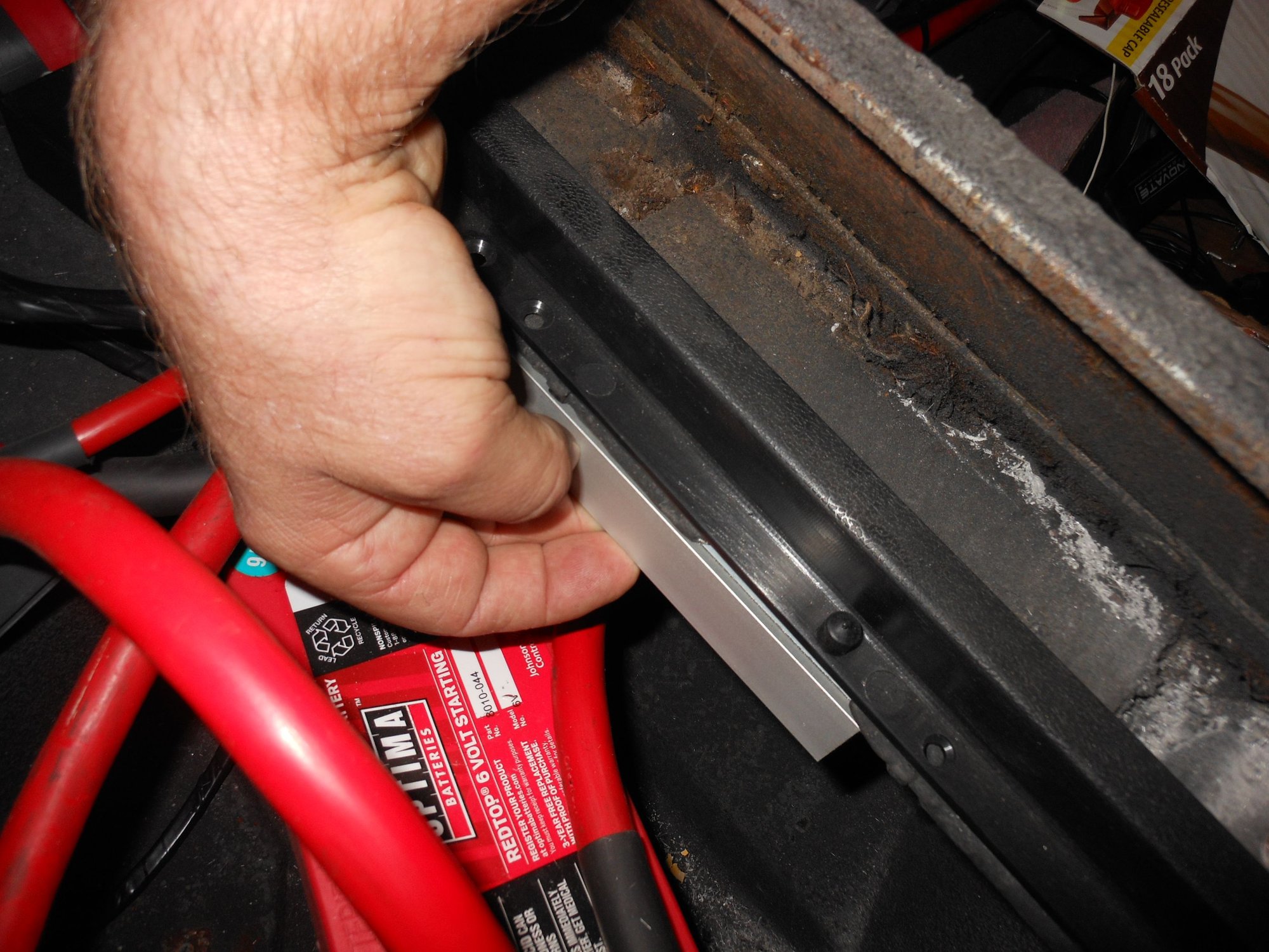

Where would I screw the L brackets into in the jack compartment? Just screw into the FG?

You gotta be careful- as just randomly screwing through the fiberglass will go outside the car...
I'd look at incorporating where the compartment door frame is screwed down. That way you can utilize the factory holes.
Some long L brackets at the hardware store- aluminum is great as it's easy to drill- and plenty strong.
Then remove the factory j-clips or u-clips & screws and use machine screws and nut.
