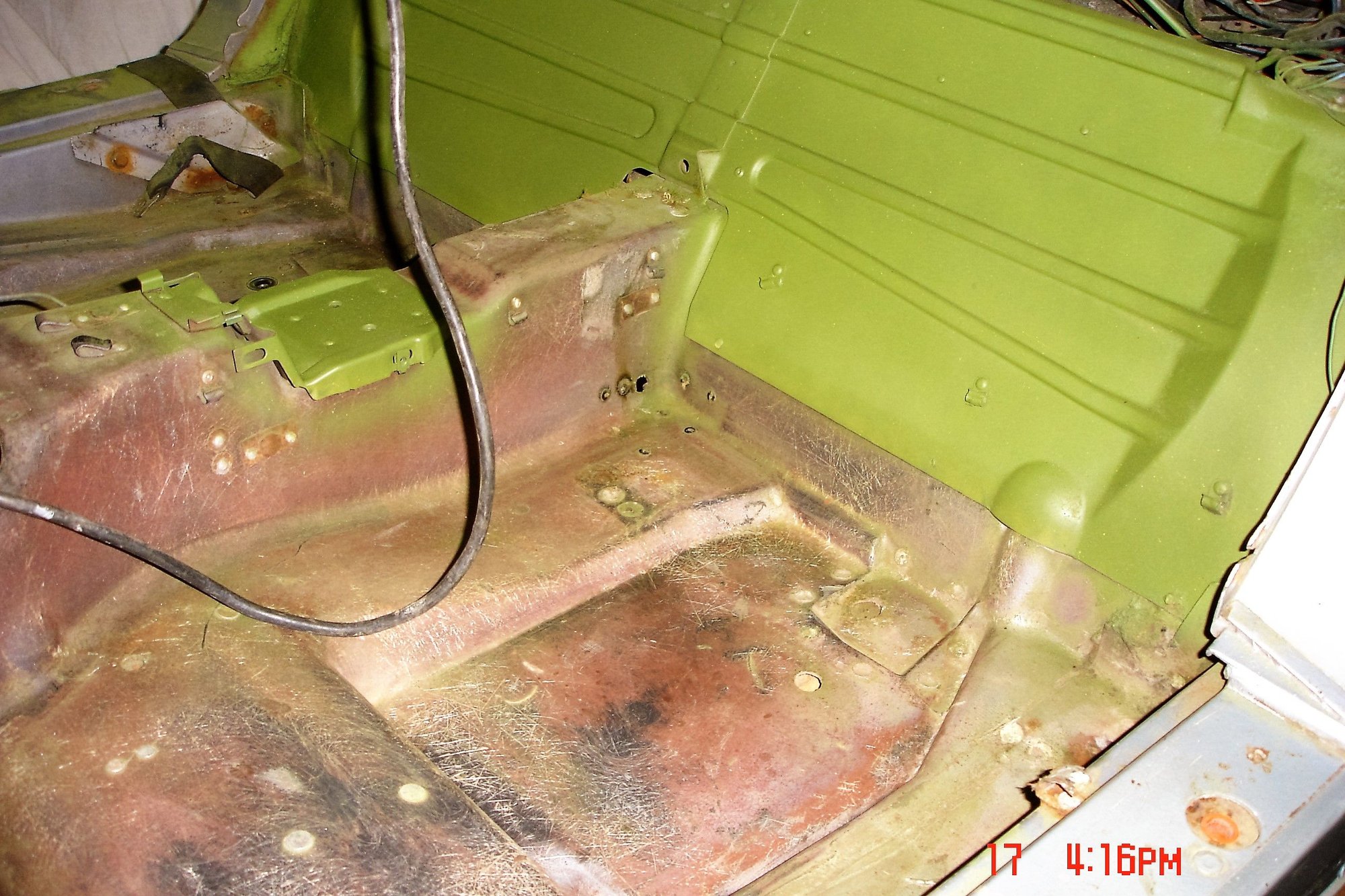

This was recommended by a member a few years ago. It worked very nice, the shade was very close to what was on my 69. Yes need to where a mask for sure but not a big deal.
RVZIO

That looks like the 'right stuff' !
Hey, I just noticed on the can that it is made just down the road from me in Sparta, TN. Next time I'm down there during the week, I'll have to stop in and say, "Hey!".
