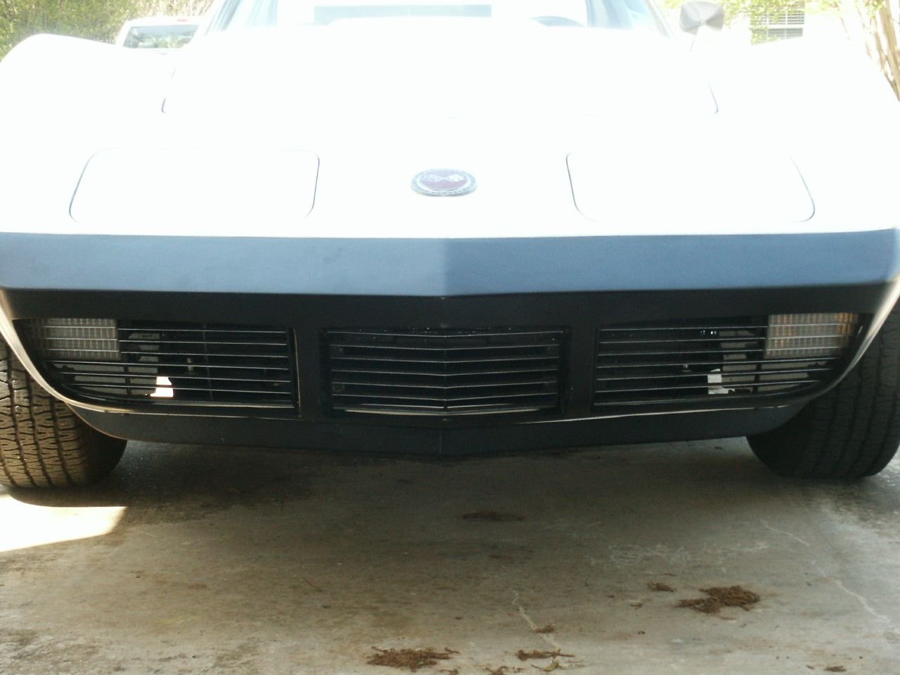

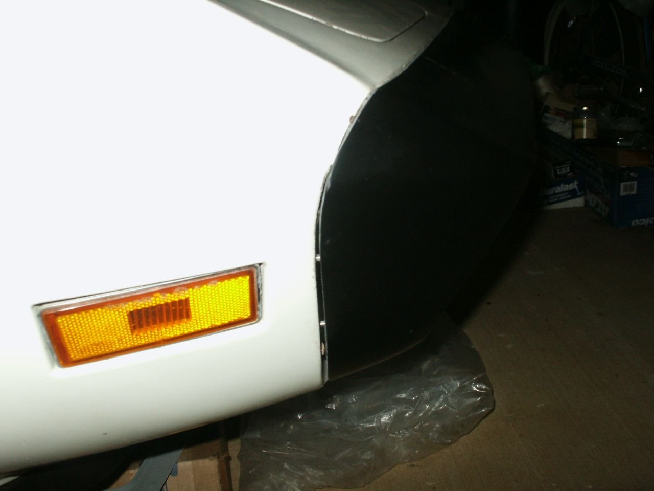

I also used the Tru-Flex bumper on my 73. I have the bumper bar and even have the rubber piece that was glued the the front of the bar. You don't have to remove the bar for the bumper to fit, but you more than likely will have to trim the tru-flex cover. Trim the cover never the fiberglass front.
Here is a photo of the cover with the fit before I trimmed and after.
Before:
After:
Donnie
