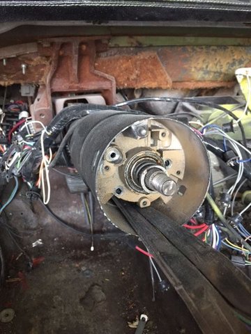

Here are some pictures. In the first one, you can see that I have everything off that I can see. The second one shows how far the upper collar comes off. So, two questions:
1. Does this need to come off to de-compress my steering shaft?
2. If so, what am I missing?

Did you have the column apart when you changed the lower bearing? Doesn't look like it from pictures. If not sounds like the shaft slid down or the lower bearing is not in the right positition. Was bearing seized on lower shaft? I had to emery cloth my shaft and figure out where to position. I think I remember reading shaft has a marking on it and only goes one way. Attached blowup of your column I beleive. Jim Shea is the expert on this so perhaps reach out to him at Wilcox

I didn't pull the steering shaft out when I did the lower bearing, though it did slide back in there quite a bit, so that I had to pull it back out. As far as the lower bearing, I cleaned up the lower shaft and the bearing slides pretty freely on it. I replaced everything (retainers and clip per Jim Shea's instructions). I'm 99.5% positive it's not binding at the lower bearing. The reason is that I can pull it down to engage the rag joint. But if I do that, the part at the top where the clip goes is way down inside the collar.
I've looked at the drawings, but it's hard to tell which part can get caught on other parts. I was hoping this was a common issue and there was some trick to it I was just missing. Thanks for the help.
