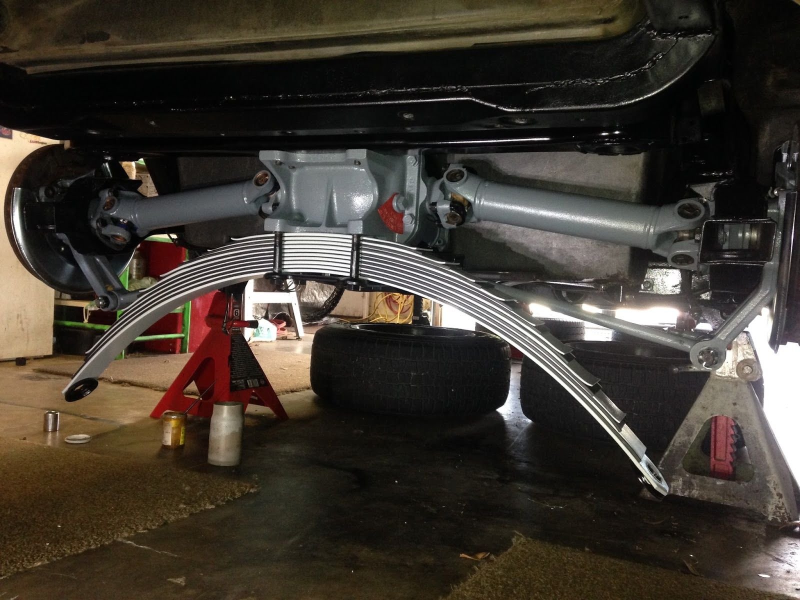

I just rebuilt my 10 leaf replacement....I got lucky and found a bulk roll of liner on eBay....It was supposed to be long enough to get all 9 liners but it was short of the advertised length....Seller made it right and I just reused 2 of the older ones.
I can't say for sure if my spring had ever been apart or not but it did have a liner between each steel spring so I think you will need 9 as well to rebuild this one. All my springs had a bend to them.
Here it is after I finished....It's hard to tell the old liners from the new ones.
Brian

thanks for the replys guys and Brian that looks great now im going to have to figure out why my top 3 arent curved like that

Hi andy,
The original springs were designed to have a variable rate.
This was achieved by having the top 3 leafs flat so they didn't affect the spring's rating until the spring was almost completely loaded.
Regards,
Alan
No liner was used between the last flat leaf and the first curved leaf.

Thanks Alan that explains it
