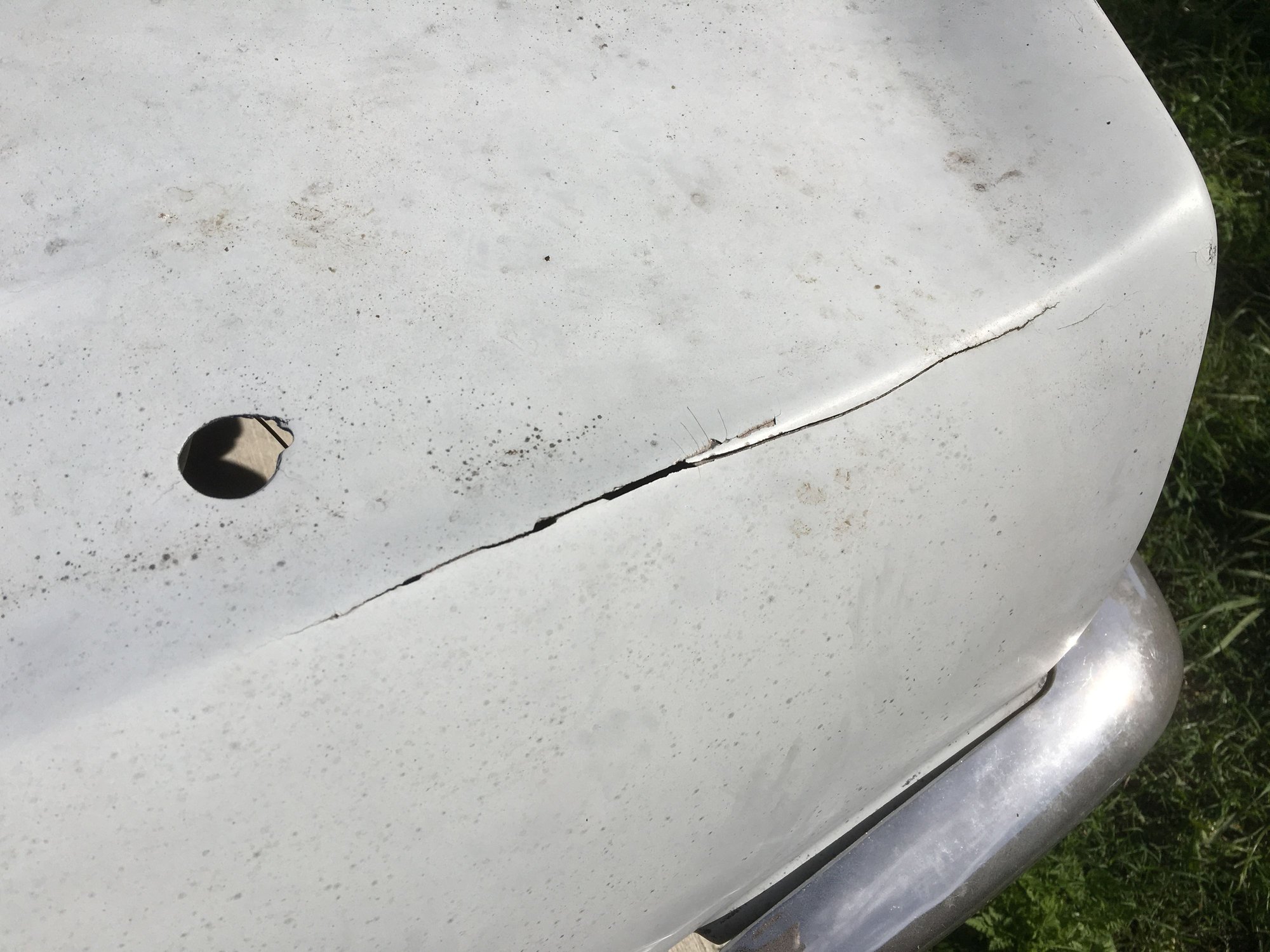

1) we are worried about being able to repair these cracks on the rear clip and being able to keep a nice sharp ridge, is it a fairly easy repair and is this common?

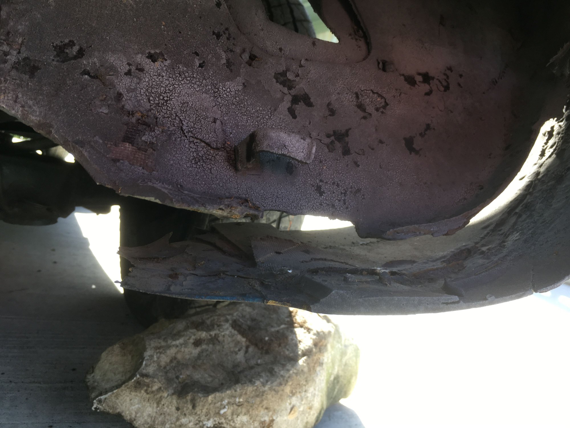

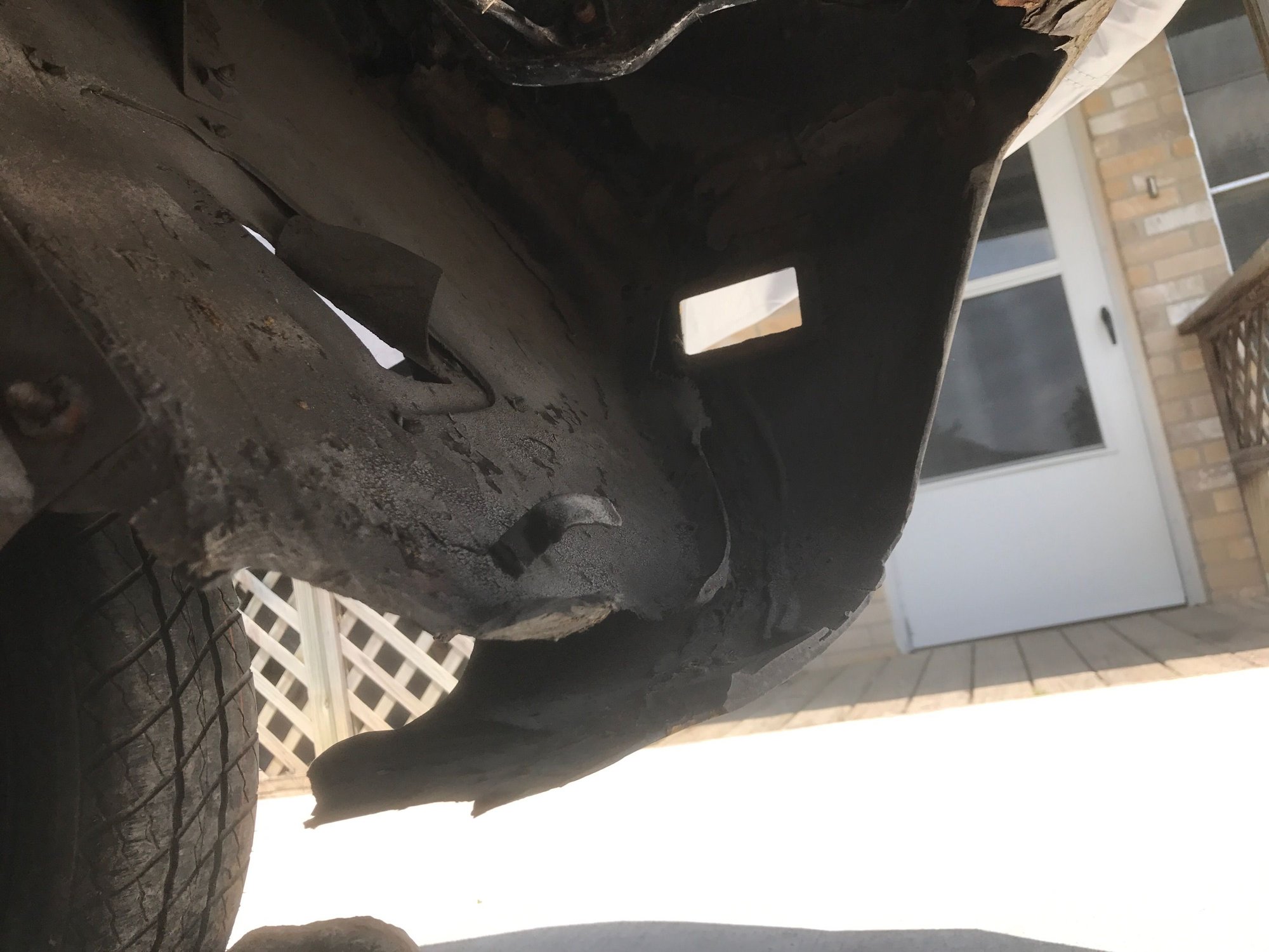

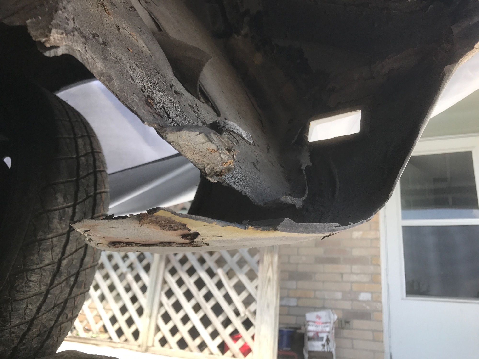

2) Here is the drive side fender well, it has come separated for some reason and it looks like someone tried to bubba fix it with cloth that didn't actually stick, it also looks in pretty bad shape, does this seem repairable?

Rear cracks are repairable if you have experience with fiberglass repairs.
Front shows prior damage repair with incorrect materials and may or may not be repairable. How about a better pic of the damage?

Thanks for the fast response, I can do fiberglass repairs for sure, here are the other pics of the fender well

The crack in the rear fenders are in an odd place in that they didn't occur at the rear deck/rear fender bonding strip, but rather entirely in the rear deck.
Have you looked up from below to try to see if you can tell what's going on from the underside?
You'll know better what the cause was and what the repair will be required once you get the paint off those areas of the car.
The photo of the front shows damage to the inner apron, the front fender, and the lower valance. Do you have the lower valance? And, what kind of shape is it in?
What does the right side lower valance to fender bonded joint look like?

Lower left has definitely been whacked and repaired in the past. The lower panel is missing in your pic. Do you have it?

The lower valence is missing, I definitely have to get a new one for sure, so I guess my next question is, are all thes le pieces bonded at the same point? I work off shore and my wife took all these pictures for me, so I'll have a look at these spots when I get home next week and I'll post some more on what I find under there. Thank you guys very much!!

My advice would be to order the 68 assembly instruction manual (AIM). The AIM shows how the body panels are bonded, including the missing valance.
FWIW: these might also be helpful. http://www.glas-ra.com/frontend1968thru1982.html They have volumes for front and rear.
