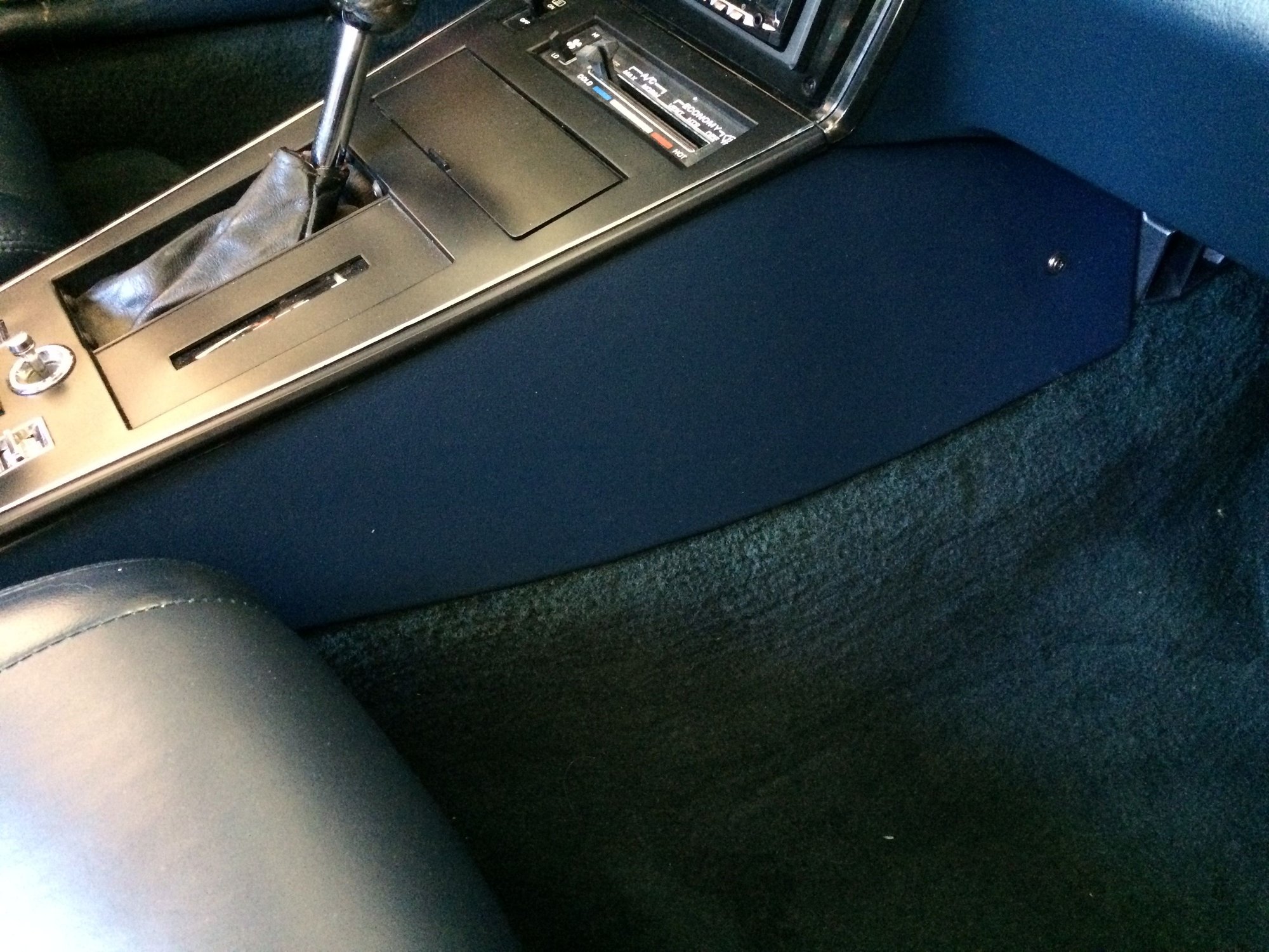

Just purchased an 82 in great condition. Trying to get it back to stock condition and I have a question about the console side panels. On my car they are very nice looking plastic panels with the same quality and texture as the dash panels. All other 82s I have seen have matching carpet panels. Is this some option for 82? Or just a well done mod?
Tried to insert pic......

It's a well done mod.
77's had vinyl covered console side panels, 78-82 all had carpeted side panels.

Someone put blue 77 panels in your car. They don't look that bad but you could buy just the carpet and cover them.. or if you purchase a new carpet set the carpet section for the console is included.

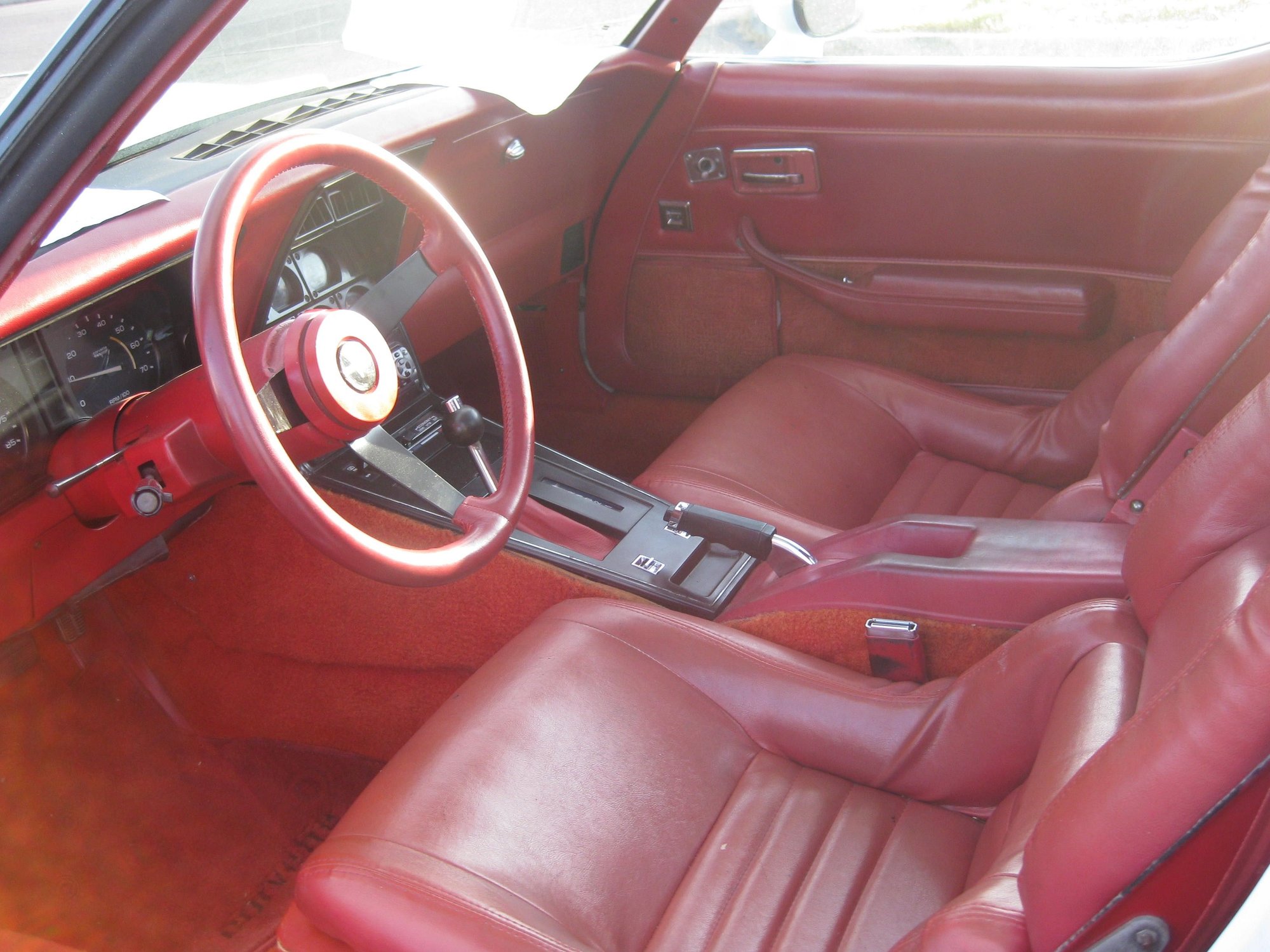

here's a picture of my issue, if you look the top edge is exposed and where the panel kicks at the junction of the shifter plate and rubber console is poorly fitted..this was my old car, my new one is much better
the problem is the shifter plate and the rubber console have a very small lip on their outer edge. the lip is what covers the side panel top edge. the lip is so small that any shifting, by even an 1/8th of an inch will expose the cheap *** cardboard. GM should have made the lip with a larger overhang and this would be a non-issue. It amazes me that something like this passed through testing, design, and common sense, and was OK'ed by GM...Your idea about keeping the leather panels but carpeting them is a good one, but I would leave an 1/8th" of the leather exposed at the top, and that would be the part that slides under the lip..I see a lot of test trimming, fitting, in your future but with the leather part at the very top, the cardboard won't be exposed

Just removed the console side panels. They are definitely covered with leather. And Well done! The Excellent shape will make it very scary to cover with carpet....having second thoughts.
