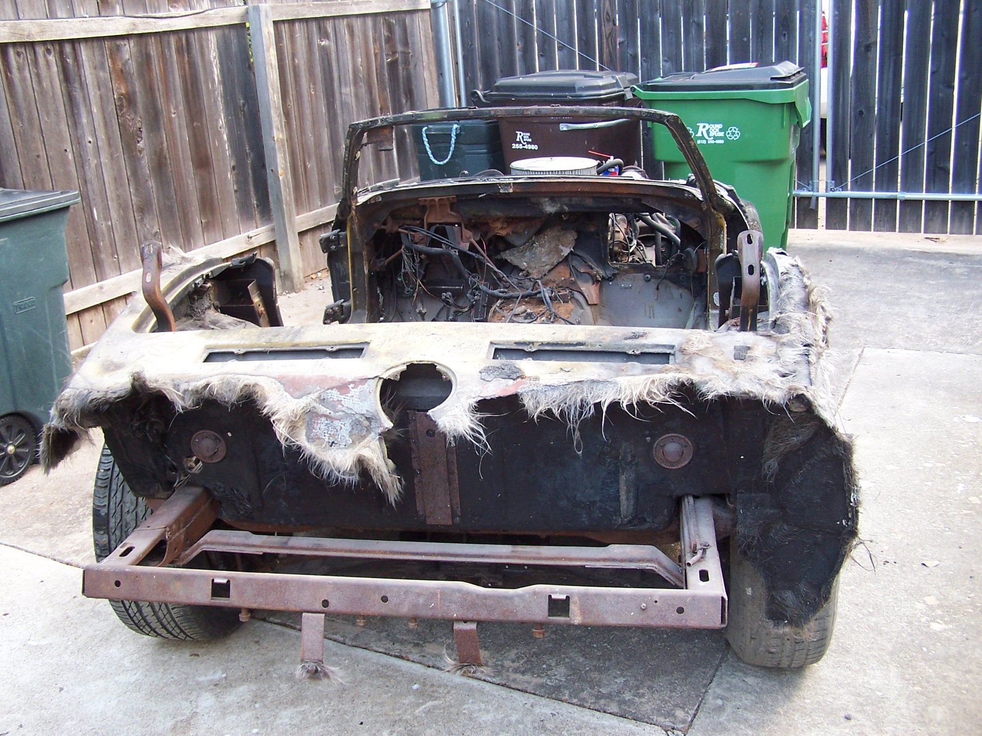

define from scratch, I had to replace every fiberglass panel except the floor board and firewall, to restore this car, I wanted original panels so I simply bought the used panels I needed, separated everything at the seams and replaced with original panels no Reproduction. appears as it left the factory.
Before,
After...
Old May 26, 2017 | 08:22 PM

Did someone use that 69 convertible for target practice? That is a remarkable job!!! Lou.
