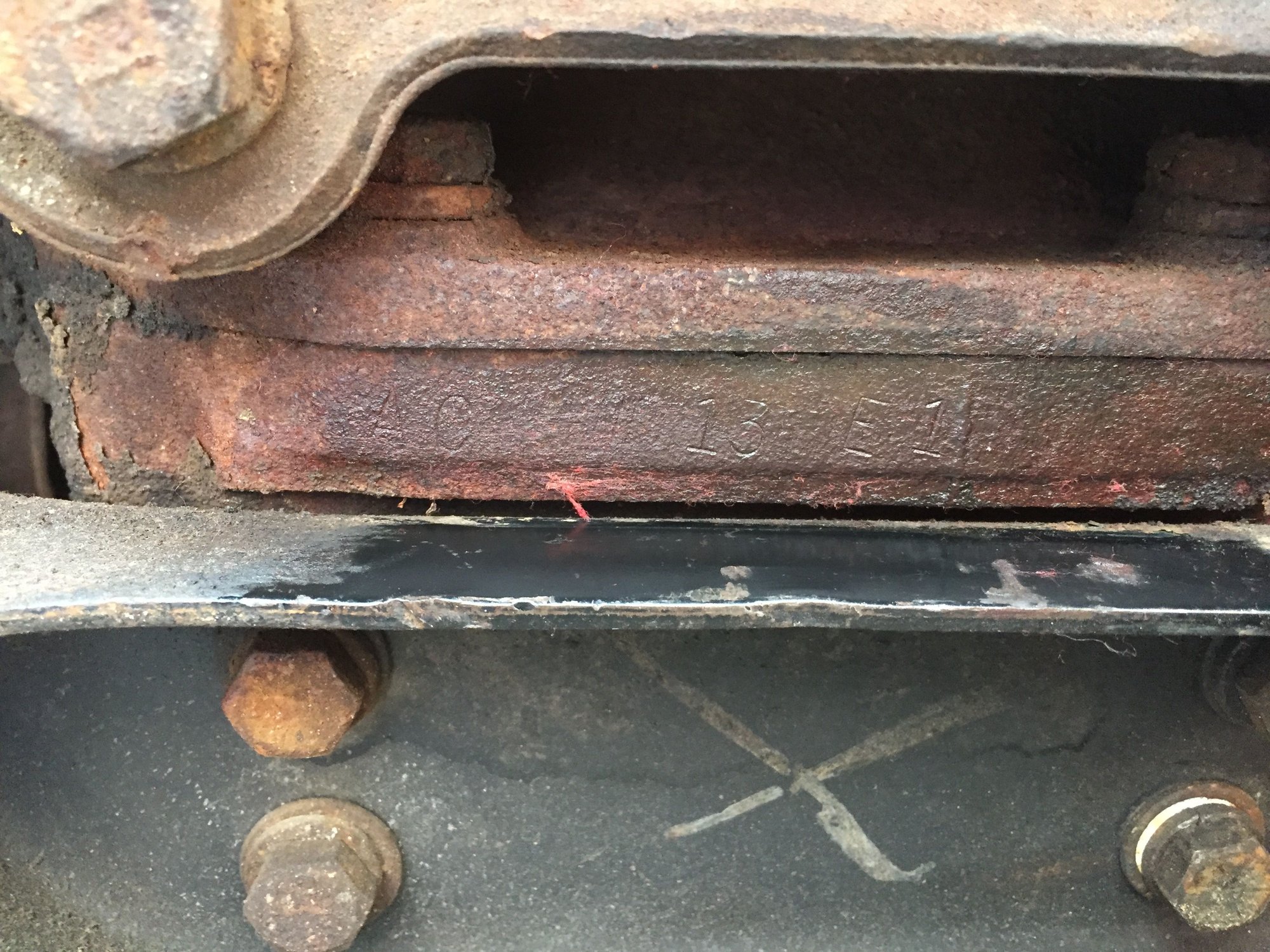

AC 13 E1
AC=4.11
13 =January 13
E1 = Eaton 1st shift
Is that correct?
My car is a 1972. Door trim tag is first week if February

I could not read it until we rubbed oil on it
Everything under the car was still stock. We changed out all of the u joints. Complete front end rebuild is in the fall. The car still had oem shocks on the front...well what was left of them.

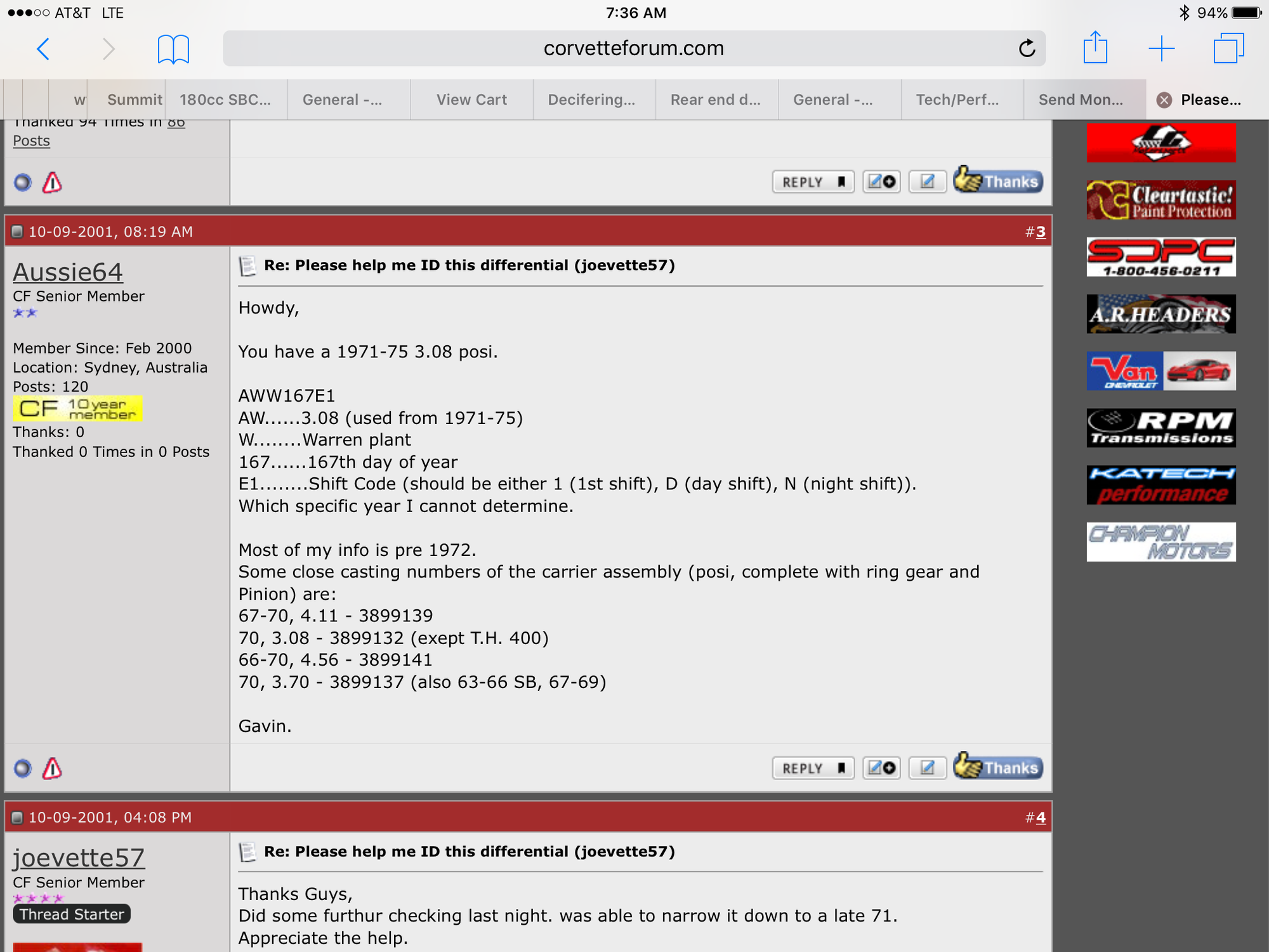

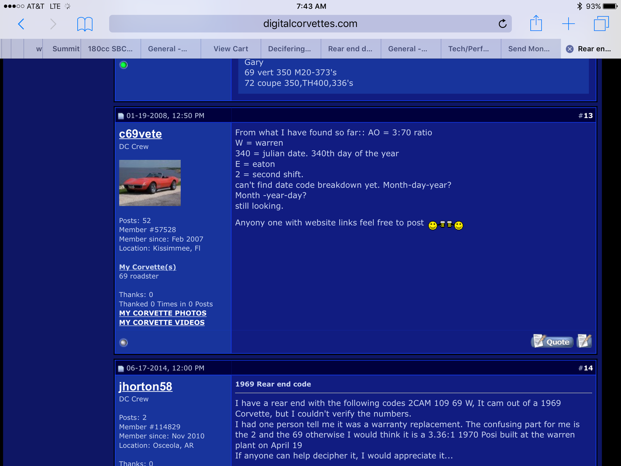

So this is what i was able to find. For someone searching in the future.
