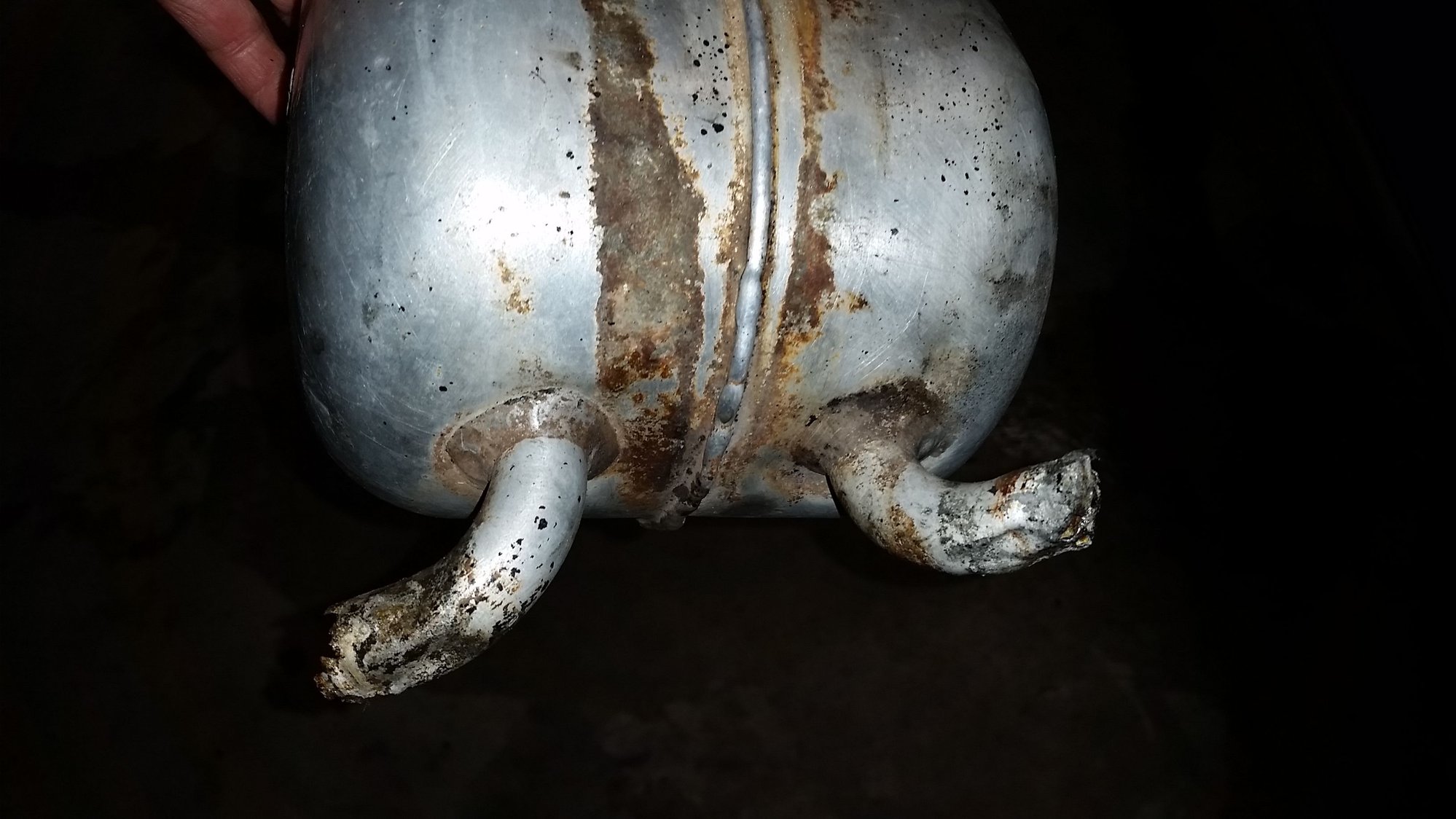

Is there any chance to repair an original Harrison tank?
I pulled the lower hoses off to try to diagnose a leak and noticed the ends of the pipes were pretty corroded and deformed.
I'd like to see if i can first trim back the ragged edges and reform the round ends, but not sure if there'd be enough tube remaining to clamp to.
Otherwise, are there shops that can weld new tubes in aluminum?
I'd really like to preserve the original tank if at all possible.

While I can understand your desire to retain your original tank, I think the repair will be difficult and costly….even after finding some with the skill and equipment to do it
I'd think the likely source for tubes would be another tank that has good tubes that can be transplanted by the person who does the repair.
You might be able to slide the hoses further up on the tubes but you still chance crushing the pipes at that point when you tighten the clamps.
Also the tank itself may have deteriorated too much for the repair to be made.
Perhaps you could begin to look at e-bay for a used original with a date that works for your car that's in better condition.
I'd think you could by a used tank for less money than the repair of your tank would be.

Thanks Alan,
Well I'm giving it a go.
Bought some new hoses (3 of the 4 that come out of the tank - just not the overflow drain hose).
Did my best to remove the "shards" of mangled Al from the 2 lower tube ends.
And then formed them back to round as best I could.
Fed the new hoses over the tubes as far as they would go, and then gingerly clamped new hose clamps up as high on the tubes as possible.
So far, after getting it up to temp at idle in the garage, no leaks!
I'll take it out for a ride shortly, but this car doesn't seem to run hot ever (new radiator from prior owner).
One concern I have, was that the old hose going from the tank to the heater core was a 3/4" ID but was a much thicker wall than what was on the front line (from the tank to the water pump). Not sure if a much stronger hose is required for that rear line, but for now, I used the same thinner walled 3/4' hose on both.
Any reason to think I need a stronger hose for the tank-to-core line?

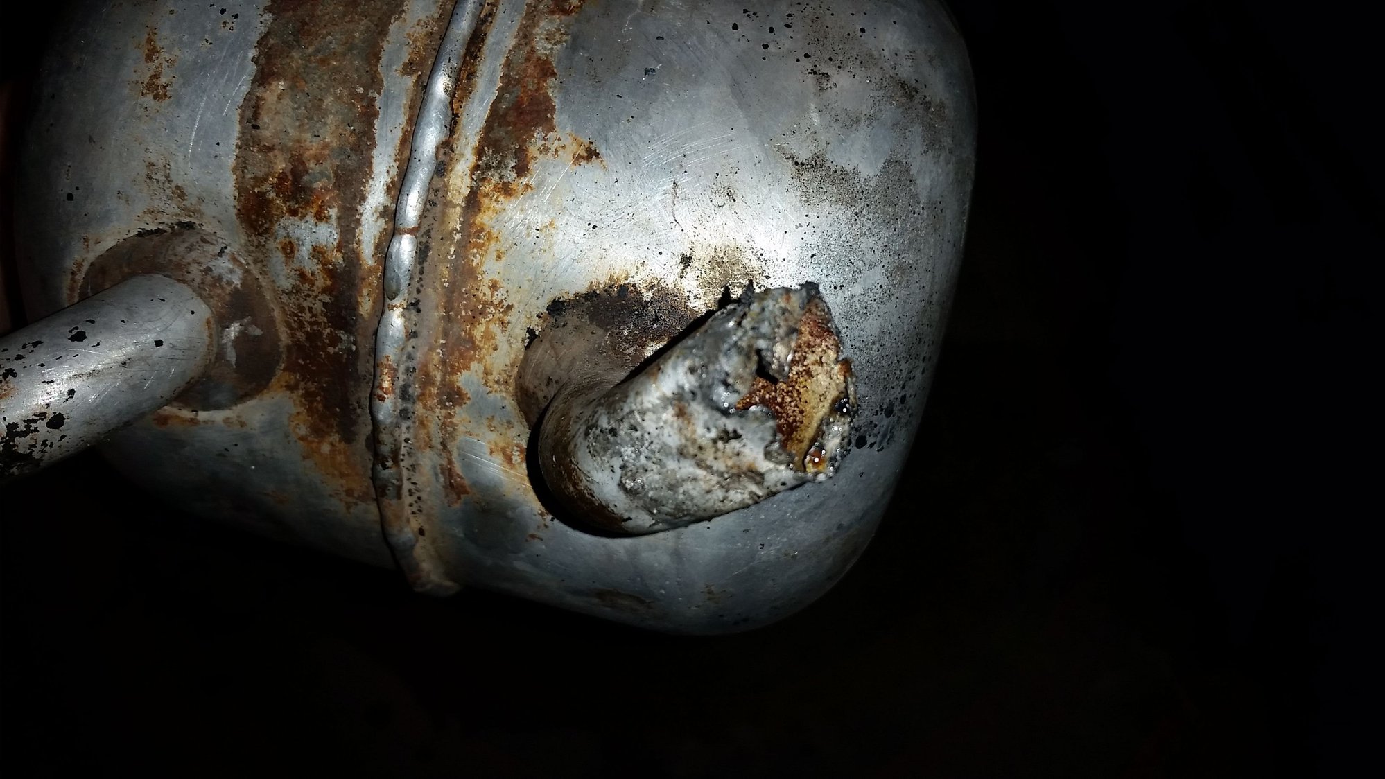

I'd think both hoses would have the thicker wall.
I think you need to be watchful because the missing ribs were there to help the clamp hold the hose in place in case of an overheating/over pressure situation.
You may be fine. But I'd be nervous enough about a hose slipping off that I'd spring for another tank.

Yes ..these tubes can be formed and the bubble ends can be put into them and they can be welded back onto your expansion tank...BUT...it might cost more than buying a new one.

My thought is that the condition of those 2 tube ends was already pretty degraded, and no rib or bubble end existed for X number of years.
How high does the pressure get at those fittings? Isn't there a over-pressure protection in the tank cap already?
And what about the hoses themselves? The 2 lowers were both 3/4" ID, but the rear line to the heater core was a larger OD, so it had a thicker wall.
The standard replacement coil of 3/4" ID hose I bought did match the front line (to the water pump), and they both fit well.
Can anyone provide the original specs of those hoses, and know whether a thicker hose is required for the rear line (or both)?

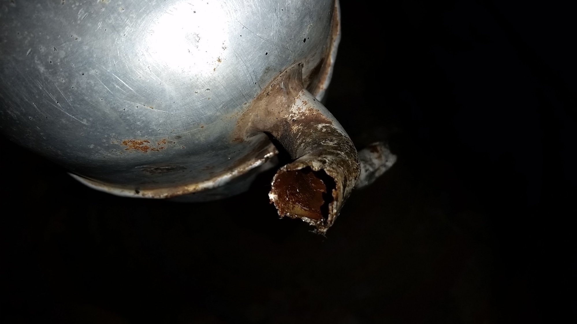

Professionally speaking:
I would not run the car without those tubes being correct. Taking the chance that these hoses come off is not worth it...but remember I service Corvettes so I have to worry about a warranty/ guarantee.
Either get it repaired if you have access to friends who can help you in this that can keep the cost down.... or.... get a new one.
Alan is correct on why you have two different wall thicknesses of hose. Someone changed them out with what they had.

New replacement tubes are available for the tank.
Not sure if I am allowed to name the company.
It starts with your cars name and ends with the continent it was made on.
If you are concerned about originality those tubes were gas welded not tig welded.
Not a lot of people left who can gas weld aluminum.
