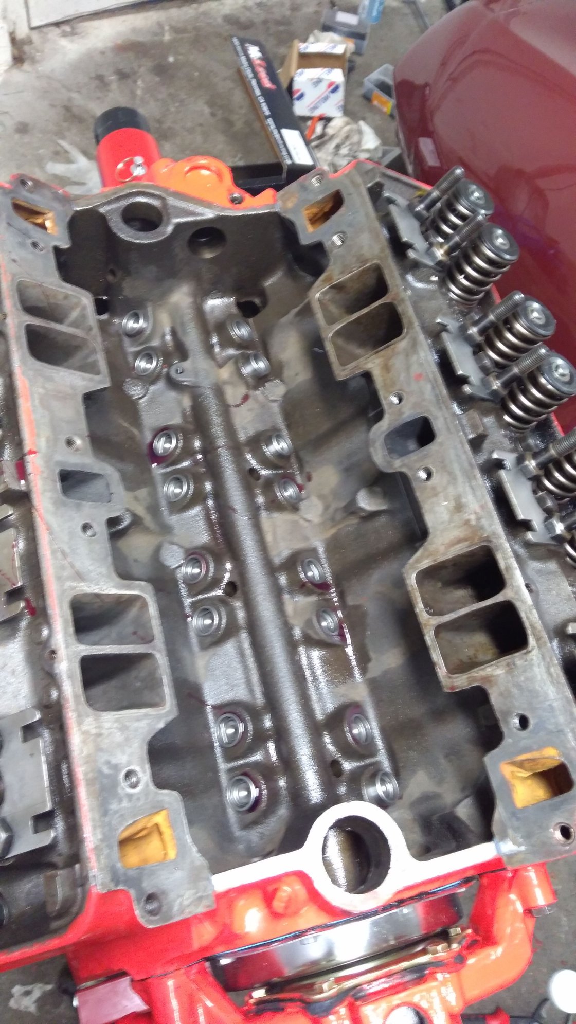

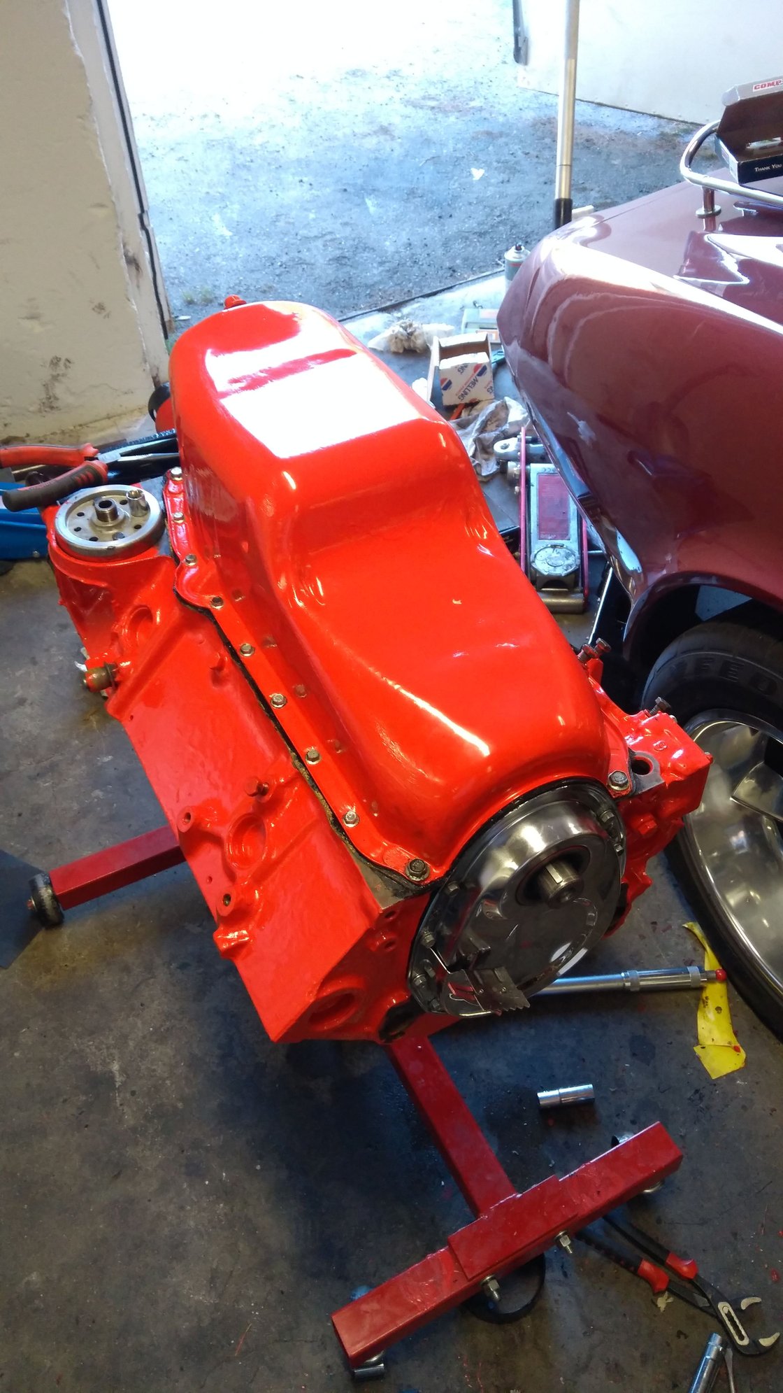

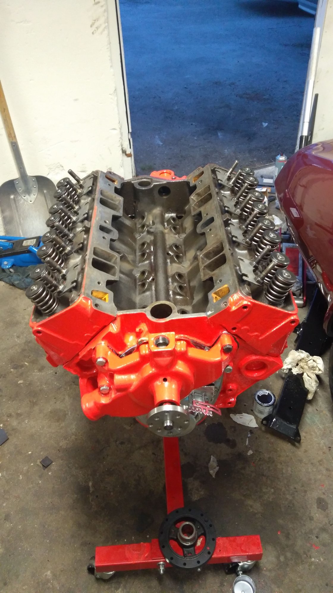

Comp cams gears and chain
New oilpump
Got the oilpan on again
Heads are being torqued
Looking good
New lifters going in
Roller rockers and pushrods
Gonna look nice in the car

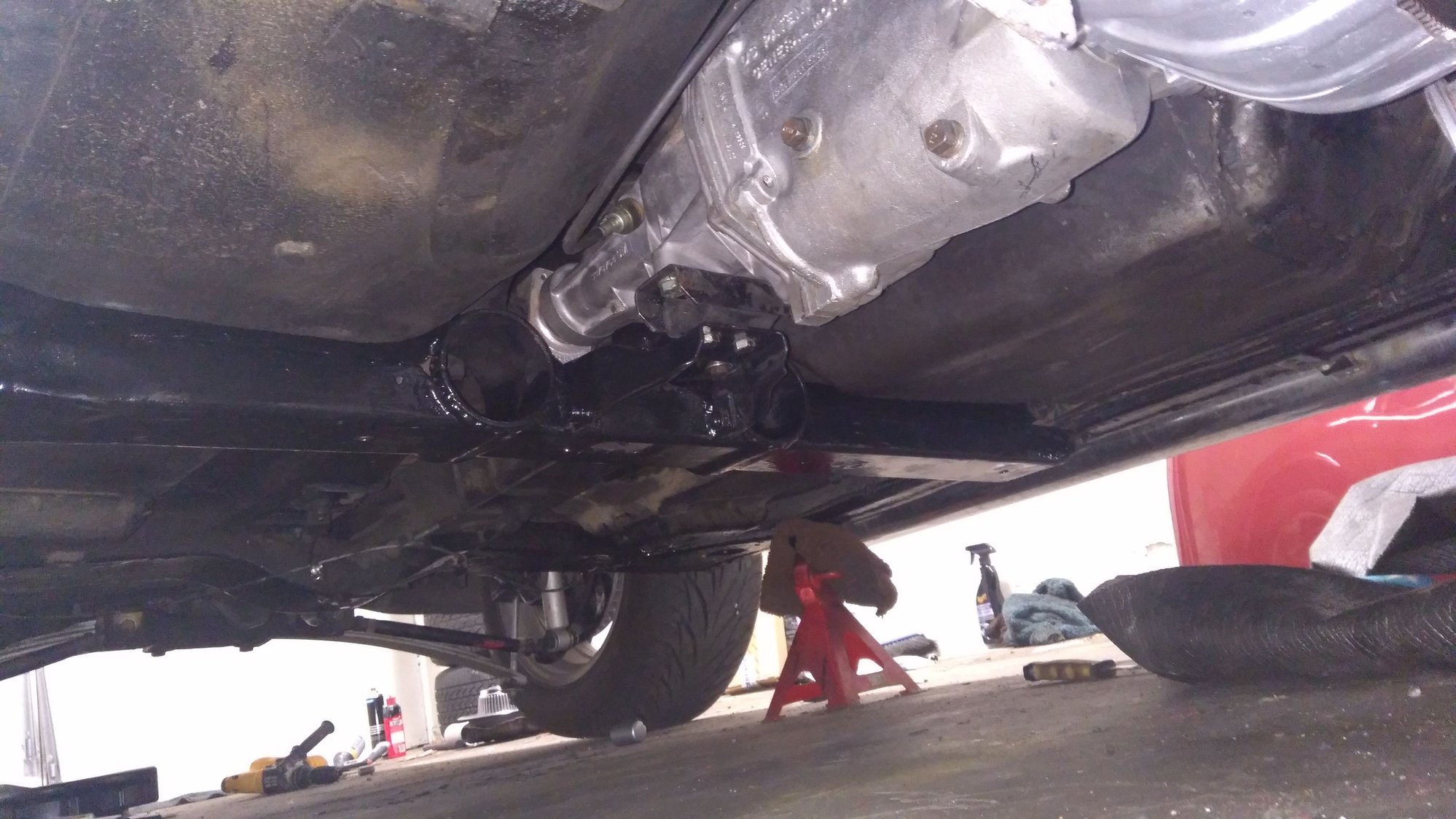

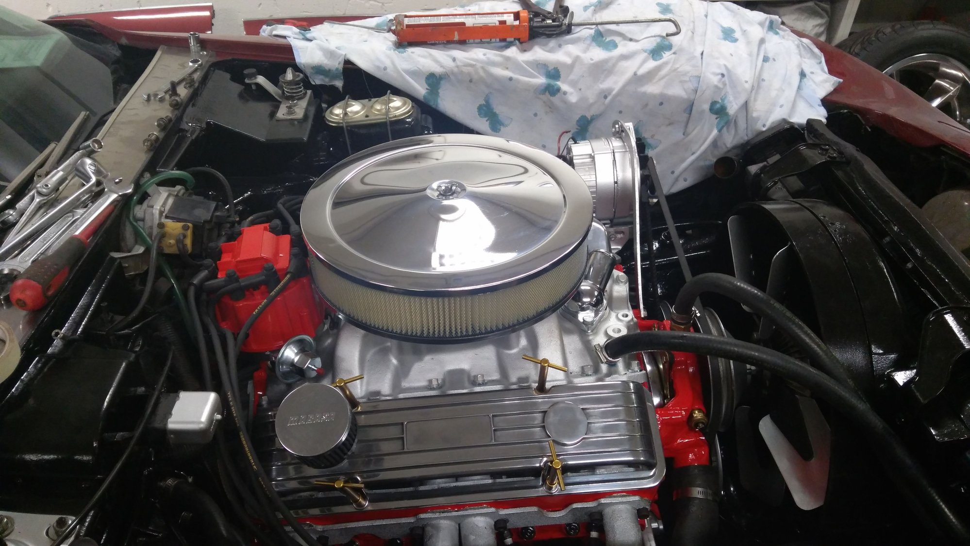

Started to get the engine back in the car
New clutch
And it's in, feels great
Old Jul 18, 2017 | 06:46 PM
stingraymaniac's Avatar
stingraymaniac
Joined: Jun 2003
Posts: 5,135
Likes: 71
From: Umeå Sweden
Gearbox going up
Done fits great<br/>

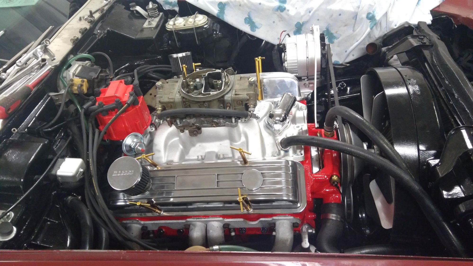

Intake mounted
Carb and distributor mounted<br/>
Looking good<br/>
Looks almost done <br/>

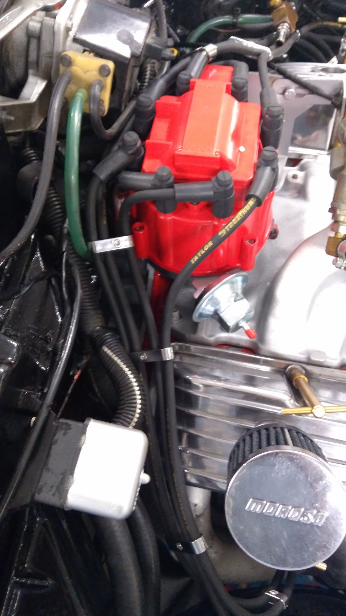

Everything connected but the radiator, gonna flush it a couple of times to get it cleaned
Bought some nice holders for the ignition wires
Old Jul 19, 2017 | 06:07 PM
TimAT's Avatar
TimAT
Joined: Oct 2006
Posts: 7,123
Likes: 433
From: Gladstone MO
If I may suggest-- Get some 3/8 steel line and make new fuel lines. One leak in the rubber and all of your hard work could go up in smoke. You would be amazed how fast!!
The heater hose you directed into the top of the water pump could also go into the side just above the lower radiator hose. Might make a cleaner looking install.
Looks really good. And almost done too. Get it on the road and enjoy!!

Yeah I know about the fuel lines, always had rubber but maybe should change them to steel
I have my temp sender in the other hole, maybe could switch them and get a better look, thanks!
