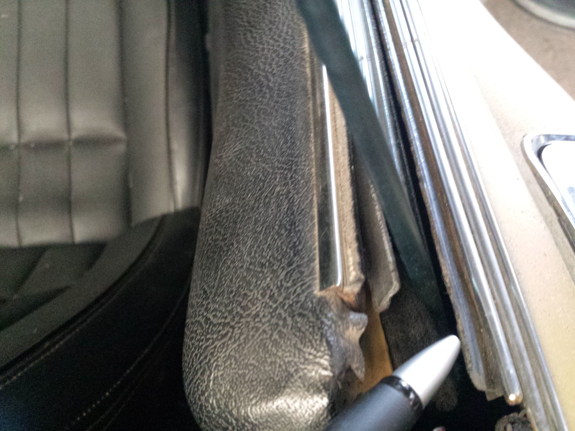

Sorry for my bad English :- (
By "inside" I means this seal.
It is like the "outside" that has a "small" V and the "inside" is a "big" V
Both are due for replacement, the are very hard, and have cracks.

Hi John,
Your English is fine.
I'm not sure that the "inner seal strip" is available separately from the door trim panel.
Regards,
Alan
