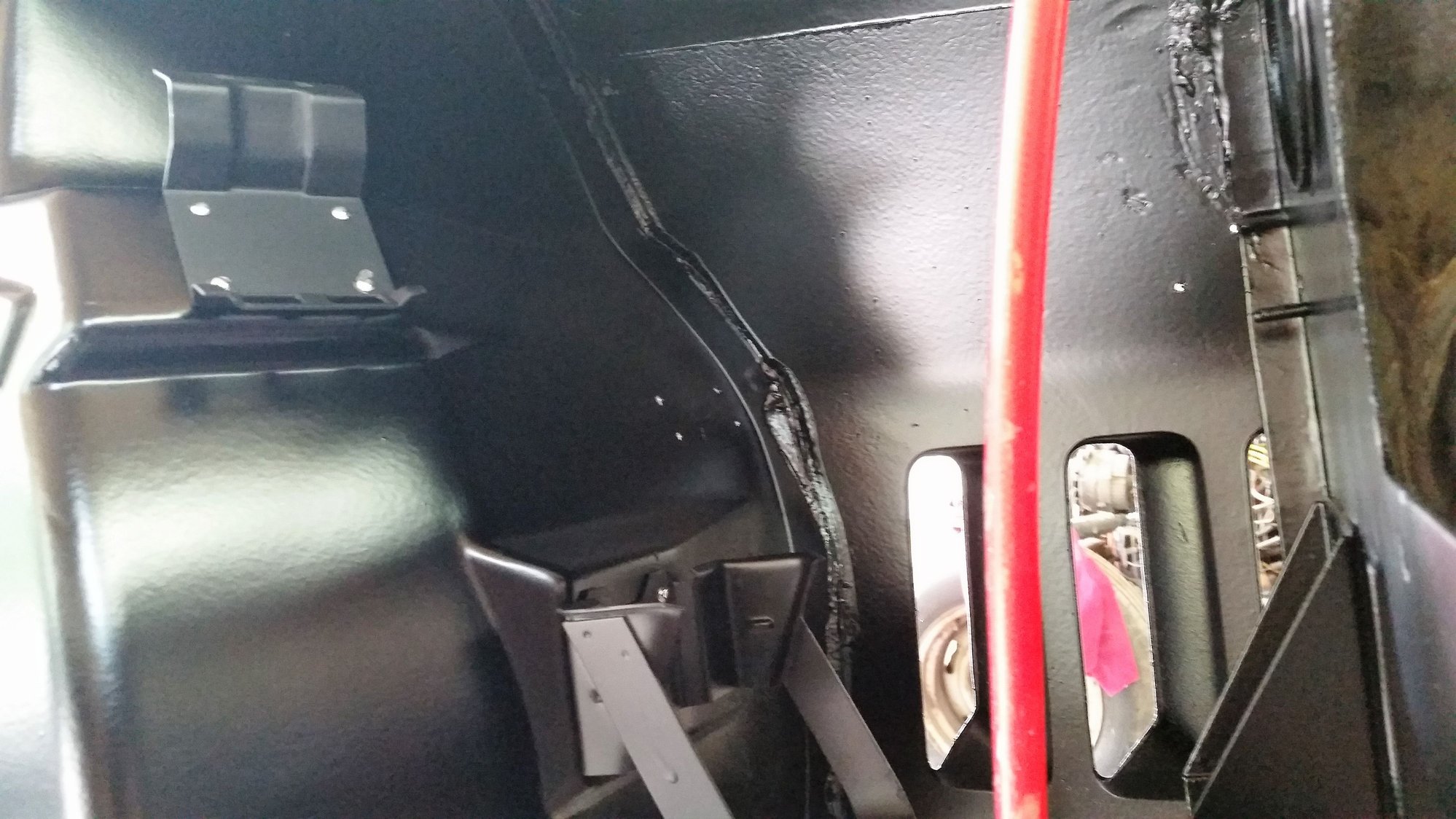

Many of us also use Hot Rod Black Matte finish. You can get it at almost any autobody supply place. You can clean the firewall with thinner or acetone. A nice coat of primer and then the black come out really nice. Check it out.
RVZIO
You get the idea.

Interesting....bought it last week to do our steel front door (practice). The finish on your car is exactly what I'm looking for...
