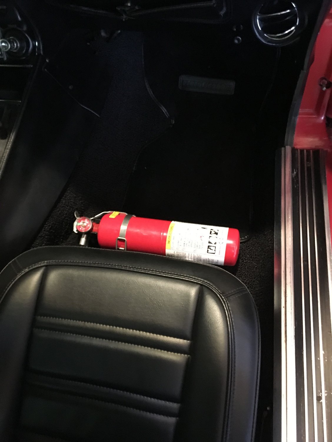

ok I put a fire extinguisher in my 72 ,my question is the gauge shows it is charged up but it is about 6yrs. old how long does these last ,before they go bad???

I've never had one "go bad" but the only way to really know is to try it then of course it's done.
If it's a powder type extinguisher the powder gets packed tight after a while and it may be a good idea to tap the side with a rubber mallet while tilting it in a different orientation to loosen up the powder.

Read the placard on the side of the bottle; all DOT fire extinguishers have inspection information on them, including how to inspect it, a weight range that proves the bottle is full, and of course the gage. As long as you are in the weight range, and the indicator is in the green, its charged and ready for use. These bottles do have requirements at six years, and 12 years, but not sure any of us would worry about those. In the airplane business, we have to abide by them.

If it's a 'dry powder' extinguisher, it should be good as long as it is adequately charged. You might want to shake it once in a while to make sure the powder hasn't 'clumped'.

That powder packs just sitting. Riding in a car in a holder it's pretty much guaranteed it's gonna pack.

No, but they are no longer being sold. The replacement is FE-36. Ansul CleanGuard in 2.5 lb bottle with vehicle mounting bracket will run you $200. I used to carry a powder extinguisher until I realized how much damage they would do to a restored engine compartment.

We are required to replace (or have recertified) our fire extinguishers every 3 years for most competitive events in Australia. Having said that, they normally then get put aside for use in the garage if necessary. I've seen 10+ year old ones fire fine.
