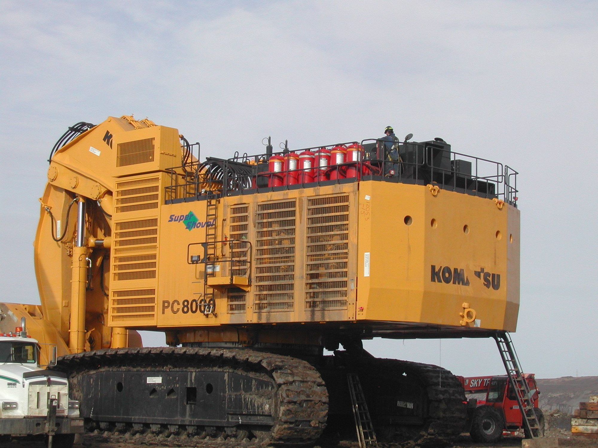

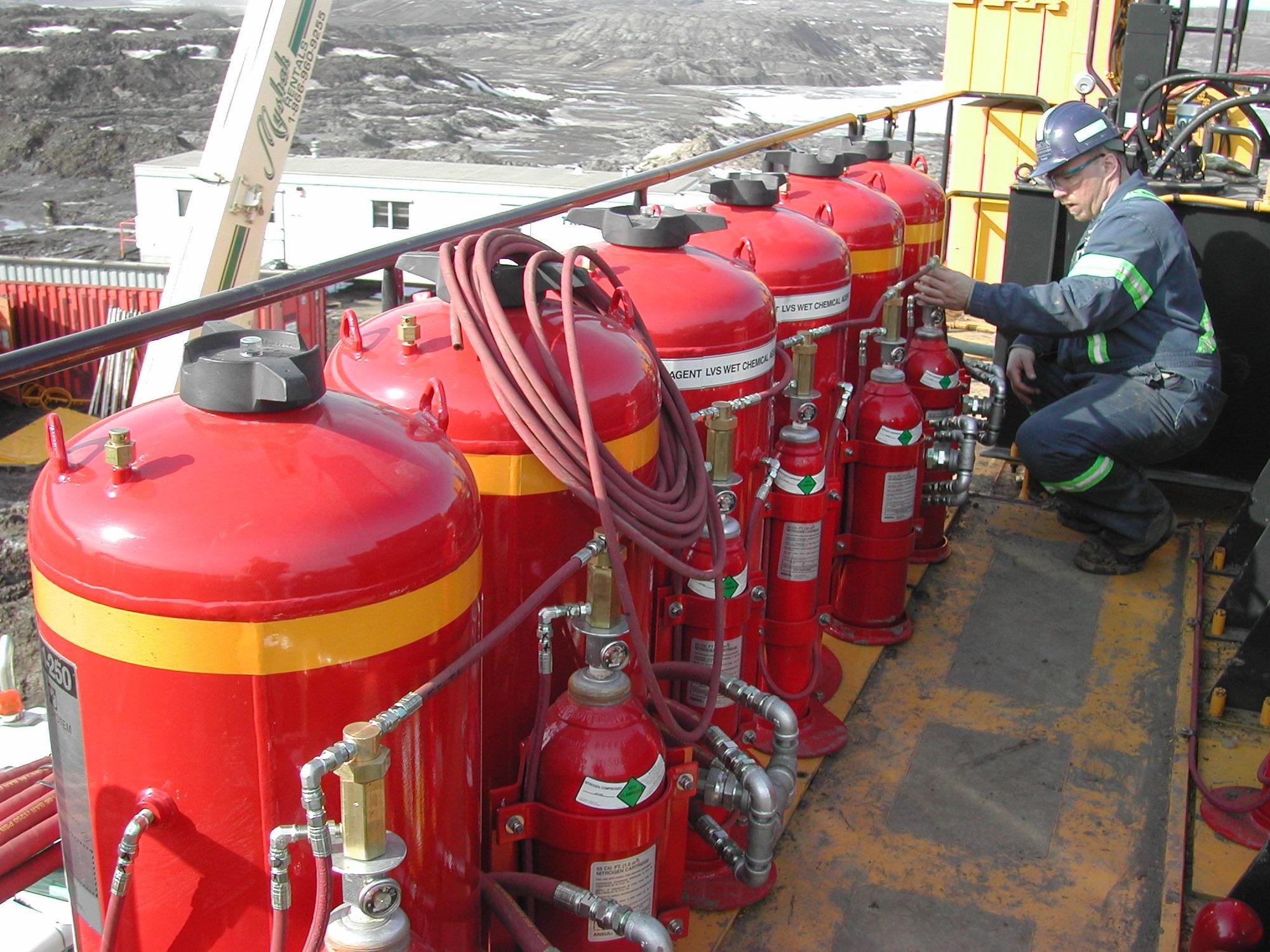

This is me when I worked in the field. These are essentially fire extinguishers of the pre-engineered kind. 1000lbs of Foray dry chem ABC and 90 Gallons of Liquid/AFFF foam.
The best way to handle a fire in the automotive/heavy equipment world is a dry chem application ABC. Typically you'd only use the AB portion of the classification of a fire in this case. Also I would possibly use a Purple K dry chem from Ansul (One of our companies) which is B rated and 50% percent more effective than an ABC Extinguisher.
I wouldn't use a clean agent such as Sapphire, FM200, FE-36, Inergen, Novec etc.
Clean agent is used in data centers, libraries etc.
OP, your extinguisher is technically usable if it's in the Green area on the gauge. You have a stored pressure extinguisher. In the industry there are 6 year inspections that require a company like us (TYCO, SimplexGrinnell) to go through the extinguisher on a bench IE: Dismantle it. For the cost of that service, run to your local store and buy a replacement unit IMO.

THAT puts the bottle extinguisher under the hood of a NASCAR machine to shame!!!

Now that's a big block!!
