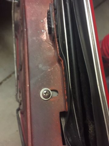

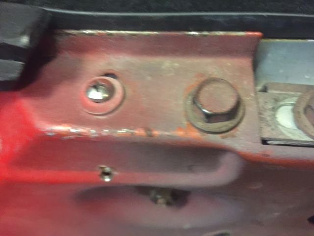

In my efforts to reduce the amount of gap between the top edge of the door panel and the window weatherstrip, I noticed some peculiarities in how the weather strip is fastened to the door. From what I can determine by looking at photos online, I think my weatherstrip may not be fastened properly. There are screws that attach the felt(whiskers) to the metal support that are pushing the support away from the door frame. Plus, it appears that the inner felt/weatherstrip is much lower than the out felt/weatherstrip.
I am attaching a slew of photos that may present the situation and maybe someone can tell me if it looks like the weatherstrip is installed properly or not.
Shot from the rear of the door
From the middle of the door
Front of the door. Notice how much higher it is than the rear
Here a screw in inserted from within the door (window side) that is pushing the metal support away from the door frame

Is yours a 68? Almost everything I read notes that 68 had a different weatherstrip and seals. I believe later years, 70 and beyond, had the inner weatherstrip and seals attached to the door panel itself.

I was able to finally adjust my inner weatherstrip high enough to clear to tabs on the door frame so that the rubber would lay more flat and touches the door panel. These are aftermarket weatherstrip and whiskers I found the metal trim that holds the rubber swipe and cat whiskers could be adjusted and raised to a height that rested above the tabs on the door and touched the top of the lowered window to keep everything in place.
Installing the door panels was just time consuming trial and error. I am sure Chevy had some little jig that would hold the panel in place and align the screws to catch the u-clips. I ended up using a strap clamp to hold the panel to the door while I searched for the screw placement.
